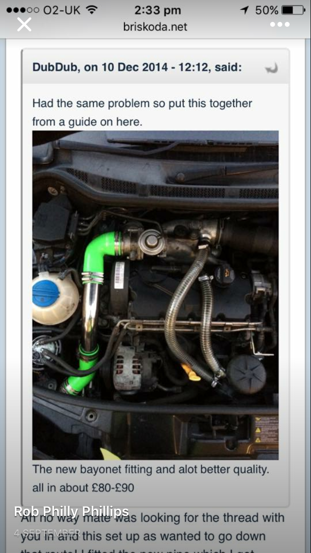

This is what I did
This is what I did you never have to worry about them again then
Cheers Phil, yeah I've seen the same and also priced up the parts. I think I'm going to possibly do this for the top pipe.
How long ago did you do this - do you have the links available still for the parts you bought?
Thanks!
With the 45 degree reducer that comes off the egr go for 80mm so it goes over the top of it and use to good jubilee clips
So 80mm to 51
90 bend sorry not 45
