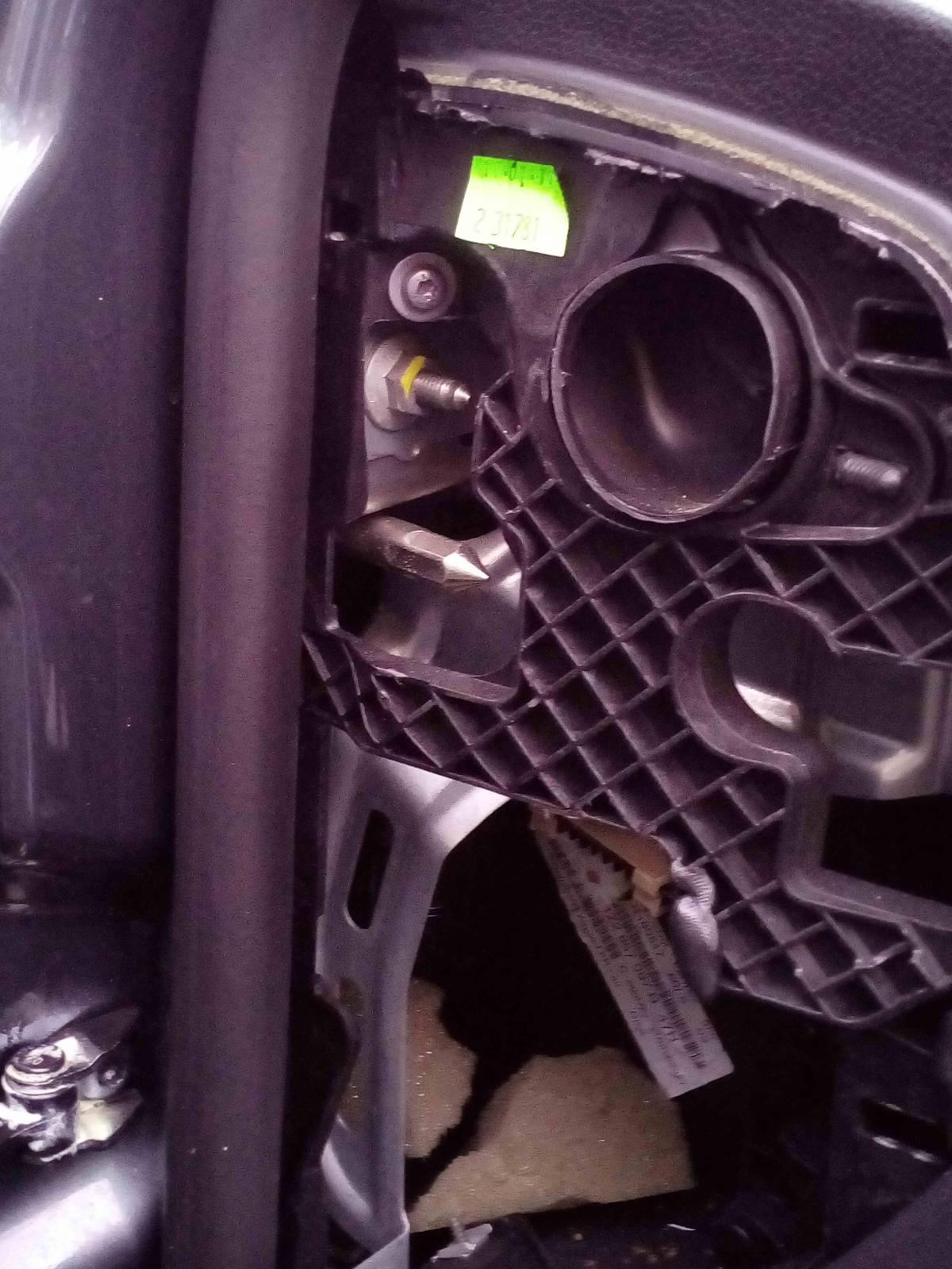

I am planning an install of an under floor sub (Kenwood KSC-SW11) in my Mk2 Vrs. It won't fit well under the drivers seat but it fits under the passenger seat like it was made for it.
Now the supplied ground wire is fairly short so i am looking for a suitable ground point on the passenger side. i have taken off the side panel between the door and dash board passenger side.
Would the bolt shown in the attached image (the one with the yellow paint) serve as a suitable ground)?

Yes it will - I have used this very point myself on 3 different Octavias now.
Mike
Mike - thanks for the confirmation puts my mind at ease know this has been used before - much appreciated.
That'll make your ride popular with the ladies ;-)
No paint so should be fine. You can test it by using a multimeter.
Pos on battery pos and neg on battery neg, change it to that bolt and see if there is a difference. If there isnt one then all is good
