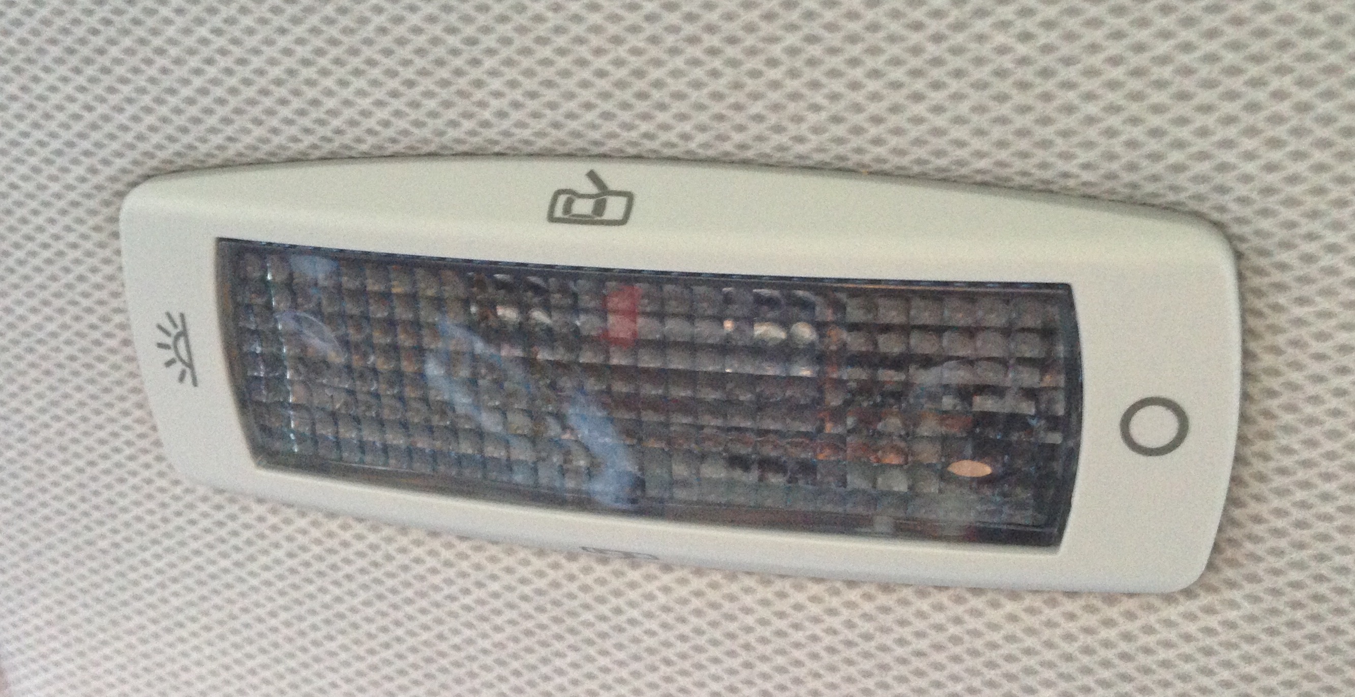

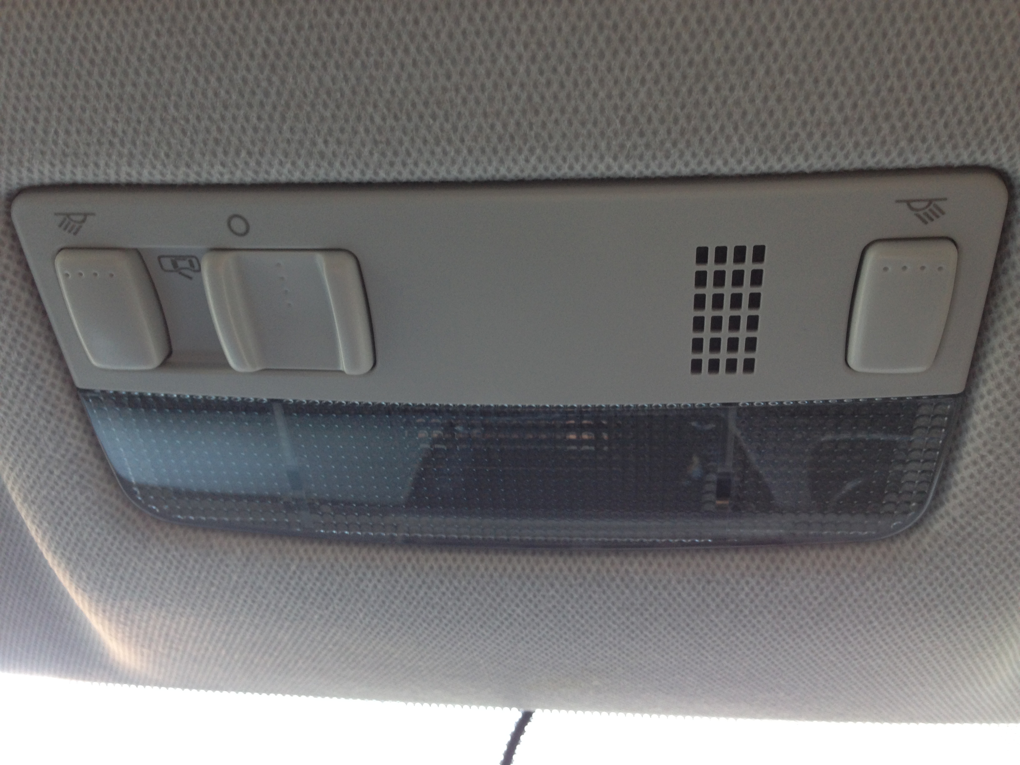

Had a look in the car and see there are three lights at the front of the car in the headlining above the front windscreen.
Then the two rear passengers have these above the windows.
Do all those bulbs you've kindly listed cover these ones?
Your first photo takes the 41mm Festoon in the centre and the two W5W (ebay id 370834202219) either side.
The second photo in the headliner at both sides take the smaller 37mm Festoon bulbs.

I've ordered the following, which covers all the bulbs and gives a spare one for the front centre (middle roof cover).
Courtesy lights roof cover (left/right)
2 x W5W (LEDs all round)
http://www.ebay.co.uk/itm/2-x-ERROR-FREE-CANBUS-W5W-T10-501-LED-SIDE-LIGHT-BULB-5-SMD-HID-WHITE-/370834202219
Courtesy lights roof cover (middle)
1 x 41mm festoon (LEDs one side)
http://m.ebay.co.uk/itm?itemId=331639528941
Glovebox and Boot
2 x W5W (LEDs one side)
http://www.ebay.co.uk/itm/LED-Light-Bulbs-501-W5W-T10-9SMD-1-SIDE-1210-9-SMD-White-Sidelight-SUPER-BRIGHT-/331928373554
Rear passenger dome lamps (nearside/offside)
2 x 37mm festoon (LEDs one side)
http://www.ebay.co.uk/itm/2-x-37MM-ERROR-FREE-CANBUS-LED-SMD-FESTOON-NUMBER-PLATE-INTERIOR-LIGHT-WHITE-/331897434232
