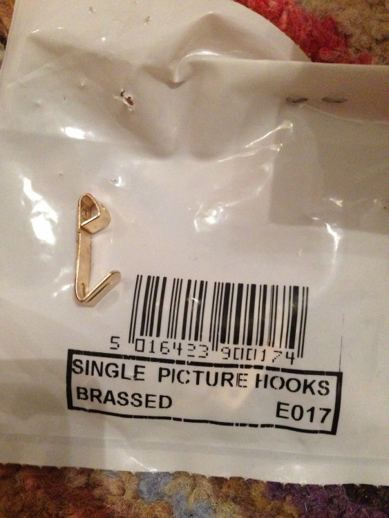

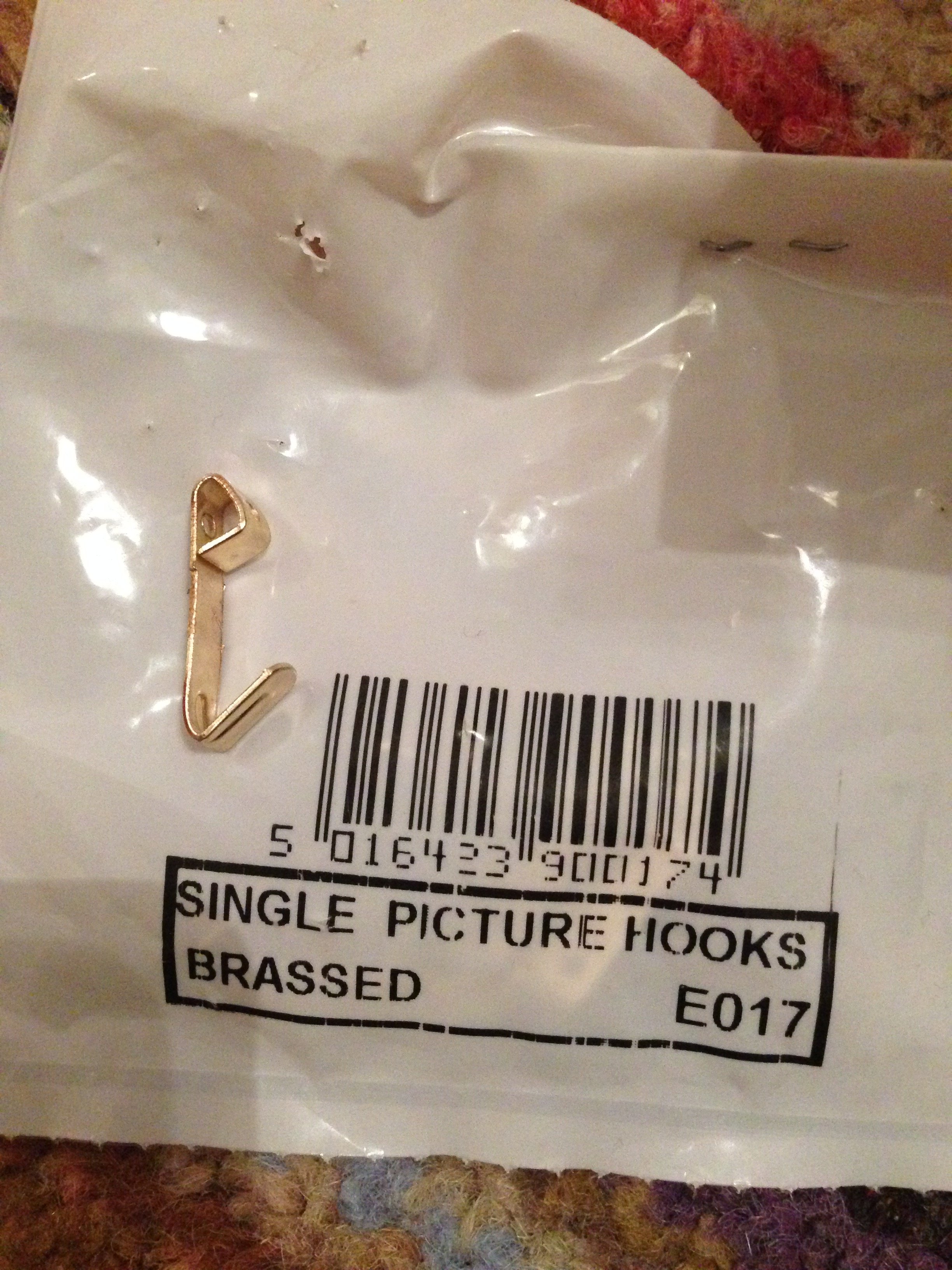

I've fixed it. Found some brass picture hanging clips that are the right width and thickness.
Squidged with pliers to rough(ish) shape and tin snipped to length. I'd prefer an original clip but it works so I'll try and forget all about it now.
It's like daylight in the car now.

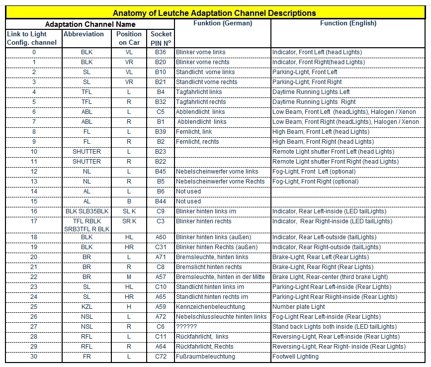

Also if the light is can bus compatible and you still get a warning and the light works, turn it 180 degrees and see if it goes away. (some led lights can still work even if it's installed the wrong way but they throw fault codes then).
If all else fails, then use VCDS preferably with the new HEX-V2 Enthusiast adapter (mutch faster scanning and finds control modules older interfaces don't recognise).
I use this attached list for finding right bulb channel. Don't remember if ill got it from here but credit to the one who posted it in the first place.
Hope you don't mind me using it in this post (good stuff).
Good luck swapping lights... :-)
