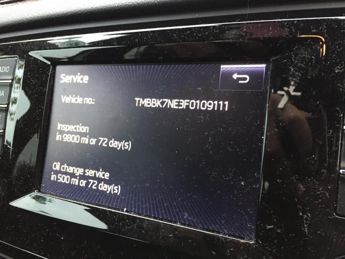

Which service?
Guys, which service do I need?
Will an inspection cover an oil service?
Or do I get oil service and then an inspection in a few months?
The Car is leased and going back in February, so the least amount of servicing costs, the better!
Originally it was on anual servicing mode, but I reset it in January or February this year so I would get another 12 months out of it.
Car is 20 months old with 16k miles covered. I think it needs an oil change quite early?
Cheers

So I guess the £269 service?

So all you will pay for is the fluid (~5L of oil).
An oïl service at 18k miles (30k km) is normal on the "Extended Service Interval" so sounds about the right distance to me.
You've done well to get to 20 months and 16,000 miles.
You only need a minor service (oil and oil filter) at £149.
The dealer will tell you that you need the more expensive major service (as you are on variable or long life servicing) but this is a rip off as your car doesn't yet need the air, fuel and pollen filter changing.

Ok will try for the £149 option.
Ok I be been quotedfor £197 oil change only with long life oil. Then the usual software updates, check over the car etc.
