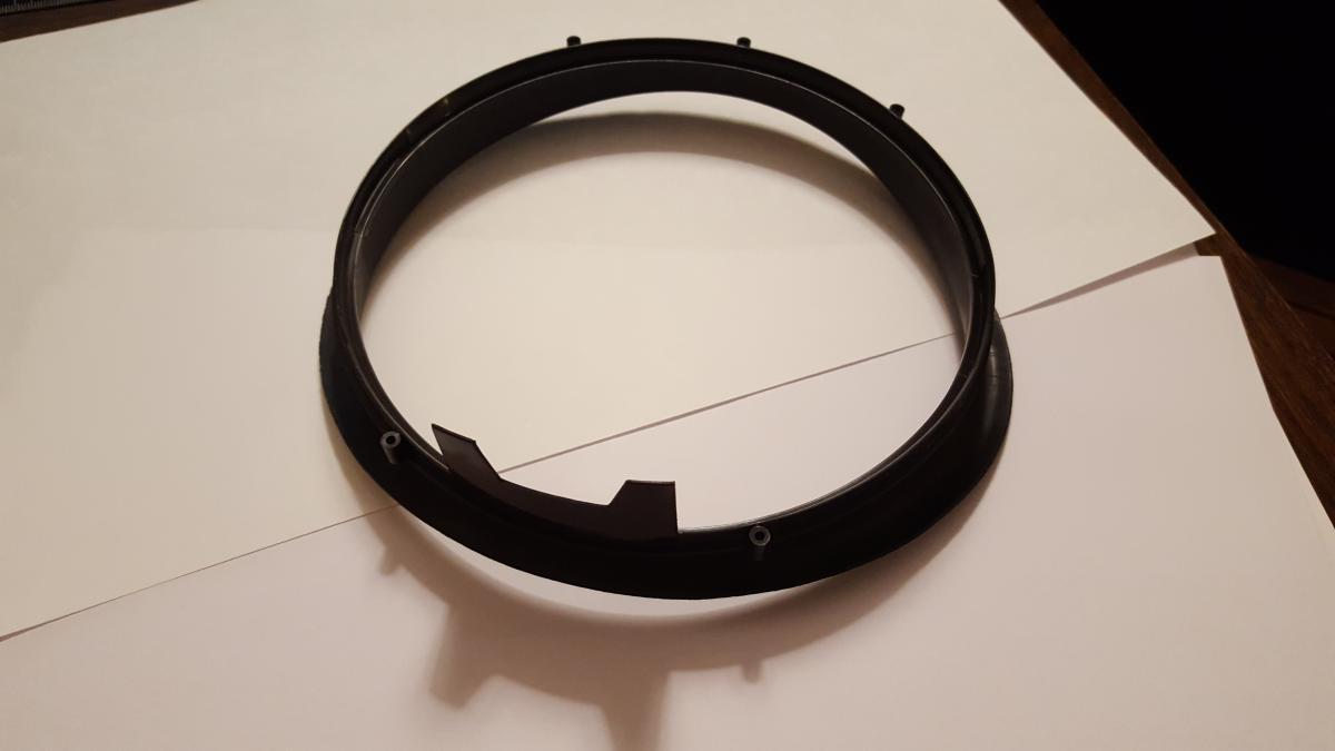

What part is this?
After having a dented passenger side sill and a dent in the front passenger door repaired I arrived home from Westover Accident Repair Centre in Poole and later found this post-23745-0-36184900-1477428245_thumb.jpg in the tailgate space.

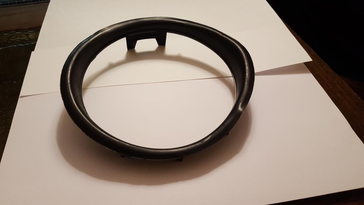

Round the edge is a Skoda badge then a gap then CZ and a gap then ZA5 then a gap
then 5E0 035 217 then a gap then >PP, SEBS< then agap then 2*.
Any idea what it is - more importantly should it be fitted or is it a part that has been replaced?
It was too late to contact Westover today and I can't tomorrow so any help will be appreciated.
I think that is the adapter/mounting ring for the loudspeaker in door.
Wow thanks for the quick reply. It looks like they've had the door card off then - I wonder if they have forgotten to replace it or fitted another one?
I can't get back to them before Thursday.
Do you think it is likely that this has been replaced and this is the old one or has it been forgotten - no rattles or anything loose sounding in the door?

The mounting ring is plastic/rubber and only affects to a speaker sound mildly.
It is very simple to install once you've taken the door card off.

Check there's sound coming out of the speaker, in case they've left that out too?...
How easy is it to take the door card off?
Car back to Westover today. Apparently speaker mounting had been overlooked when door card was replaced - all now sorted.
