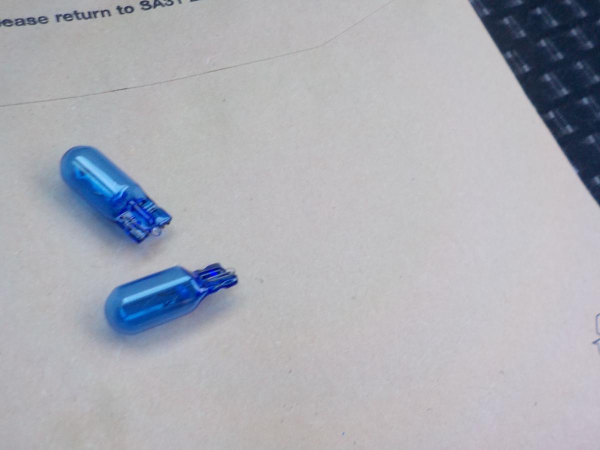

Are you saying that it could be four bulbs in total, I can only see one each side, there is a small blue coloured bulb that I can see thru the headlight.
OK.  So you will just have 1  bulb at each side.
Forget the blue bulbs, they are dummy bulbs, that do nothing.
So if there is one bulb you have a shutter system that gives Dipped, or Full Beam from 1 Bulb.  An H7 i think it is.
These are just in where Sidelight bulbs would be, but Skoda put them down using the DRL / Sidelight unit.

I did notice that the blue bulbs are wired but obviously not connected, the headlight bulb is tight to move, any tips.
