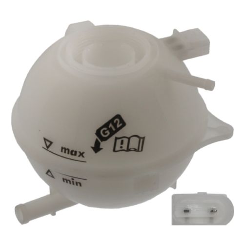

Look at this picture, top pipe removed so you dont do anything to radiatoror , he had a rubber pipe of same dimensions leading to floor , take top off and coolant tank start engine and keep topping up with neat coolant, when you have put 3 bottles in its done, turn off and replace pipe then cap , then start , this gets rid off any air at same time , hope this helps
