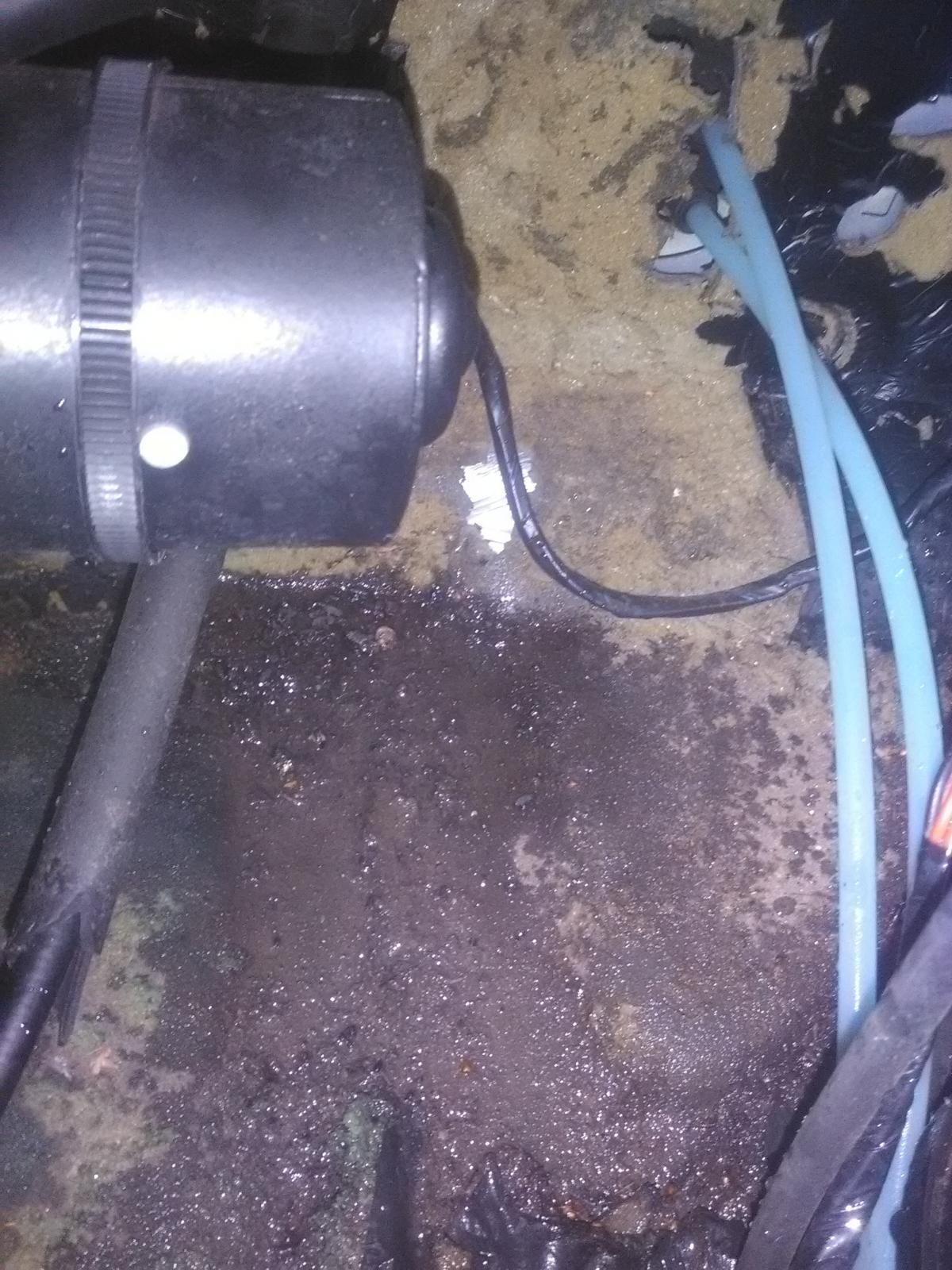

it's now 1 month ago that i drive my Felicia and today I noticed that there was water at the driver side.
Does anyone of you  already had this problem? How can I find the leak?
Interior picture is there where the water came in. But in the engine bay, its not so wet as the interior
Interior water leaks are very deceiving. The source of the leak could be a little farther of the actual dripping area given the shape of the dashboard.

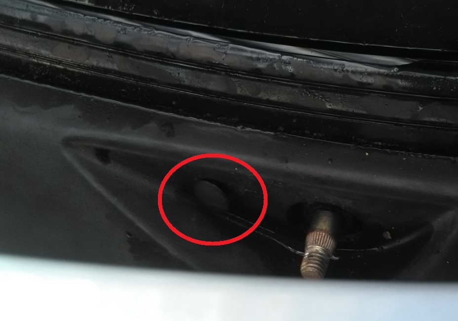

So it was to cold the last day for working outside lol that's why i give more info now.
I poured water on the windscreen and, there is no water getting into  the cabin but in the engine bay view photo.
Is it normal to have water there when its raining ? Knowing that the bonnet was closed.
No, it's not. Some drain is plugged or some seals are bad. Perhaps you should lift the cover of the plenum chamber to take a closer look.

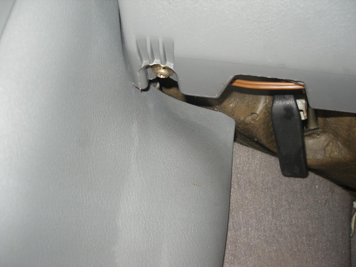

Little question, anyone knows how to unscrew this?
Those are not exactly screws, they're plastic clips. Maybe you'll be able to pull/unscrew them. I ended up cutting them then buying new ones (6U0819645).
OK thanks for the info

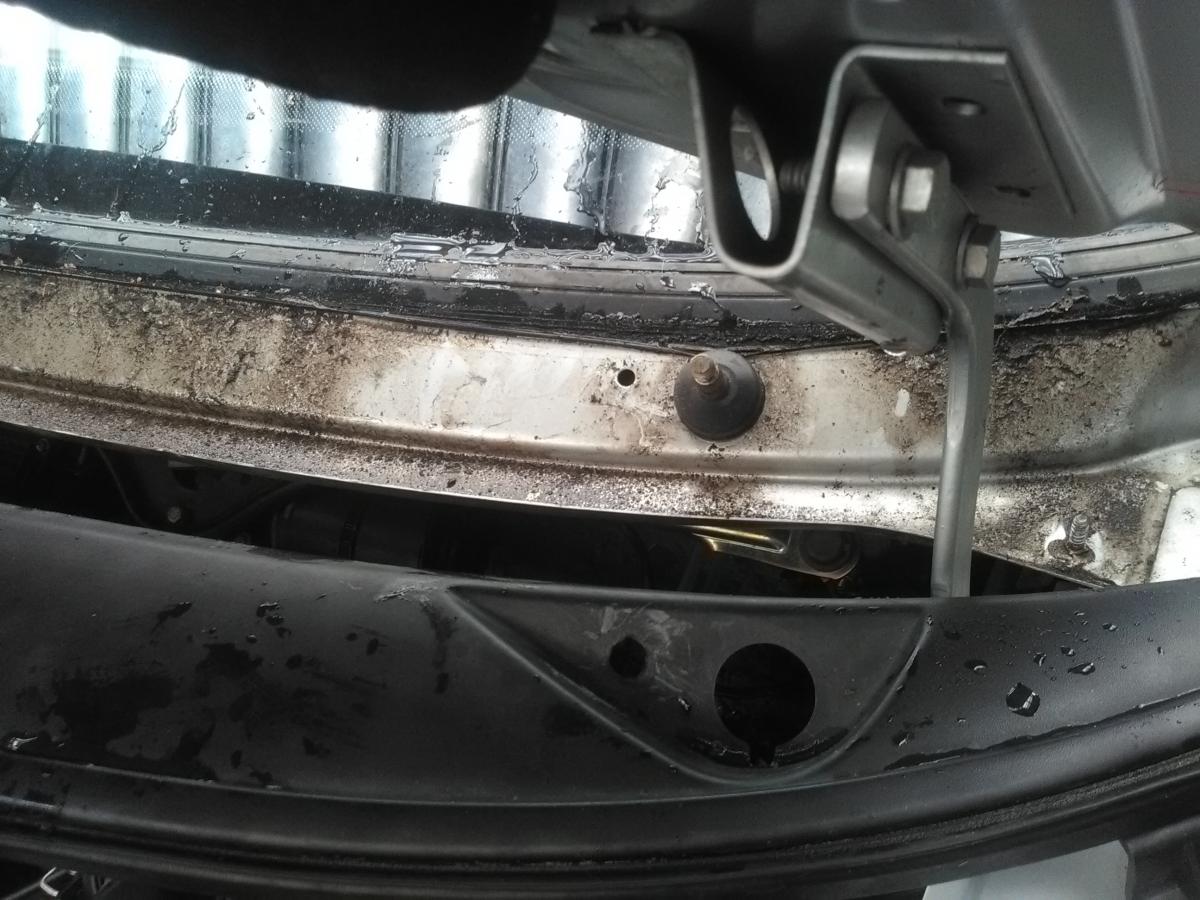

So i  lift the cover of the plenum chamber for a closer look, was quite dirty but didn't really see perforations. Does somebody have a tip for testing if the rubber of the windscreen is defect ?
nimbus
Let's look at it this way. The windscreen seal is 17 years old. The windscreen is not bonded, just pressed. Weather in the UK... we all know about it. Under the dash there's lots of foam capable of absorbing lots of water so very hard to catch leaks in real time. The water should drip from above (duh). Under the windscreen seal, at lower corners, there are drain holes. They usually rust (same if not worse in tailgate area) and perforate bigger holes. Conclusion? Remove the windscreen, buy a new original seal, clean/repair/repaint rusty areas, install windscreen. No more leaks.

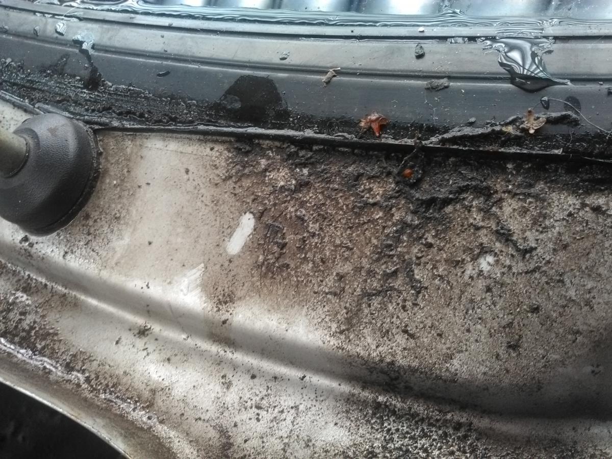

If it helps my windscreen frame looked like this under the seal. The water was leaking just above the drain hole in between the rusted panel joins
Very helpful photo. it shows what I've described previously. Any other Felicia repair/maintenance photos in your vault?
