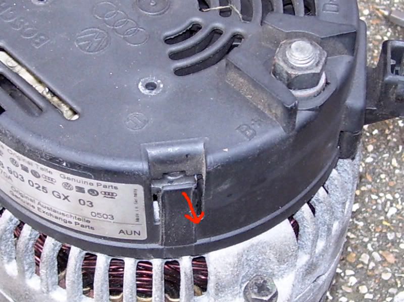

Alternator voltage Regulator - 1.6 petrol engine
alternator voltage regulator, it's fairy common for the voltage regulator to fail on a felicia, it normally causes he battery to over/under charge and some people have reported that it causes the smell of rotten eggs inside the car where is it over charging the battery. other symtoms could be head lights getting brighter when the engine is revved, or radio cuts out when revving engine. i wont go too deeply into removing the alternator from the engine as it is just 2 bolts that hold it on... the centre brushes in the regulator are spring loaded and they kind of self-adjust, it is often not these that cause a failure, it's normally a diode that breaks down inside
1.6 aee engine, remove 3 screws and carefully prize the plastic retaining clips out and remove black plastic cover
voltage regulator is held on by a further 2 philips screws
be carefull not to break off the spring loaded terminal arrowed, also it sometimes needs adjusting so that it correctly mates with the contact on the voltage regulator... if by chance it does snap off i believe i cannot be renewed and the whole alternator is scrap
