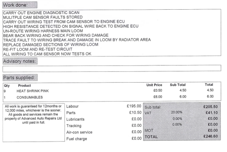

Its gone into the garage this morning and they are going to have a scope of the electrics first and go from there. I will report the findings I think it is electrical as the car runs great once going and when it cuts out it would appear to be an electrical cut rather than mechanical.
So my problem was all electronic. Brakes in the loom that runs near the radiator.
3hrs of labour at £65 per hour + Vat copy of the invoice attached interested to see what you think of the bill.
