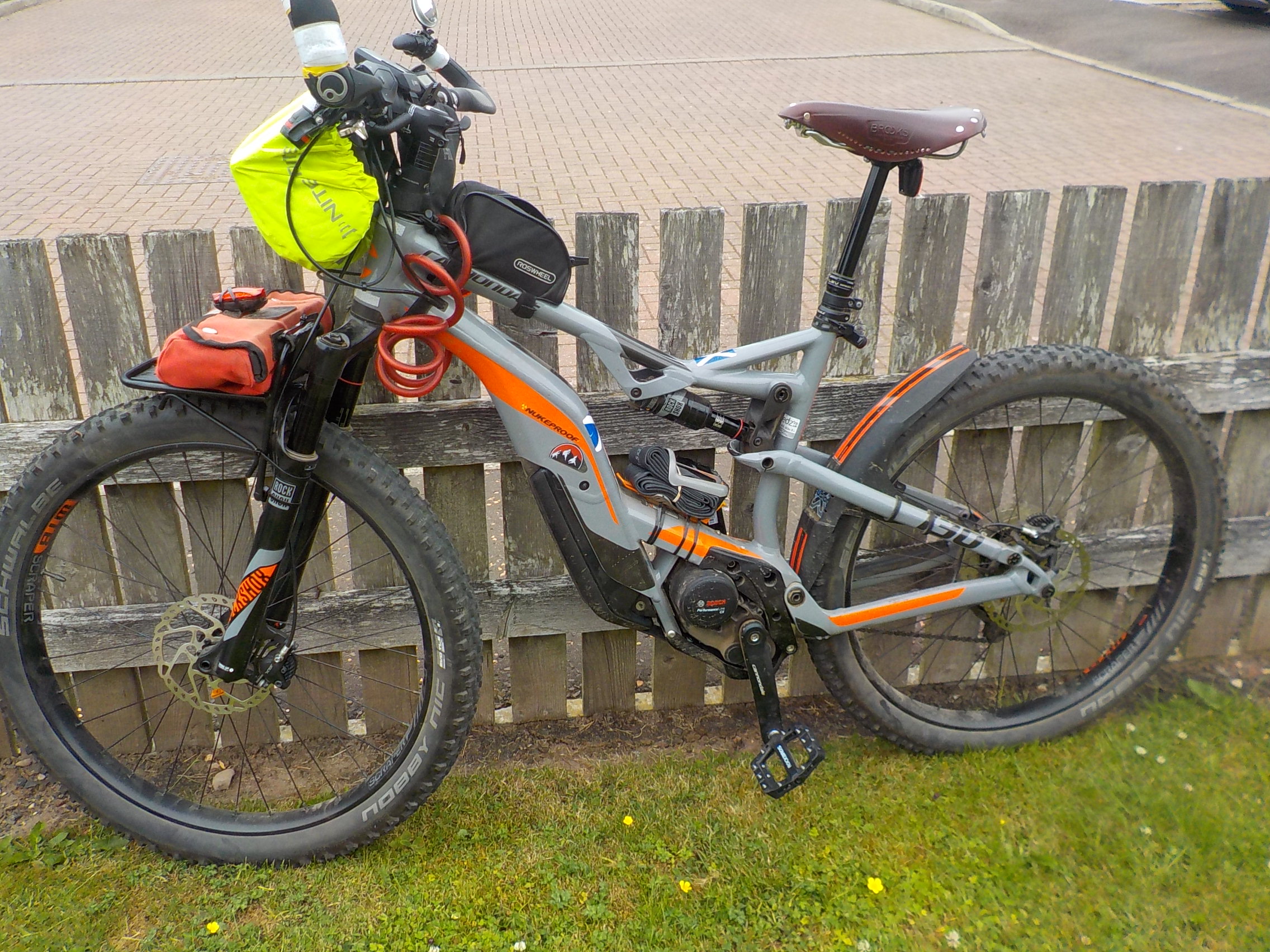

My bike's just packed up 😭
Powers up but it's not recognising the wheel magnet, so no speed, and therefore no motor.  No prior warnings. Was fine a couple of days ago.  Tried restarts and moving the wheel magnet a mm at a time, but no joy.
I'd just got Mrs Gaz's ebike out and pumped the tyres, dusted it off etc.  We still went out, but it was hard going.  I was hoping it might sort itself out but nada, nuffink doing.  On the bright side, her's will tow me up a steep slope on the throttle alone 👍 Have drank half a gallon since getting home and still don't need a wee!
I've left a message for the bike shop (not open today).  Sad times :sad:

Bike dropped off at the doctors, awaiting news.  Fault not obvious, so needs diagnostics.  It needs a service, two new tyres, chain and cassette (has started to jump in 8th/9th occasionally), hydraulics service (brakes) and whatever electrical repairs.
Holding my breath, but it serves me right for not having it serviced since before lockdown.
Gaz

Bike fixed :dance:
Wheel speed sensor on diagnostics was registering 92mph and then 4mph when doing neither.
New sensor, diagnostics, chain, cassette, tyres, pads, brake service, rear wheel bearings and labour came to £335 all in.
Picking it up in the morning 😎
Gaz
EDIT: Just cycled it home and it feels fantastic 👍👍  I'm a very happy cycling bunny! The wheel speed sensor wiring is now external due to the amount of work needed to route it back through the frame, but that's fine.  The bike mechanic says he's seen an increase in these type of failures (particularly Bosch), all of which seem linked to long-term use of speed dongles.

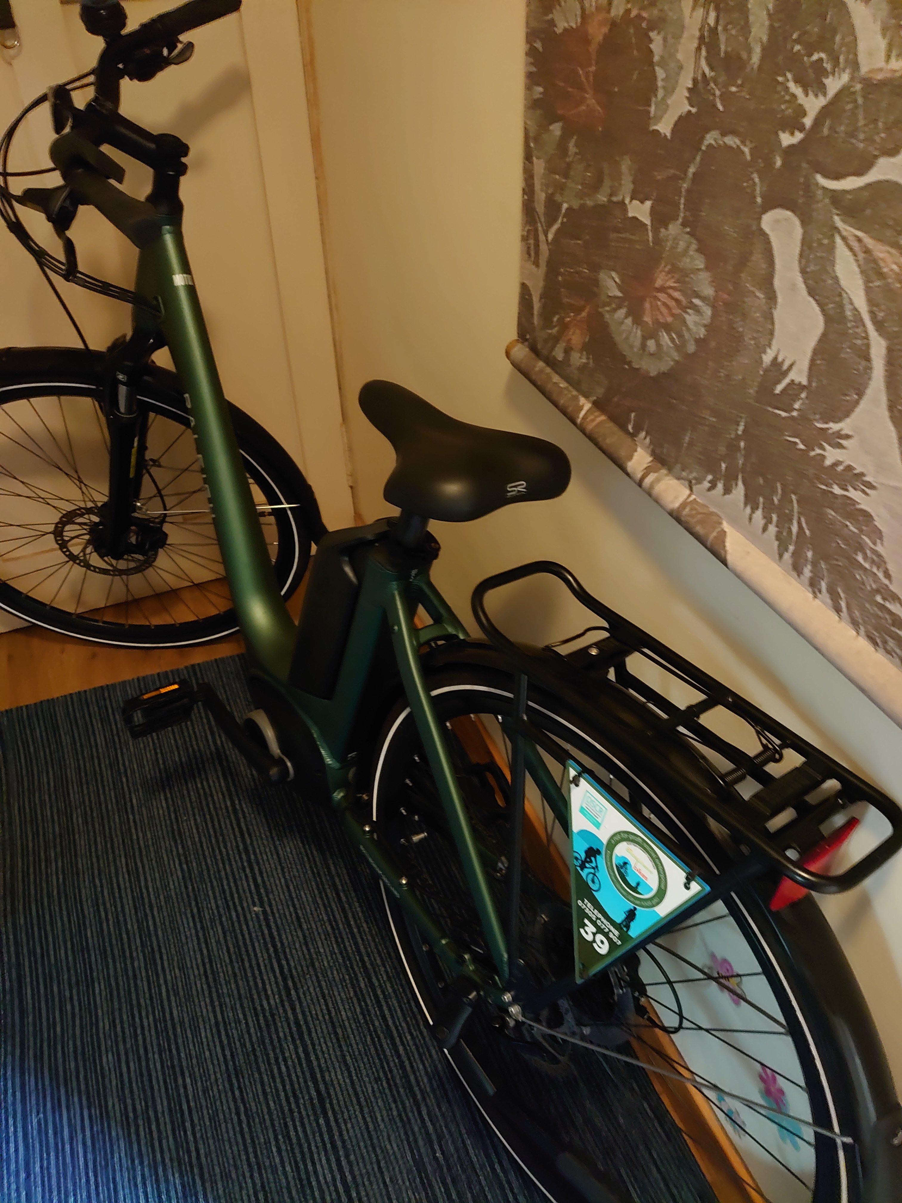

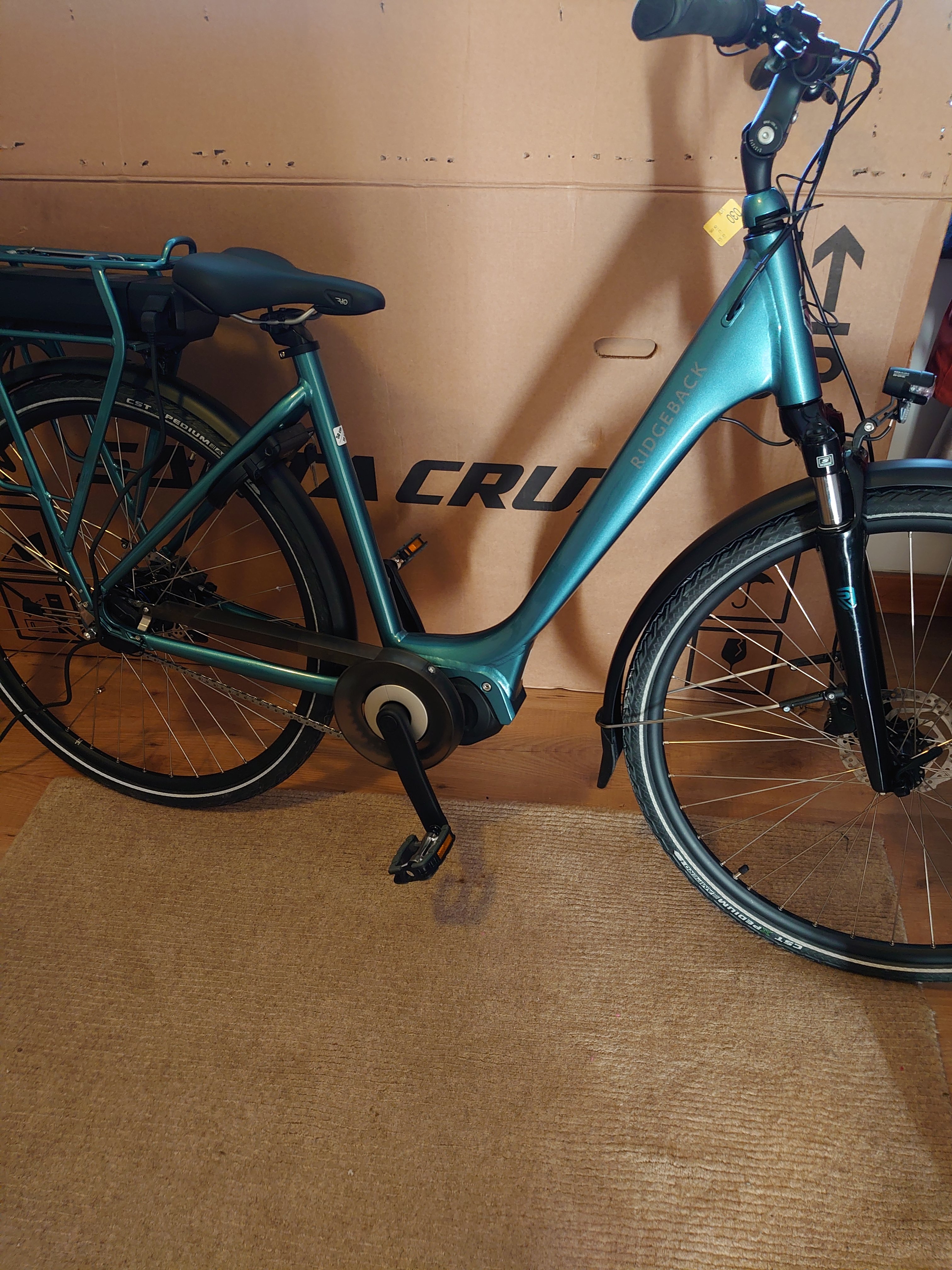

I got a new Risgeback Di2 e-Bike for my partner, unboxed, handlbars on and front wheel and unrapped.
Now i wish i had tried switching it on first.   On charge, but can not see why not going on.
It was to be a surprise, now it is a PITA!

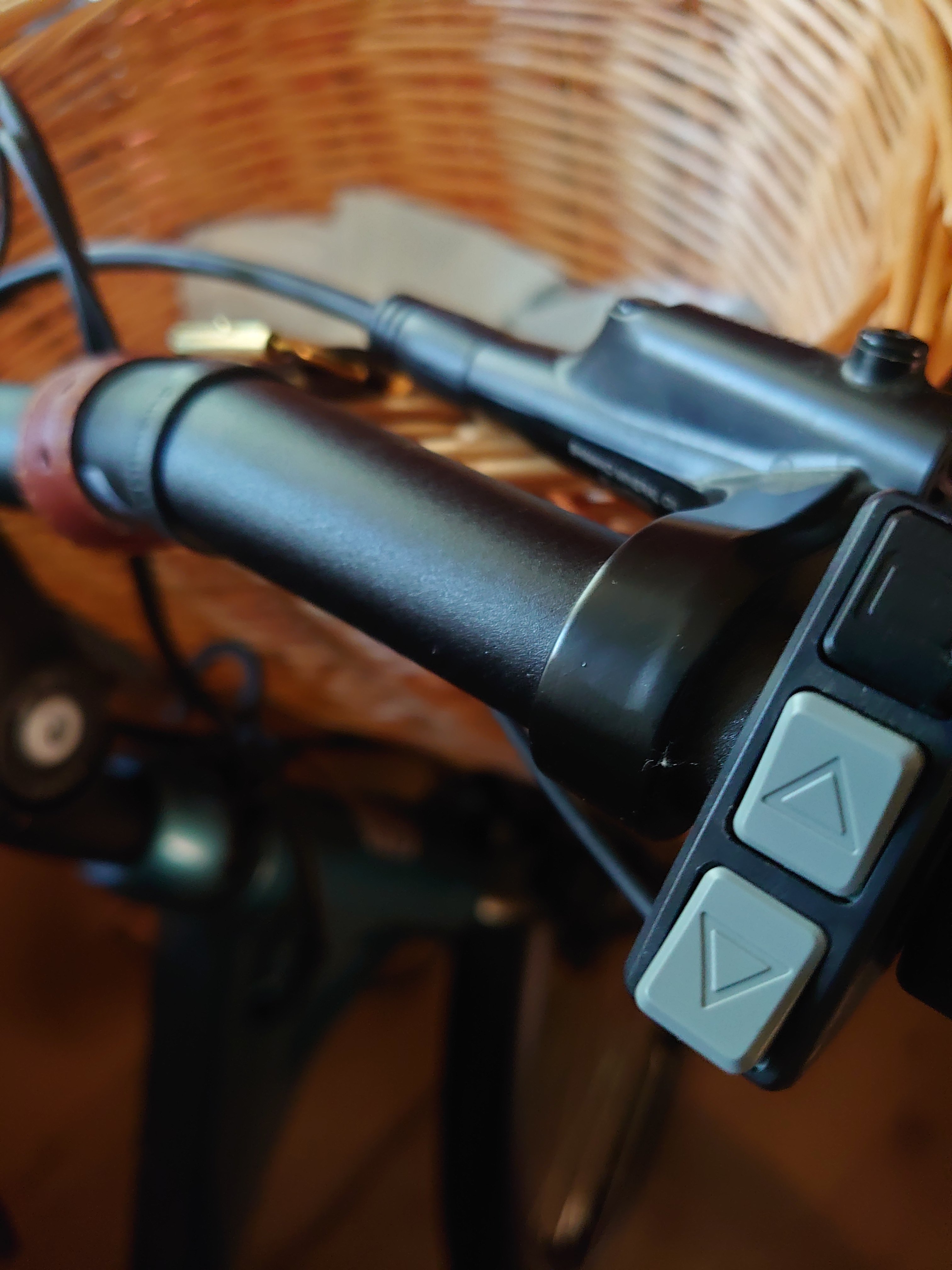

Video shows a center screen like i have on my fat -bike, but this one is a screen on the left bar and an up down on the right.
Waiting to here from 'Support'.
