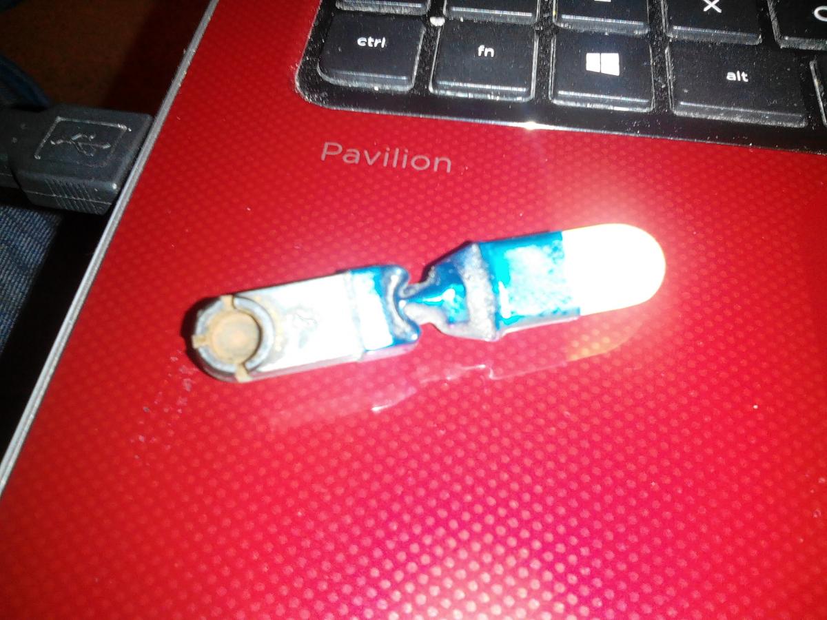

I have a problem with my the pump on my diesel pickup. The blue plastic "arm" fall of bccause the plastic is worn.
I guess the solution would be to replace it, however i cannot find any replacement.
Anyone got a part number for it?

Can you see this picture?
Yes, now it's visible.
There is no part number for that plastic piece. But if you have the worn part, you can make a stronger copy from it if you have basic modeling skills.
I have one you can have it no charge PM me your adress
