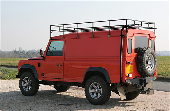

As to the likes of a Defender, anyone that has had them will know all about Wading Plugs and Axle Breathers, waterproofing etc etc.
Many an unprepared 4X4 dies a death, and many a AWD as well, or Softroaders,
Not all the gear and drivers without much between the ears.
My old 110 had a few drownings before the engine was waterproofed the air intake was high and the axles had breathers..
A freeze after a soaking was still not pleasant though.
