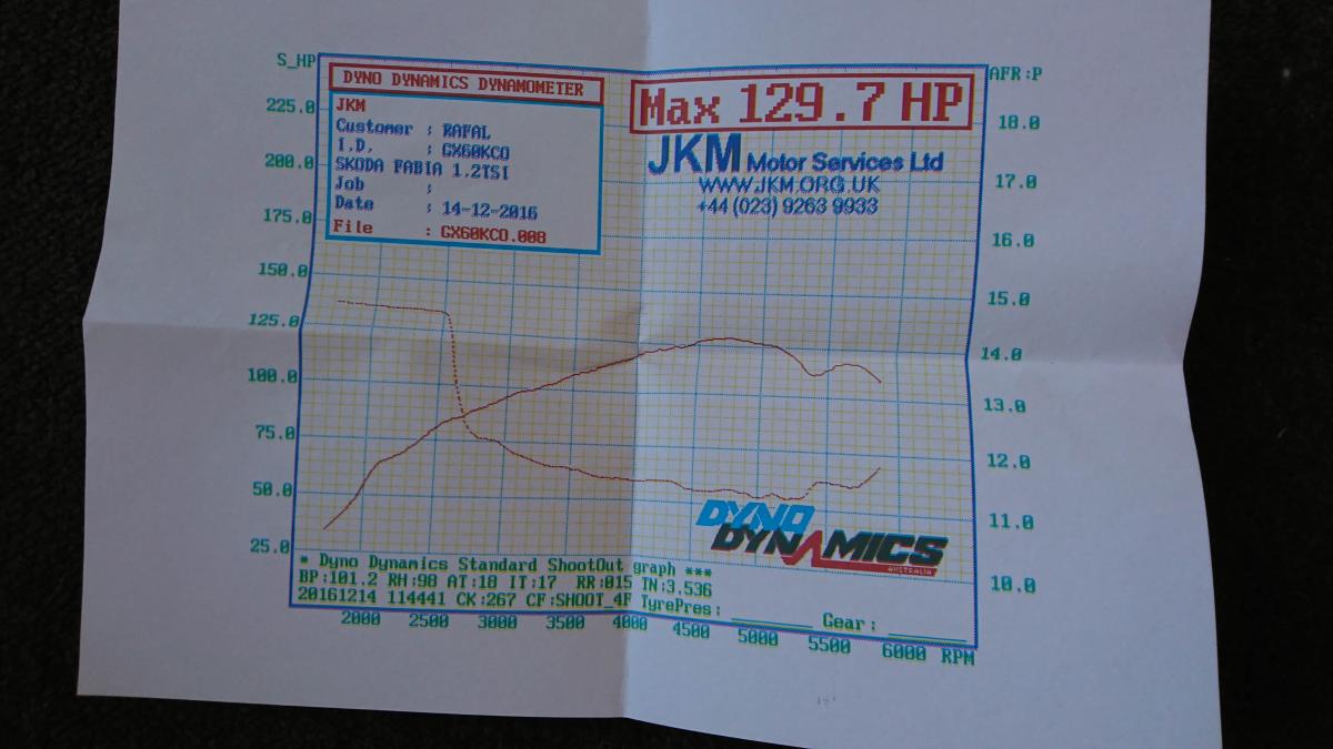

I'm sorry for very late response. My car is making almost 130bhp now! :) What do you think?
