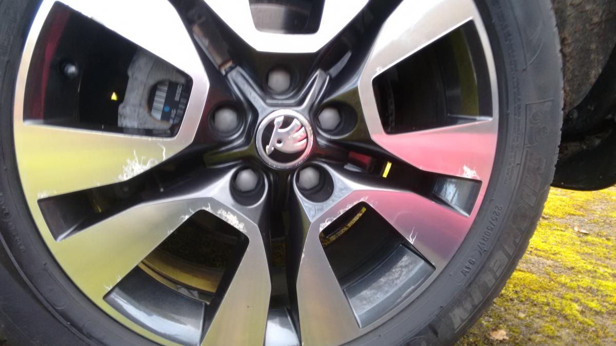

Hi, I have a Skoda Yeti Outdoor L & K still under warranty.  Noticed marks on two of the wheels spoke to Sales manager at dealership who remarked that they would be refurbished under warranty as they have done this in the past re the laquer failing on the edges of the alloys.
Have now been told from there service dept that SKODA UK will not now refurb these wheels under warranty any more.
Can only upload one photo of a wheel.
Two different causes:-
1. Kerbing.
2. Poor quality finish by Skoda.
Warranty on No2. You need to insist if its not no.1.
Do not go for 'Refurbishment', go for 'Replacement'.   That same 'Service Department' can have someone get the camera working,. get the Pictures to Skoda UK the Warranty Provider, You can as well, then the Area Warranty Manager can arrange to inspect the Wheels & the White Worm Corrosion.
No need to accept refurbishment.
The Service Department can keep that for getting done on their Sales Departments cars wheels.

The wheels damage is not by kerbing .  Apparently pictures were sent to Skoda Warranty dept who told the service dept that this type of corrosion is not covered now under warranty whether replacement or refurbishment.

Well, the pic you have posted is obviously a case of water getting under the lacquer coat, not least because some of the corroded areas are at least adjacent to the hub area, and none of them are adjacent to or concentric with the tyre.

I think, looking where the corrosion has ocurred, it's due to the design of the alloys themselves.
The edge where the corrosion starts, appears to be on a right angle, any cleaning, washing of the wheels will have a wearing effect on the edge, thus thinning the lacquer and allowing the ingress of water.
Refurbishing them will not prevent it in the future, if my theory is correct.
Most alloy wheels have neat flowing lines rounded corners, and corrosion on these starts after kerbing, stone chips or poor wheel handling during a service or tyre replacement.
Poor design of wheel is what I think, which can only be resolved by replacement by an alternative design.
So in my opinion, poor design, not fit for purpose, and should be a warranty replacement, in fact with good publicity, could be a total recall of that type of alloy on all their vehicles. Do they really want you to take this further?
You don't see much rust on cars these days, but in the 80's corrosion always started on the edges of the seams, exposed thin edges of paint. I rest my case lol.
