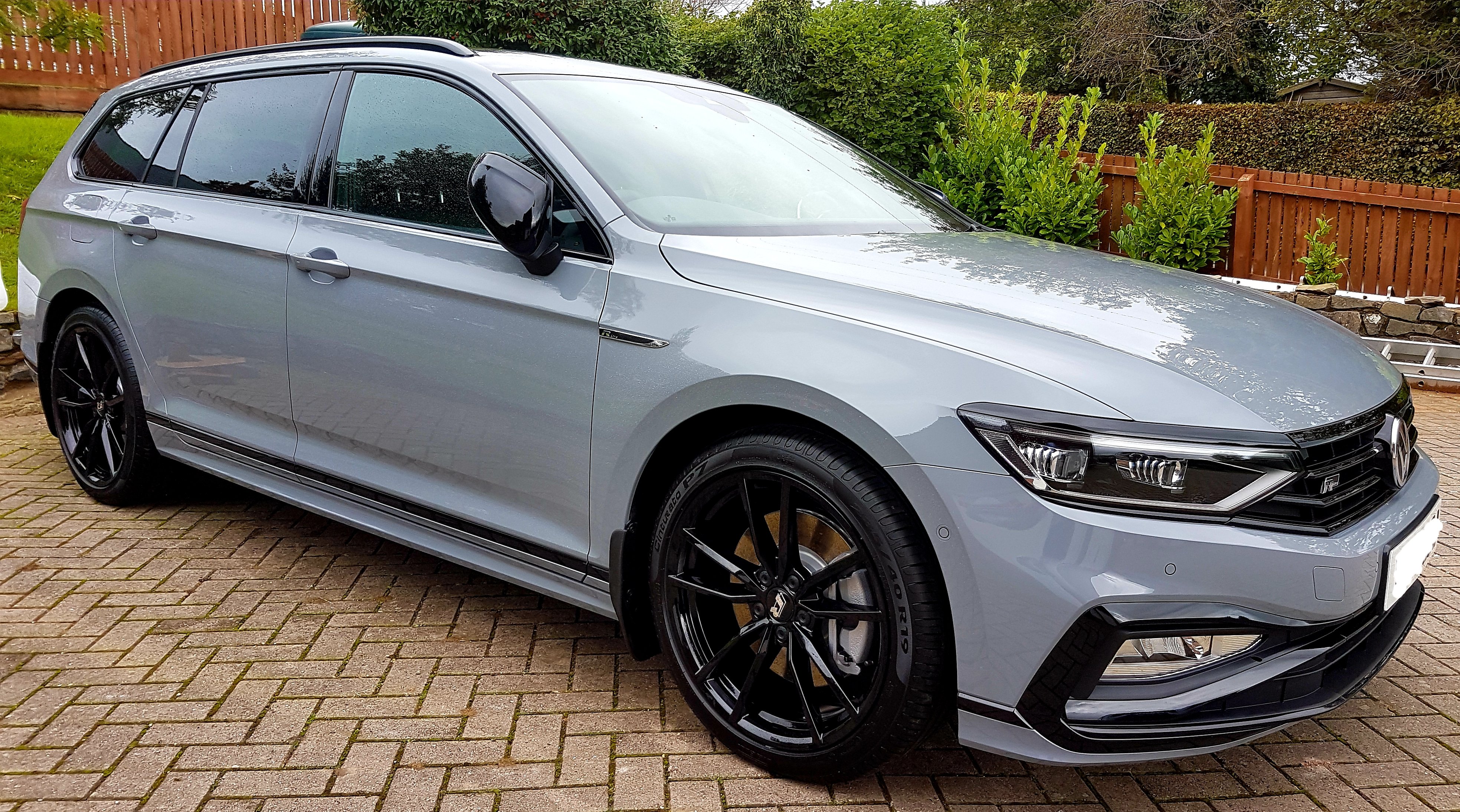

My new Passat has 'IQ' LED headlights, all singing, all dancing - but no washers. What gives? 🤔

@pist0nbr0ke - At a guess, it's because the output is 2000lm or below.
Current ECE regulations state that:
- cleaning systems are mandatory on anything above 2000lm
- levelling systems are mandatory on anything above 2000lm and all LED headlights
I believe some groups are trying to change the levelling requirement on lower powered (2000lm and below) LED headlights to make them cheaper to install.
If you have adaptive / matrix high beam (partial shielding) then the dipped beam can be lower powered as a proportion of the main beam can be active most of the time. It is the dipped beam strength that mandates the washers.  When I was looking at a Tiguan SEL, that was the same.
