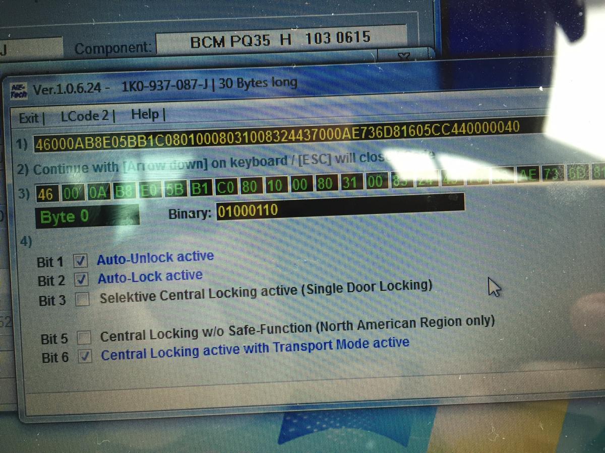

Open VCDS, enter 09 central electric, coding and check all the bytes to see if you've got "Selective door locking" ticked. If is ticked, deselect it, exit, do it.
Perfect. I do. Will go uncheck it. Cheers
