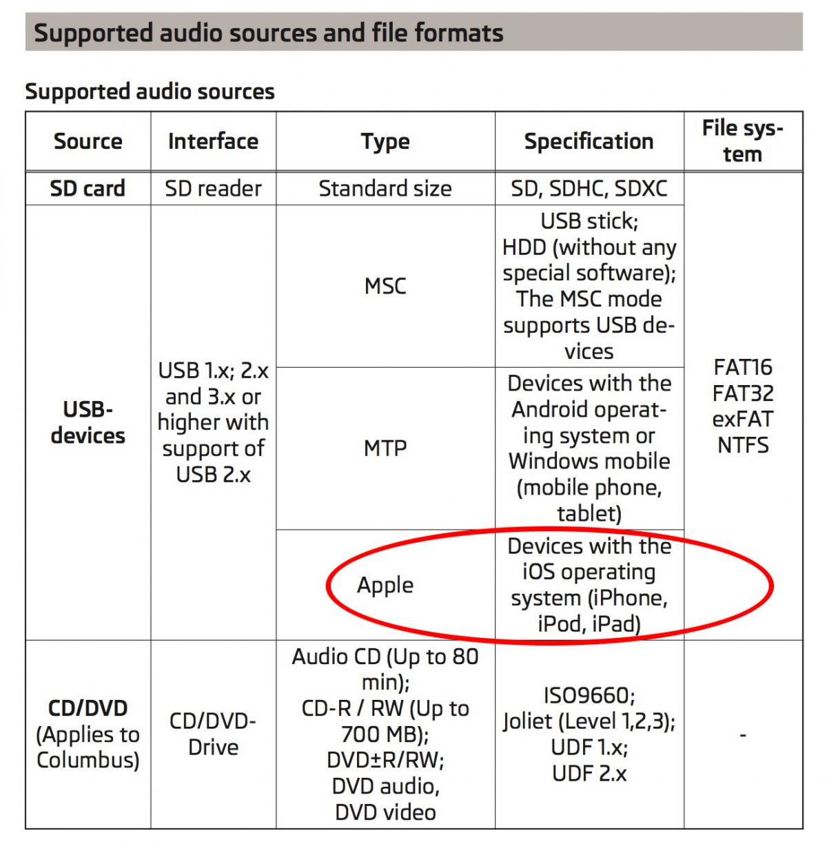

I have put all my music into Loop for Vox.
Use the Vox player in AppleCarplay which delivers all formats including lossless.
But when I plug ipod in Columbus it says "USB unreadable".
This is because the MiB-2 Columbus only supports iOS devices and the Classic you are using is not an iOS device.
When you connect the Classic it is being recognised simply as a hard drive but it's not in a compatible format - FAT or NTFS.
Unfortunately technology doesn't stand still and old technology gets left behind, such as the Classic's OS that hasn't been updated since 2009.
Your options are...
  • Upgrade to an iOS device. If you want to store your 80 GB with playlists then you'll need a 128 GB device which means either a current 6th generation iPod Touch or an iPhone 6 or newer. Both are Bluetooth devices so will leave your USB free. If you can get your hands on a cheap used 128 GB iPhone 6 you could use it purely as an iOS iPod without needing to activate/use the telephony functions, though if you'd want to use CarPlay/Siri you'd probably need an internet connection.
  • Spread your music library across SD/USB and/or Jukebox but, as you say, you'll lose your existing playlists.
  • Use the AUX input. Far from ideal as the only Columbus control is volume, everything else being controlled from the iPod. No display of tracks, albums or artwork on Columbus.
BillyJim, thank you very much for your clarification. Of course, I forgot about IOS. Well, all that I am left with is to rearrange and reorganize my itunes file library and sort everything in a reasonable number of directories and put everything on a 128 gb sdxc card.
