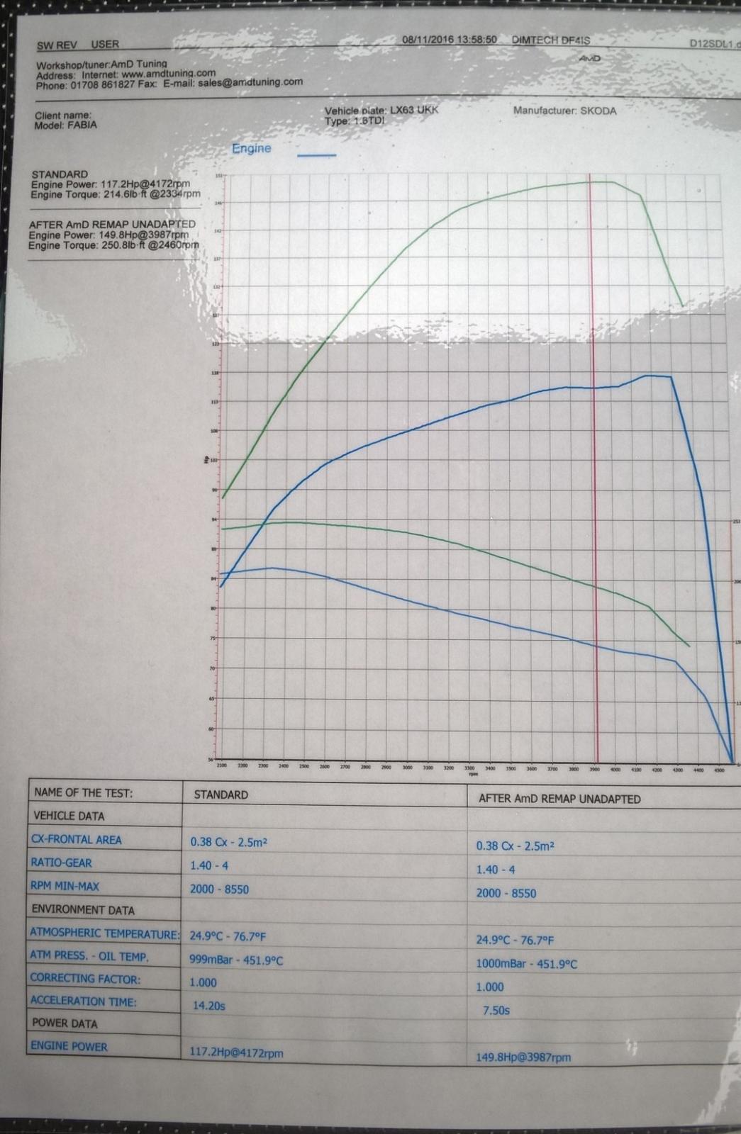

Had my 1.6 tdi 105 Monte Carlo re-mapped beginning of November by AMD Tuning.  Stage 1 adaptive.  Well pleased with the results.  No issues so far.

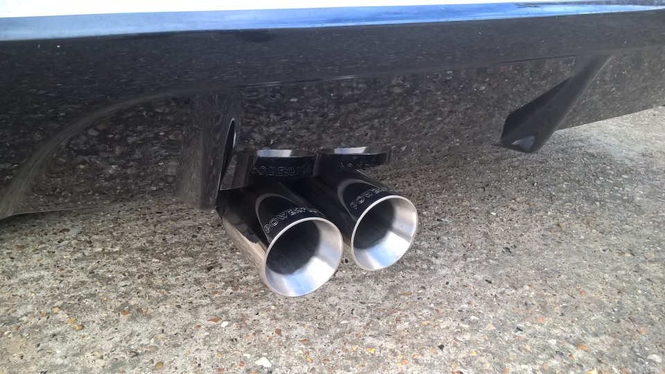

I had already fitted a K&N air filter element and a straight through CAT back Power Flow exhaust.
Standard was 117.2bhp  with 214.6lb-ft torque.
After re-map was 149.8bhp  with 250.8lb-ft torque.
