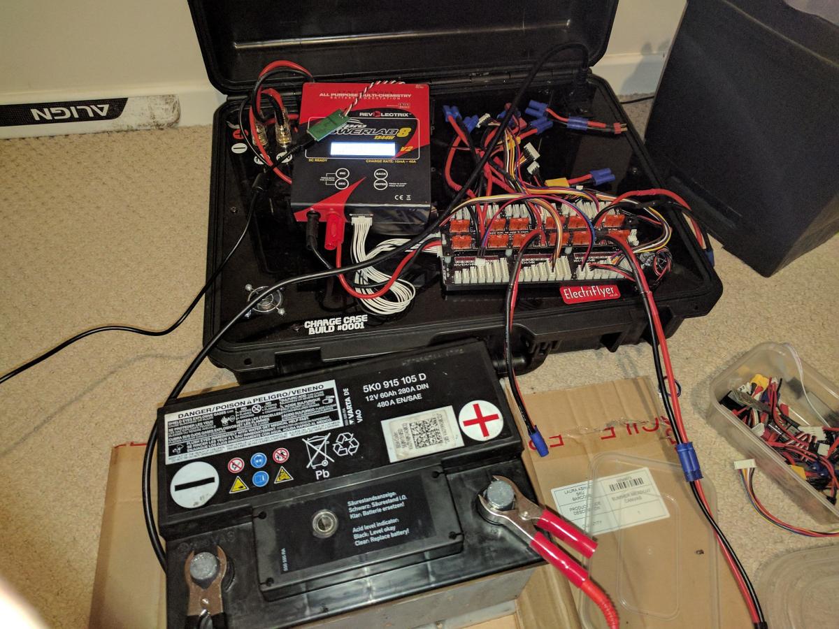

So, long story but I need to bring the battery in the house to charge...
Am I right in saying it's this ~13mm bolt I need to loosen to remove the battery? The one in the centre of the image, out of focus...
https://goo.gl/photos/6eMzu1WmTx6ebiD59
13mm is probably the correct one
I've always used 1/2" socket on my car

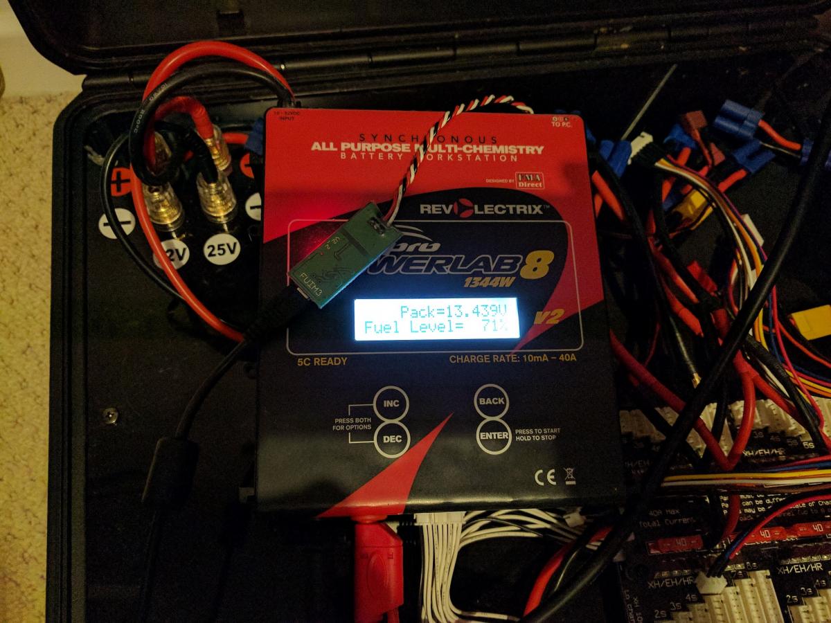

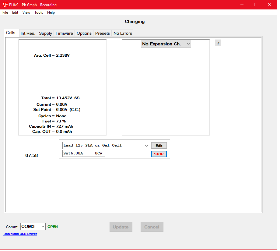

Thanks, got it out. Just trying to find the right 12v Pb preset on my PowerLab 8 RC charger. I have three choices:
  • Lead 12v Optima AGM Spiral.PS8
  • Lead 12v SLA or Gel Cell.PS8
  • Lead 24V Series Car Batteries.PS8
Can anyone confirm that it's the first one as I suspect?
It's set for 2.45v, which for a 6 cell battery would equate to 14.7v, fully charged which is correct.
Edited by planehazza
I think 2nd one as it is a seal lead acid battery (SLA), the first one is for cars with stop/start glass mat battery
That makes sense. The two chemistries are similar, and I guess I'd rather charge at 2.33v per and undercharge, than 2.45v per cell and overcharge.  It's charging along at 0.1C (6A for a 60Ah battery) and the "fuel" level of the batter was at 30% when I put it on.  It's going up to more along where it should be now.
