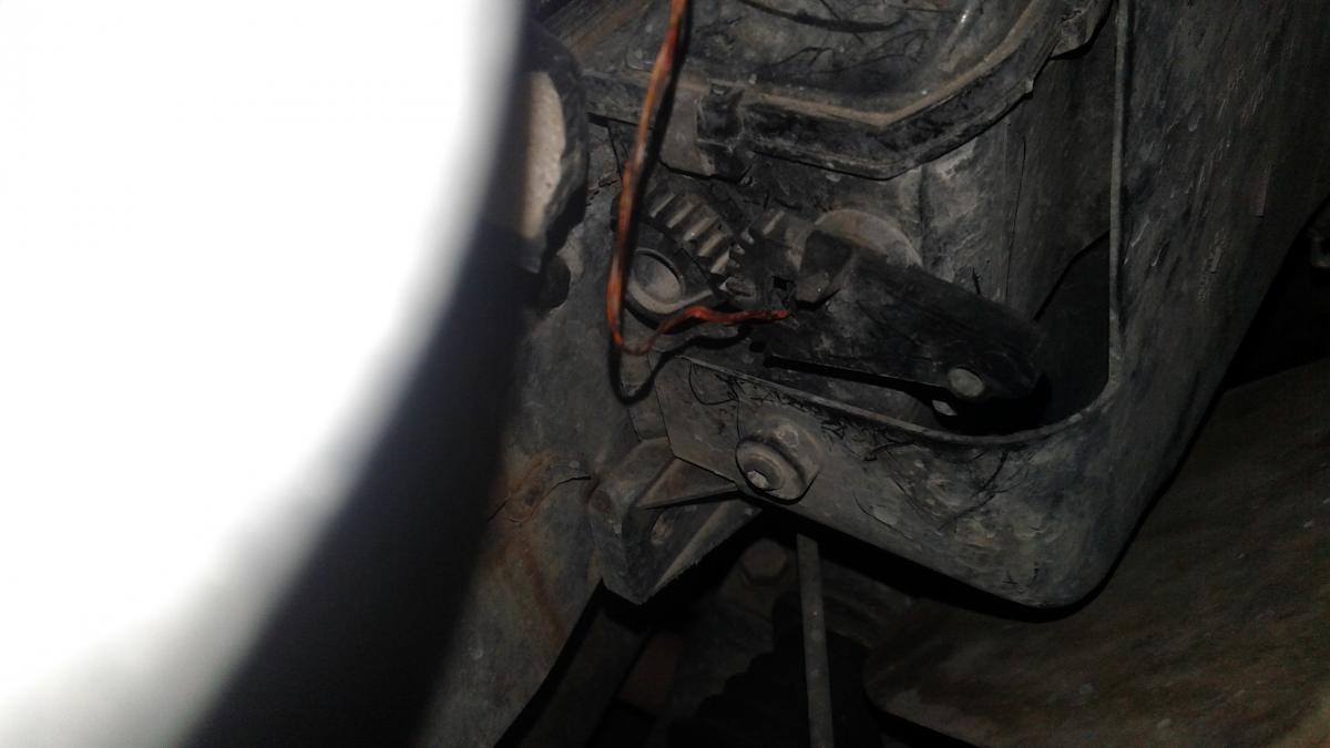

1. when I bought the car I noticed that little lever  was preventing the other one from moving by using  a short  wire at the bottom of the A/C console.  here is the picture
 can you guys please tell me what those lever are for?

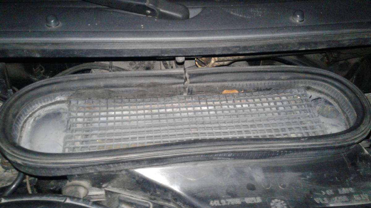

 because I can feel and hear that A/C is sucking the air through the Bonnet (I do not know the name of the part)

What you're hearing and feeling is the radiator fan drawing air through the aircon radiator part of the chiller.

Here are some illustrations that show how the fresh air / recirculating flaps work.
As you can see, the sector gears you asked about are part of the recirculation flaps mechanism. Yours is blocked. By unblocking it, the recirculation button should restore its function. Of course this is true if the vacuum damper and the vacuum circuit that operates the flaps are intact.

Vacuum circuit that operates the flaps are not intact, but I managed to fixed  by sealing the top flap with some chemical, so it is recirculating the air all the time  and Air Condition is working a lot better. I also came across with a few leakages in the radiator area, specially where hose are. I bought some pipe clamps and tightened them. A/C is performing well. I need to measure  the temperature soon.
