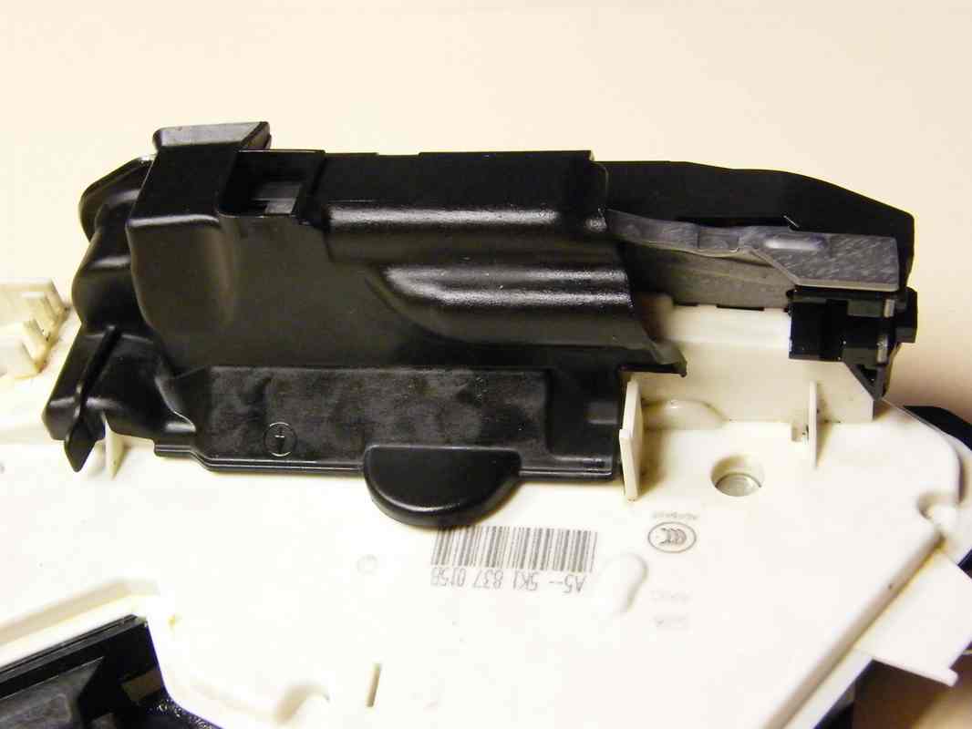

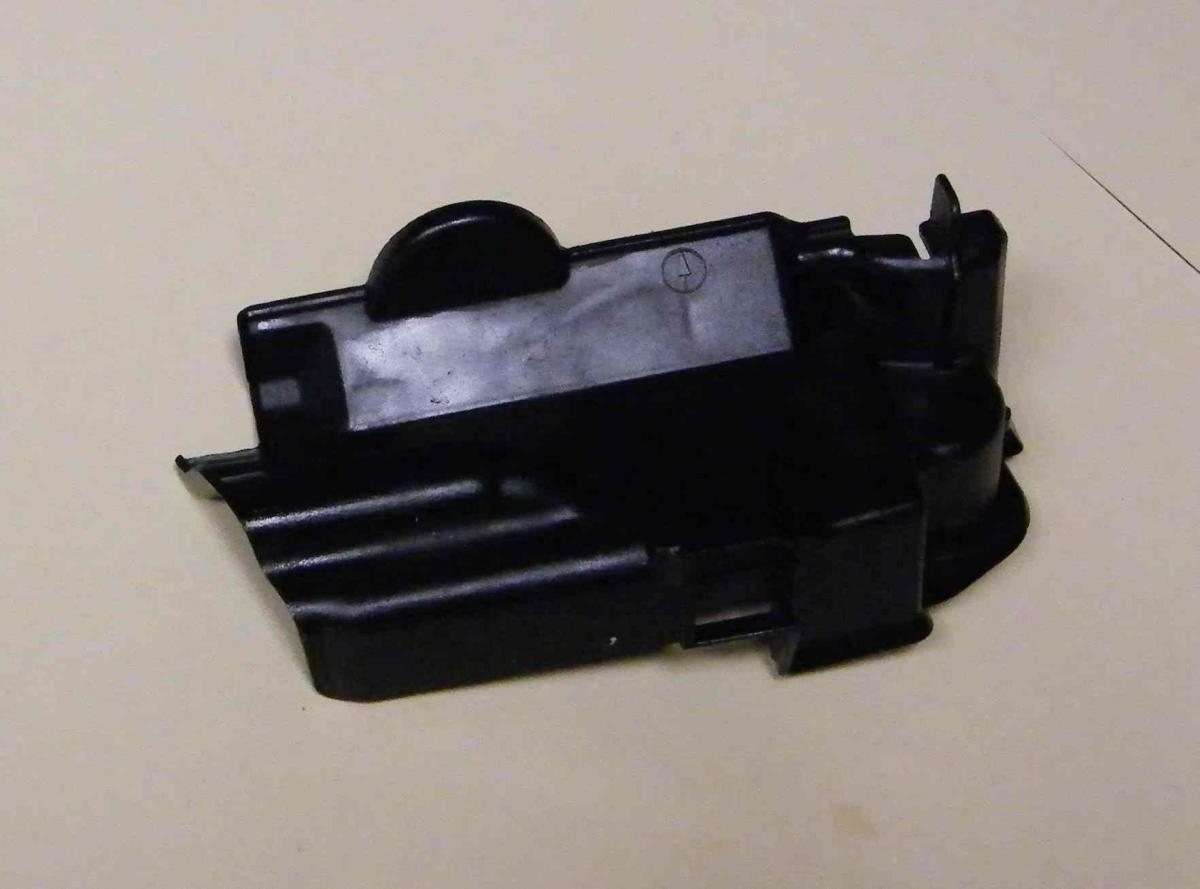

VW have designed plastic covers to be put on the lock mechanism.
Cover, front door, left: 5K0837349A
Cover, front door, right: 5K0837350B
I removed the lock mechanism from the door and lubricated most of the mechanical parts with Würth Teflube, installed the cover and reinstalled the unit. Only did this on the drivers side where the problem occured. But I have the plastic cover ready for the passenger door if this should start freezing.
Pictures shows cover only and cover installed on lock mechanism (drivers side/LHD)
