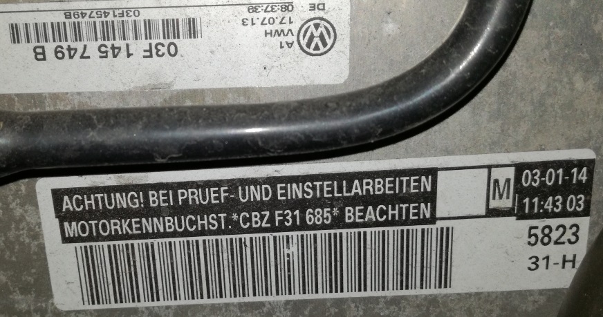

Just been reading through the items regarding the 1.2 TSI cam chain issues.
I've previously asked about this and was told that, as the car is a '14 plate, there would be no issues with it.
However, given the attached engine code info, can anyone in the know please confirm that this engine is "not affected" ?
Thanks in advance,
D
Unless your registered 14 plate has an engine built a couple of years earlier there is no way it should have the 'Made of Chocolate Cam Chain' Issue.
They were pretty much "all" sorted by late 2012 and I would be surprised if the engine would have been sat in a crate all that time given the volume of them that sold.
Thanks, chaps. Just thought I saw 2013 mentioned in other thread and wanted to double check.
Thanks again.
