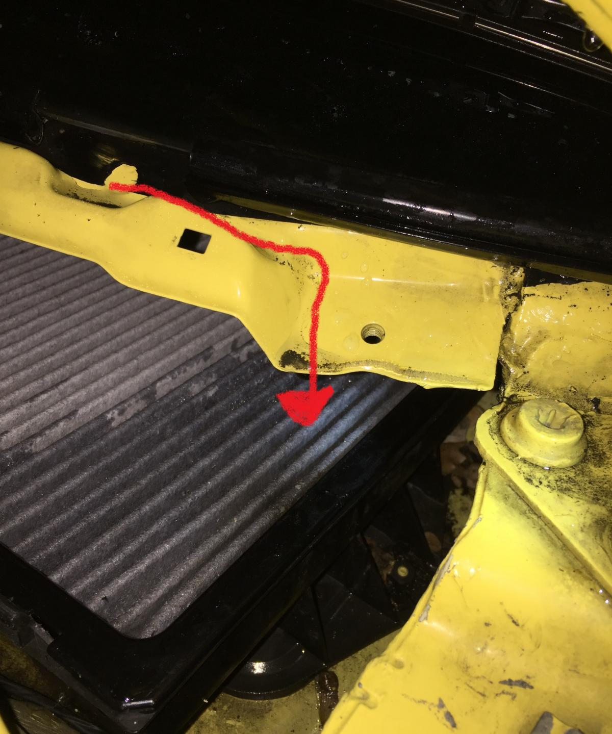

Went and looked at the scuttle panel, took it off and could se straight away the rain water was running almost straight into the pollen filter!

Ok so the car has been sat all day in the rain, tonight the footwell carpet is soaked and the heater fan housing behind the glove box was full of water.

This one shows how the rain water runs down when I take of the scuttle panel.

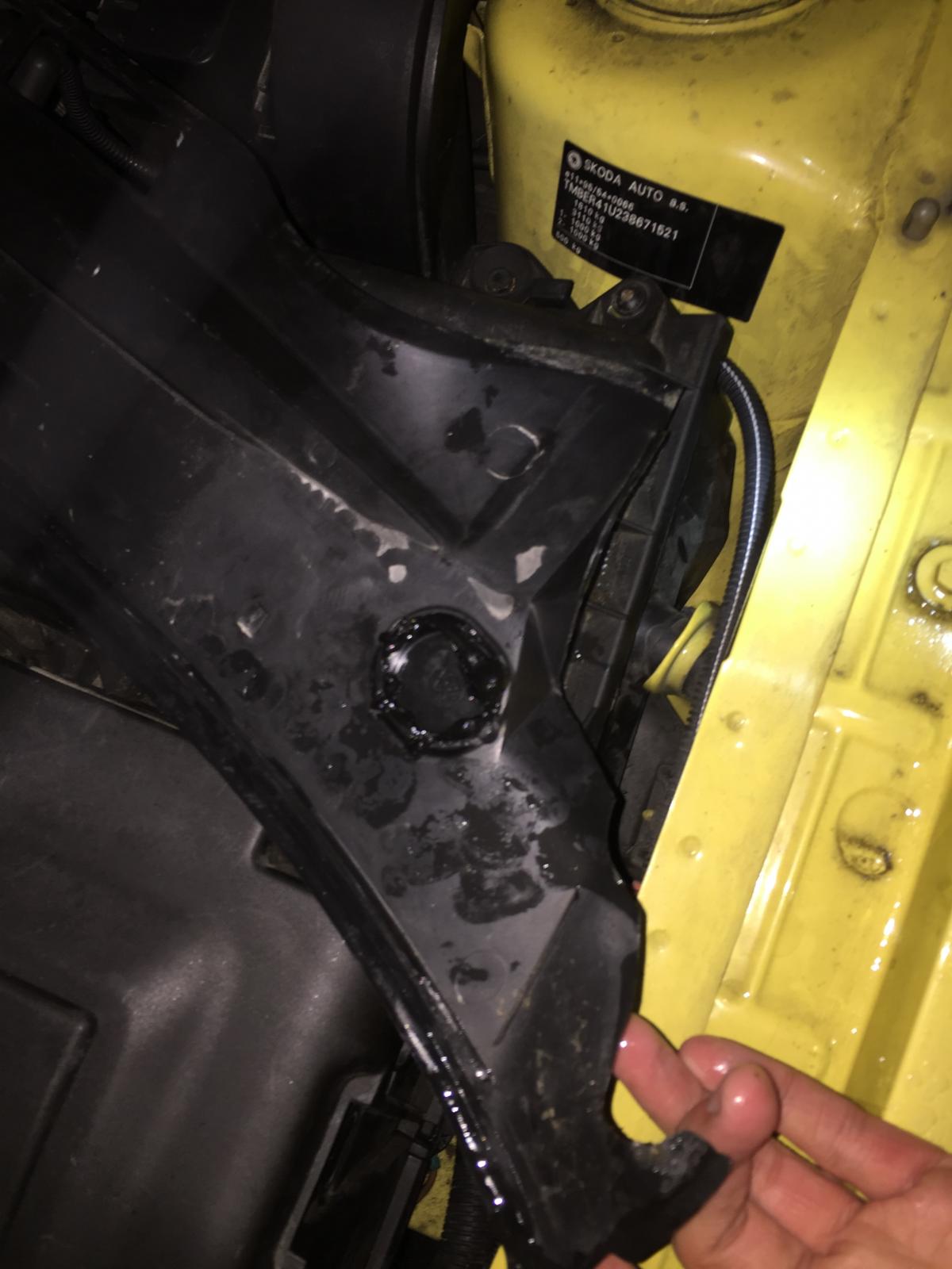

The next one shows the underside of the scuttle panel, there does look like something has broken off it? And a badly sealed grommet i guess??

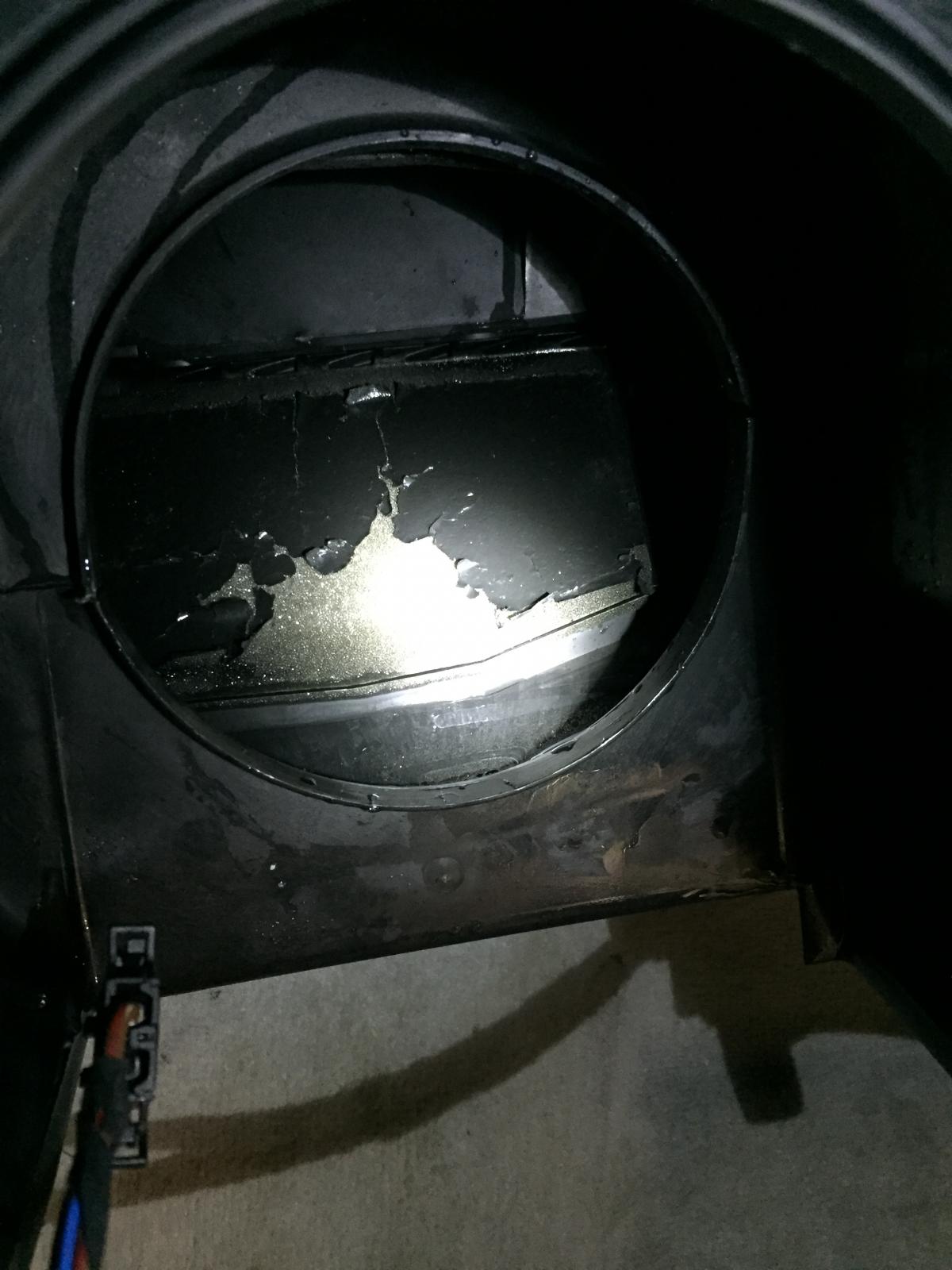

Inside the heater fan bit that goes up to the pollen filter which looks like its been getting wet for some time....

So is there an extra lip under that side of the plastic scuttle panel?  The idea is it locates in under the yellow part of the steel so any passing water gets deflected by it avoiding the pollen flter.
Its quite obvious and may have come off in the past.  Post some better pics of the underside of it as it may have snapped off in a former life.

Oh yeah mine definitely doesn't have that bit!! I'll get one ordered tomorrow. Cheers Dude
