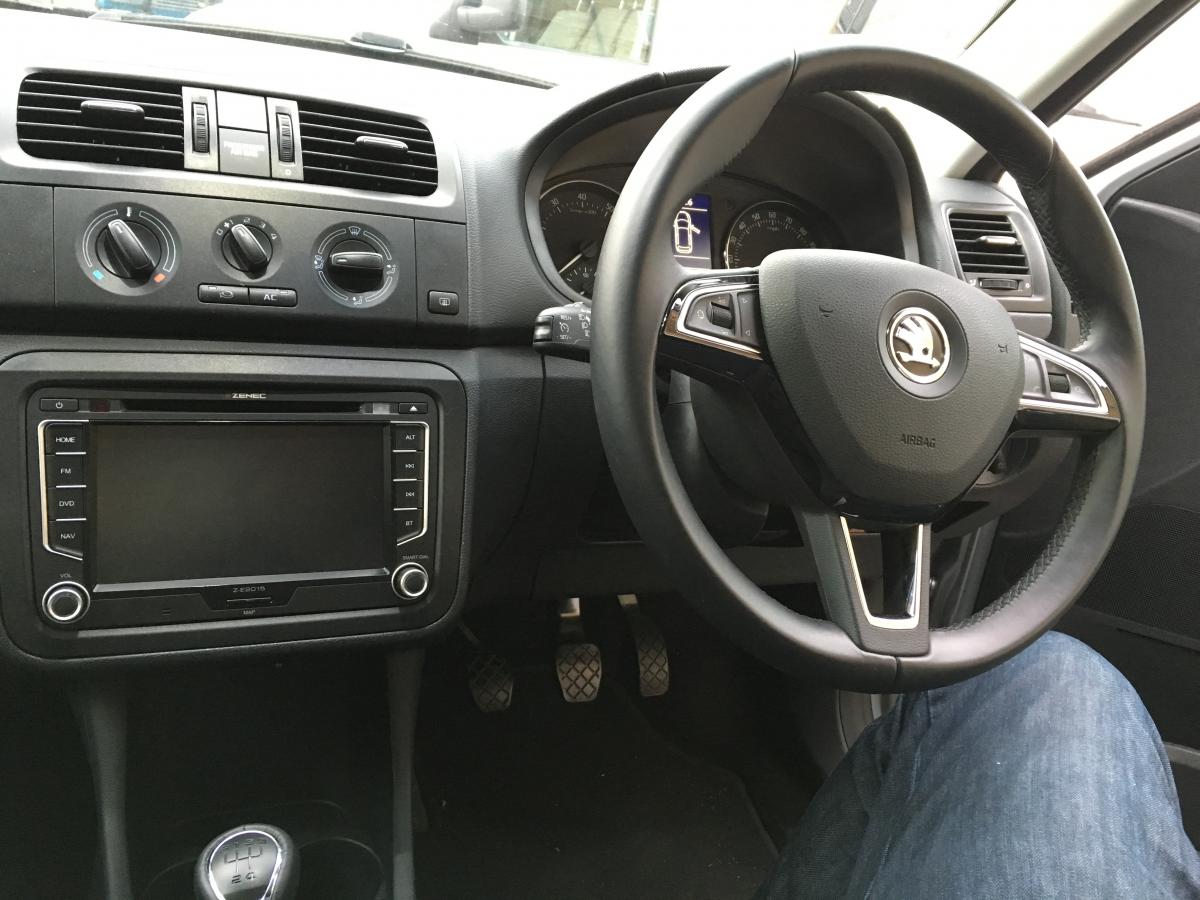

I fitted a columbus to our Fabia due to wife travelling more with new job.
Bought from the excellent RustyNuts on here for a good price. Took me longer to get the tools out than to fit.

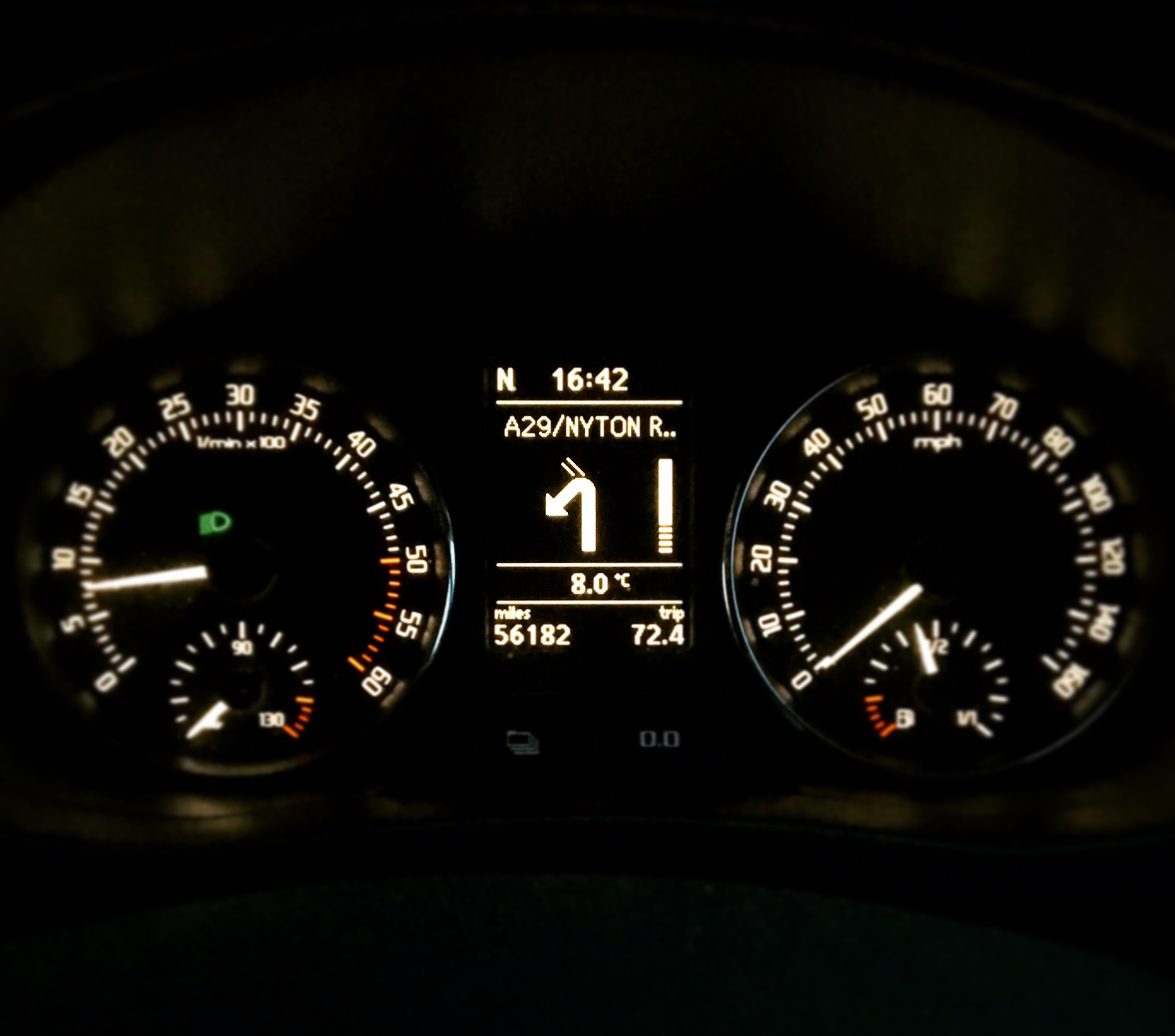

The bar to the right of that is distance until the displayed is required, works well for roundabouts etc
Mine just says the distance in yards :D

How did you manage to get it into yards instead of the weird loading bar?? thanks
Its just like that? Im not sure.
Its a 2013 car if that helps? Not sure if theres any settings in vcds or whether its just like that
Strange! Maybe its a Vcds setting! thanks though
