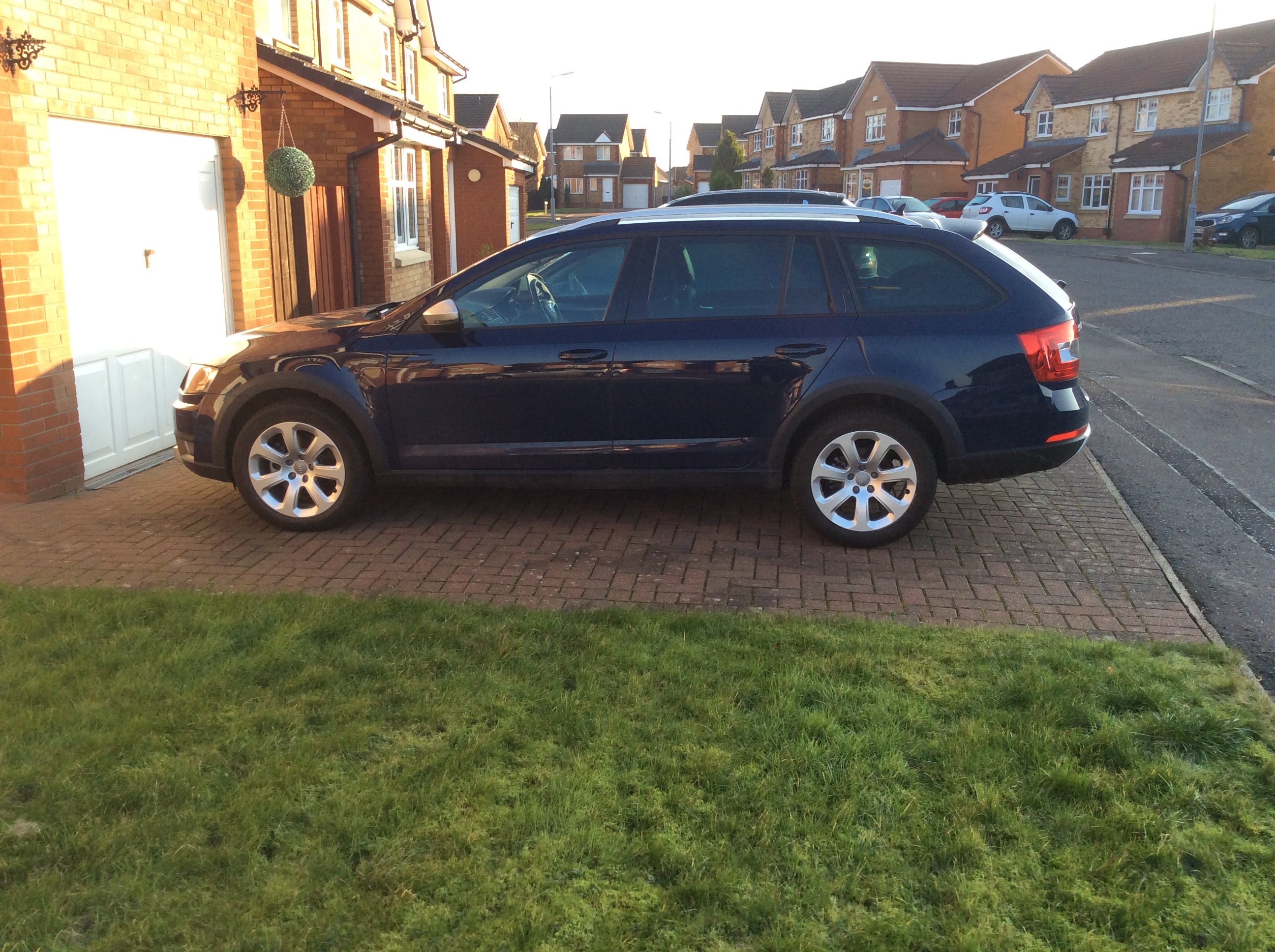

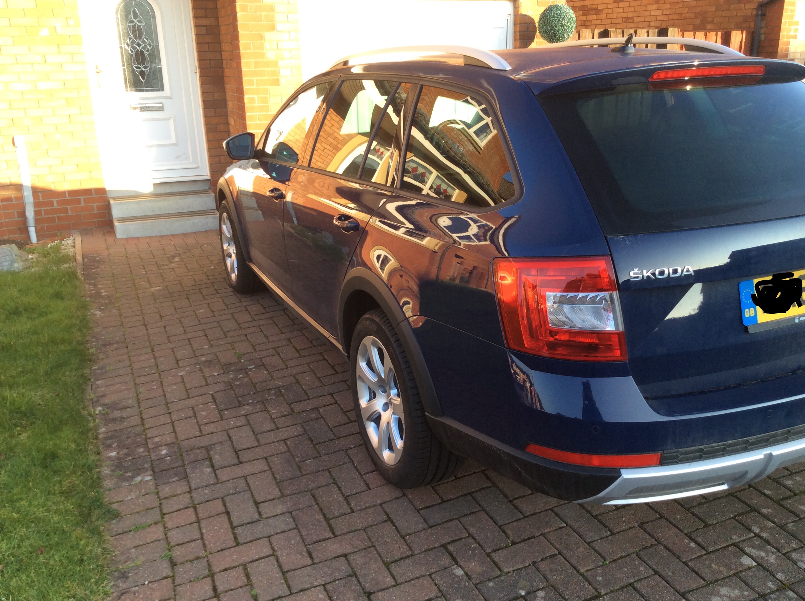

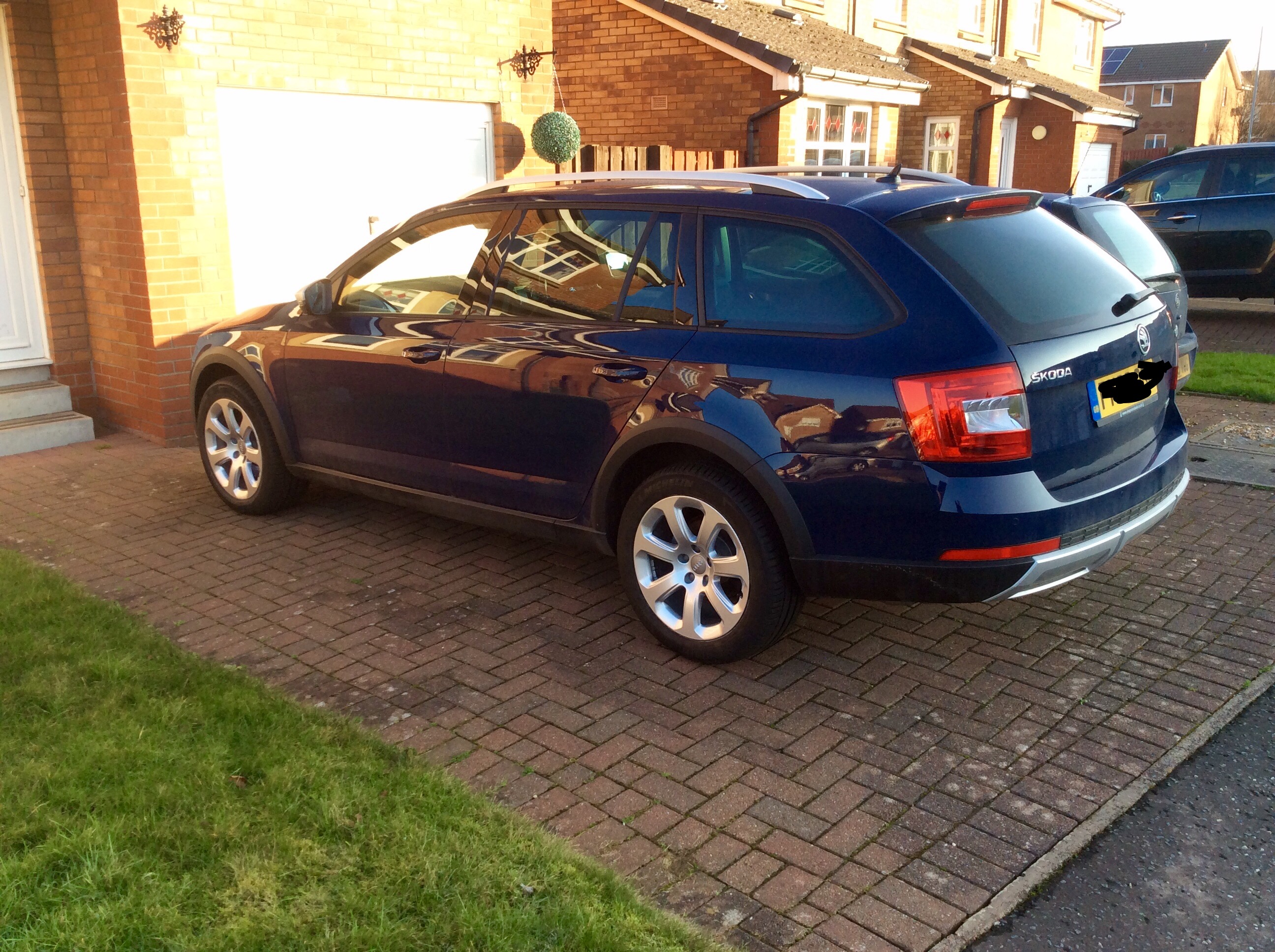

Update for anyone interested..
So as suspeceted offering them up with the 235/60/17's proved comical. Wouldn't even fit into the arches.
However once the original 225/50/17's were swapped on there were no issues at all! Looks waaaaaaay better and no foulage at all. Very pleased.
So big raspberries to those that said et26's wil never fit. In fairness to them though I think what is saving me is the extra 25mm ride height of the scout...

Don't forget to,post some pics
Will get some pics up tomorrow or day after :)
I think those work for the scout, where the arches are apparently wider and even then, that front wheel seems to stick quite a bit out - it doesn't scrap on full lock?
Nope. No scraping at all. Had a 20 mile drive back from tyre fitters through towns and roundabouts listening carefully for fouling but nothing.
Maybe if I go crazy quick round a roundabout, or braking heavily with some lock on it might foul but I never drive like that - the scouts not built for that kind of driving lol
looks good :)
low offsets suit that well with the ride height and arch extensions.
...not really, yes, but it kinda crossed my mind :)
actually, I have the impression I have seen older model Scouts on the road setup with very wide wheels that were sticking out a LOT. Or was it Audi AllRoads?
