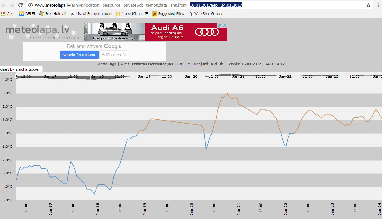

another guess that can be connected to temperatures under zero
gone since 20.jan (service were on 13. Friday)
