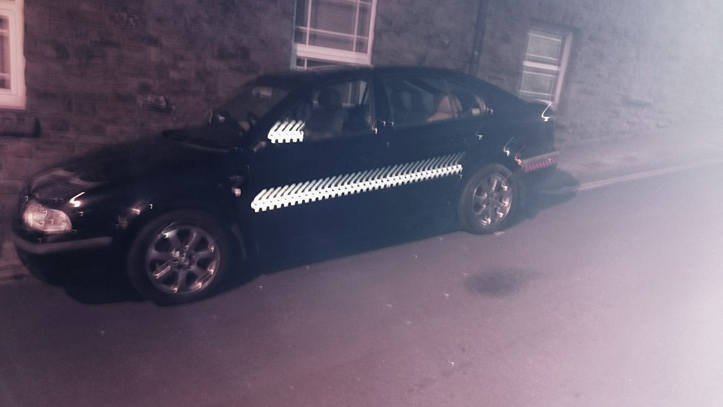

Just picked up a mk1 Octavia 'Laurin and Klement' saloon, its the 110bhp 1.9 tdi, its not perfect but figured it would be a good commuting machine for the next few months. Loving all the optional extras, whats even more amazing is that they all work!
Few problems with it:
It jumps out of 5th gear, can be held in gear but the minute you let go it pops out. (reverse is fine)
The coolant temp gauge is a bit all over the place, spends most of its life at 50 then occasionally creeps to 70 but then in the blink of an eye its back at 50. Something not right...
I need to change a sidelight bulb on it, because it has the xenons it appears that access is difficult, do i have to remove the entire bulb housing? Didn't look straight forward.
Is there really only one cig lighter under the armrest? Seems like the worst place for it.
Pic attached of the car
