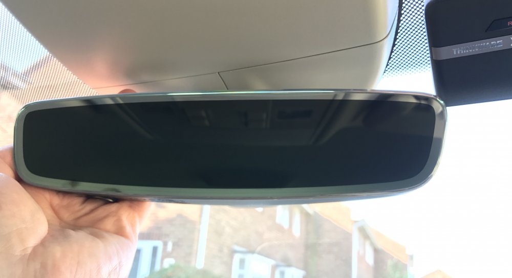

When I installed my frameless mirror, I tested the dimming function of the door mirrors by placing my hand over the ambient sensor on the back of the mirror whilst shining a light at the front. Front as in the mirrored side and rear as in the black plastic side that faces the windscreen. This was tested on a sunny day at about 2pm. The ambient sensor is on the left had side of the mirror.
I´ts 2 sensors, one behind rear view mirror and one in front av the mirror.
When my car is in the garage , i.e dark in front and light at rear and I put my hand behind the interior mirror as shown above all 3 go very dark ... move hand and they return to normal.
