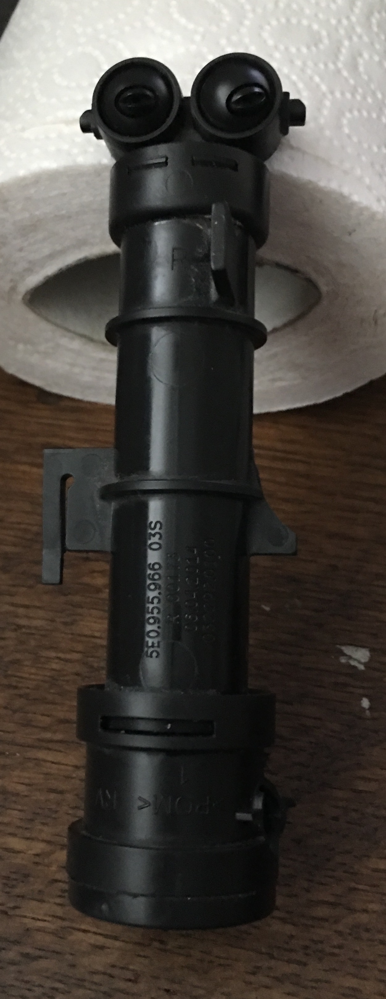

Okay - We have a solution in case anyone else gets the same problem!
The pipe that spigot on the o/s headlight washer had snapped. It remained up in the air so only lost a little water until it found its level. On the flat you could hear water running briefly and eventually finding its way out from under the S%$t Shield as my mechanic calls it. The water droped just enough to trigger the light but no further.
Been hunting for one all day as it looked expensive. Rang breakers everywhere but they only sell with a bumper. In the end I phoned the dealer and it was only £29 pls VAT and here tommorow. Very easy to see if have a pit and only needed the shield off. Not the dreaded bumper again!
I have attached a photo of the bit. The coloured panel unclips if you push the piston out from behind and get somone to grab it.
I think it would have been an MOT failure as Xenon washers are in there now. n/s wasnt working as it also needs the pressure to push it out and spray. My mistake was trying to get the washers to activaite when on automatic. You have to have the Zenons turned on in daytime then it tries to clean them every 5 times you clean the windscreen.
