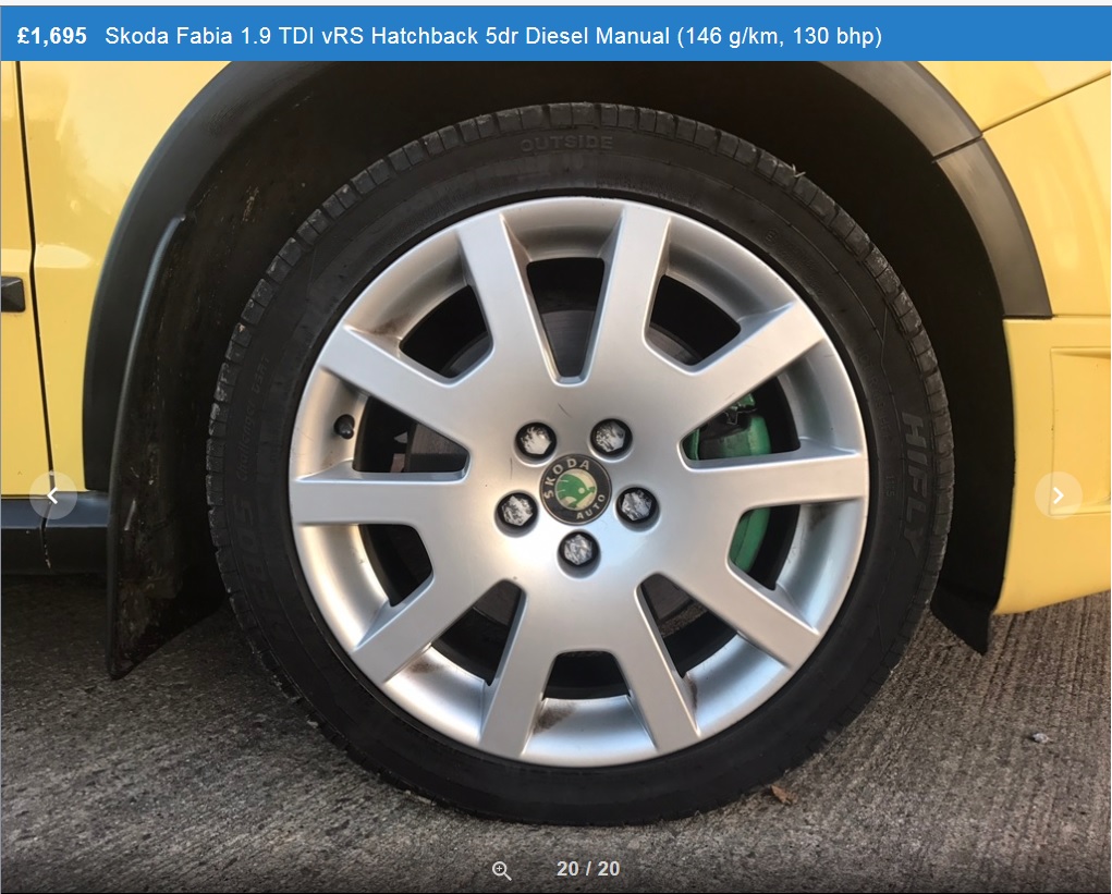

 I am looking at the wheel arches and not the doors - narrow strip of black, almost like golf GTI plastic arch extensions or something off a Fabia Scout.
Ahh I didn't even notice those... Somehow!?
I know what you mean yes, I would wonder if they were put on to hide any wheel arch rust... As those are notorious places for the first few spots of rust to appear...
