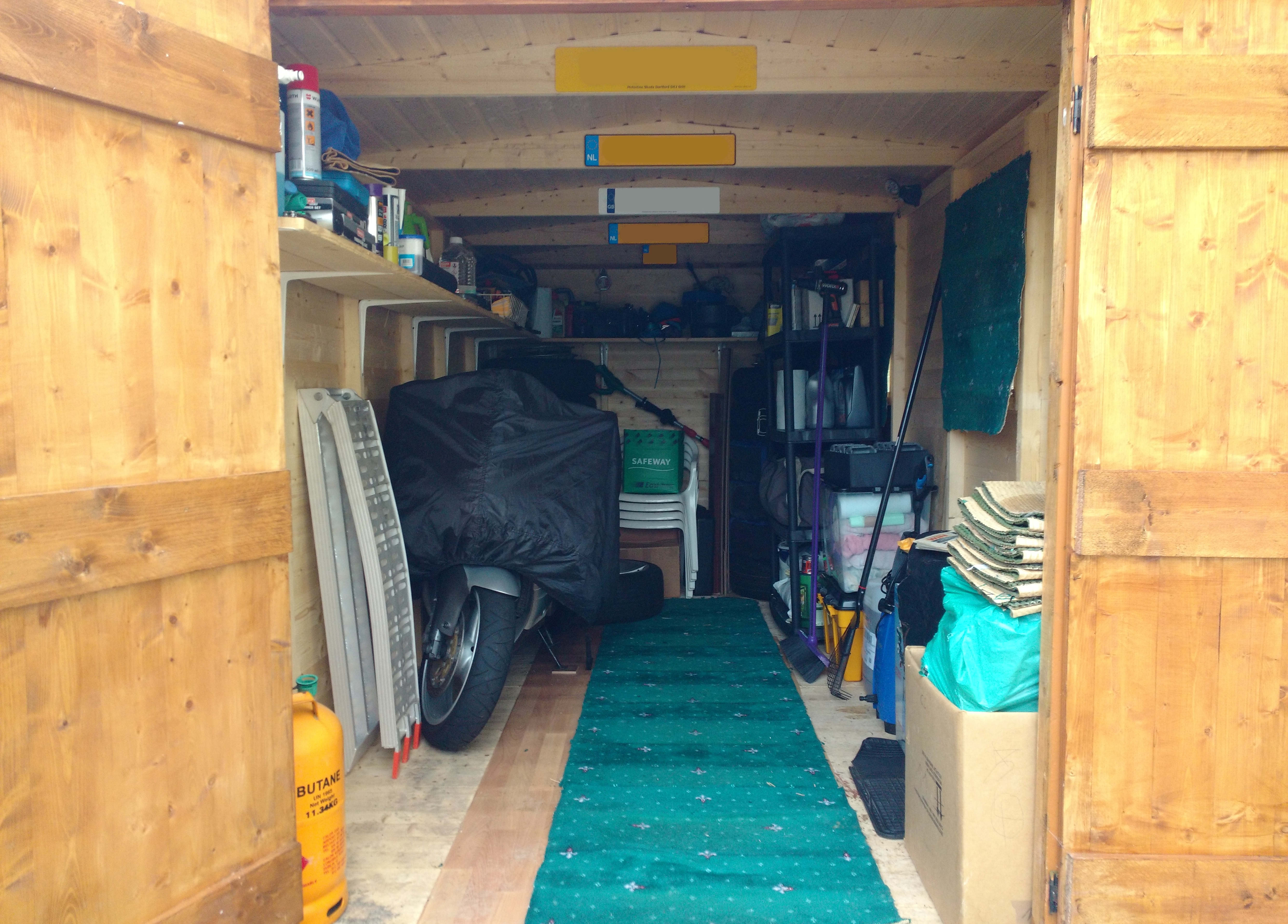

Gixxer is pretty light and load spread over 3 points of contact on side stand or on a paddock stand, as shed is heavy duty, I wouldn't be too worried about 50kg ish per point beyond something to spread the load off an individual floor board (like another board going opposite way to them. The likes of OSB mentioned about though is the best idea and far better than steel to both spread and soak. I just use a ceramic tile on mine ontop of some lino and have it positioned over on of the board which is supported underneath with one of the sheds joists and directly below that is one of the 4x4's the shed sits on. My new plan for when that shed reaches the end of it's time is to replace it with a 20ft ISO :D
7x14ft
