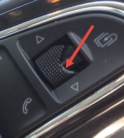

MFD Scroll Wheel on the steering broken
Hi All, MFD scroll wheel in my octavia is broken. I am not heavy handed. The plastic around the wheel seems brittle and didn't withstand normal use. Skoda Australia doesn't want to cover this under warranty. Dealer quoted 750 AUD to replace it. This is outrageous considering the car is only two years old. Has anyone had similar issue with the scroll wheel? Thanks.
I think this is the right part number (but you should check) and should be about £100
5E0 919 719A
How confident you are to change it (Bearing in mind the airbag) is up to you or your trusted mechanic though.

you simply remove the airbag and then undo the electrical multiplug for the switches.
the piano black trim that houses the switches simply pulls off and once removed the switches are screwed to the trim.
as for part nos, if you have dsg you need  5E0 919 719B if you dont have dsg you can use either  5E0 919 719A or  5E0 919 719B.
the job is simple but if you are unsure it takes 30 mins maximum to remove,swap trim and refit so wont cost a lot.
