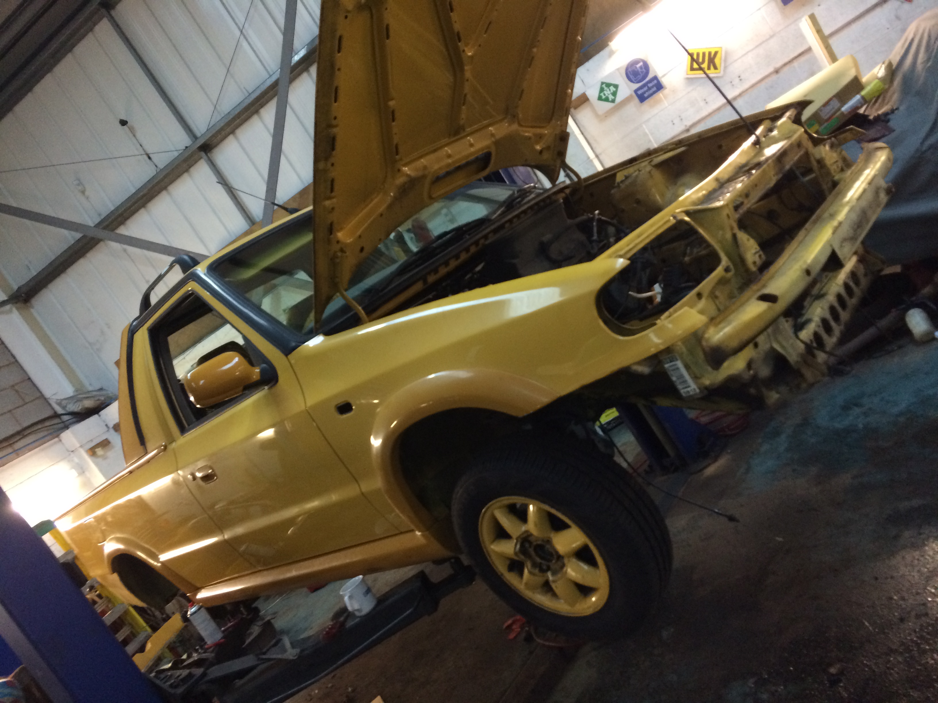

I am after any advice on lowering springs and shocks, also any advice on fitting polo gti engine (for Ecu and electrics side of things as it is pretty much in the pick up now!) and also I was looking to use the polo gti brakes!

Yea it's having a avy engine code, my brothers garage is doing the lot! Found these discs

using the ecu and pedal switch from the polo but not to sure on how much work there is in that!IMG_1778.JPG
Those discs look like the correct ones.
I've never done that so not too sure either.
Another way to do it though would be to fit a 1.4 16v AFH head onto the 1.6 16v AVY bottom end.
That way you can use the wiring from a 1.6 AEE Felicia, cable throttle, 1.4 ecu (fits in place of original ecu) with no splicing to do as you can match it with VCDS so you can use the original Skoda key.
