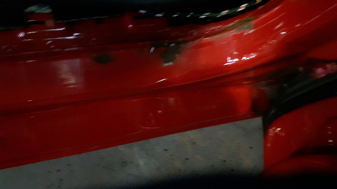

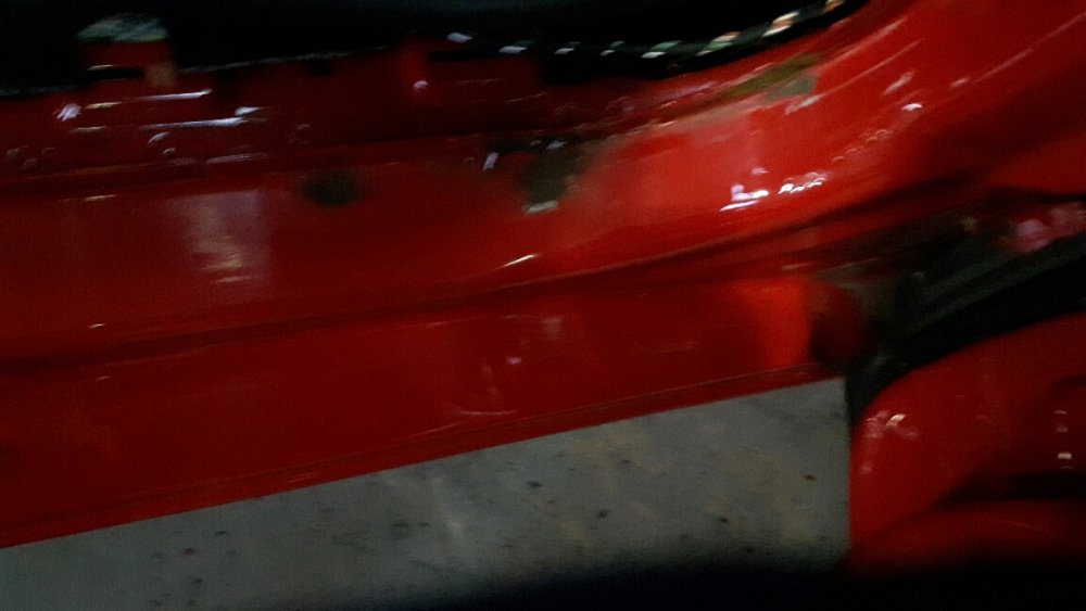

I bought my Octavia brand-new in October 2009 and fitted sill protectors around, last week the top drivers side became loose so I removed it only to find corrosion underneath, Skoda are not interested as usual about a warranty claim, I got a price from a recommended body shop who also advised taking them all off, they were right, corrosion under all protectors, it's costing £720 to put right. My advice don't fit them and if you have remove them, £720 sounds alloy but cheaper than new sills.

The Skoda mud flaps are ok, the sill protectors were made by Skoda and they are fixed by preset 3M stick pads.
Skoda are refusing to pay, they say the corrosion is caused by an external influence, yes it is their sill protectors, there is no seal around the outside therefore water gets trapped. I have a friend with the same age Octavia with no sill protectors and no rust. The customer services lady was just talking rubbish thinking I will forget it, they even say it could be caused by neglect or lack of maintenance, how can you maintain a fixed non removable part.

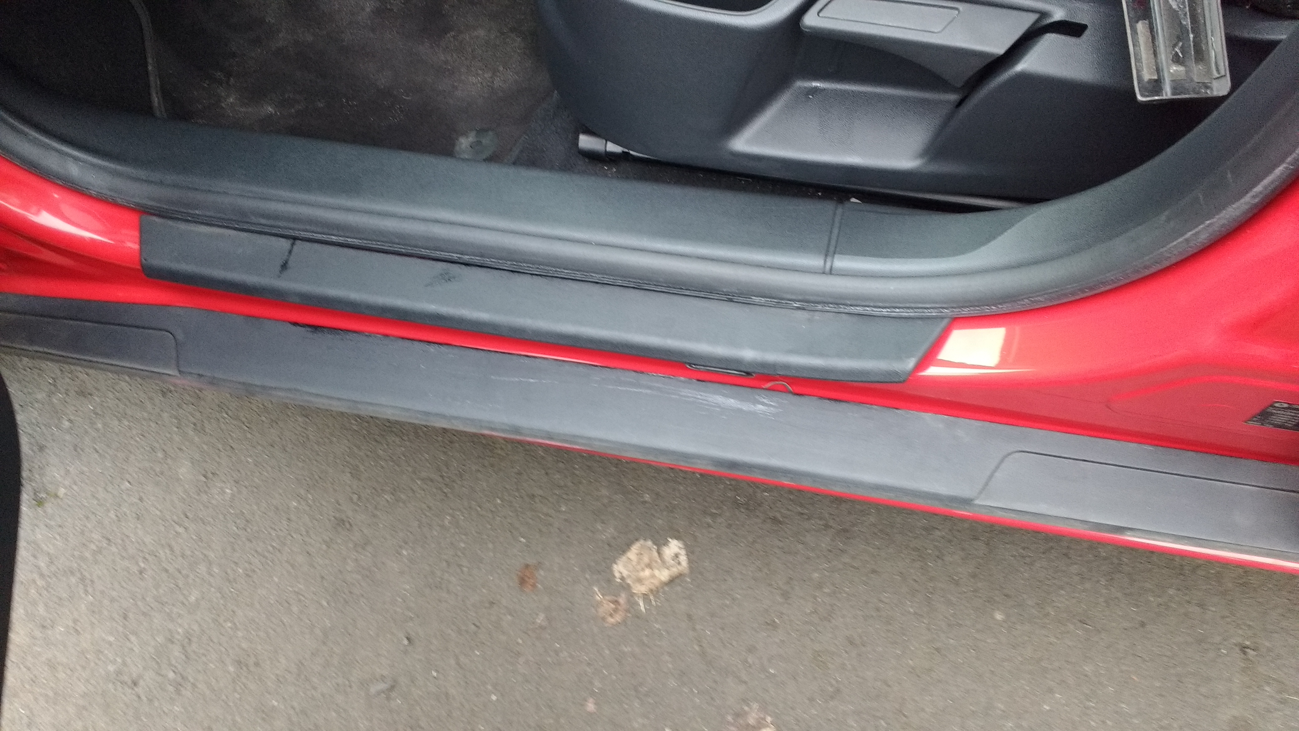

They look slightly different to mine, mine look flush with the sill.  Yours look thicker.
I fitted them two weeks after buying the car brand new and from the dealer, I'm an electrical maintenance engineer for the NHS so fitting these are simple. They are durable plastic and we're in the skoda accessories brochure

I haven't said they were to protect the sills from rust. They were advertised as sill protectors that protect the sills from scratching that could in time turn to rust. They have caused rust because they have trapped water, therefore they have by design damaged my vehicle and are not fit for purpose
As far as I see this is that Skoda designed the protectors and should have either designed them to not let water underneath buy installing a rubber seal around the outside edge, or protect the sills themselves with enough anti-corrosion protection to stop the rust IF protectors are fitted, either way non or this is not my fault.

If the original sills were undamaged then I can't see how stick on protectors would cause rust. Even if water is trapped on the surface, the paint should stop it making contact with the bare metal which would cause rusting. If I placed unbroken painted metal in water, I would expect it to remain rust free for its lifetime unless it was rusting from the inside or had a break in the paint. The only other thing I can think of is movement over time of the protector has worn through the paint layer, allowing water in to the bare metal?
