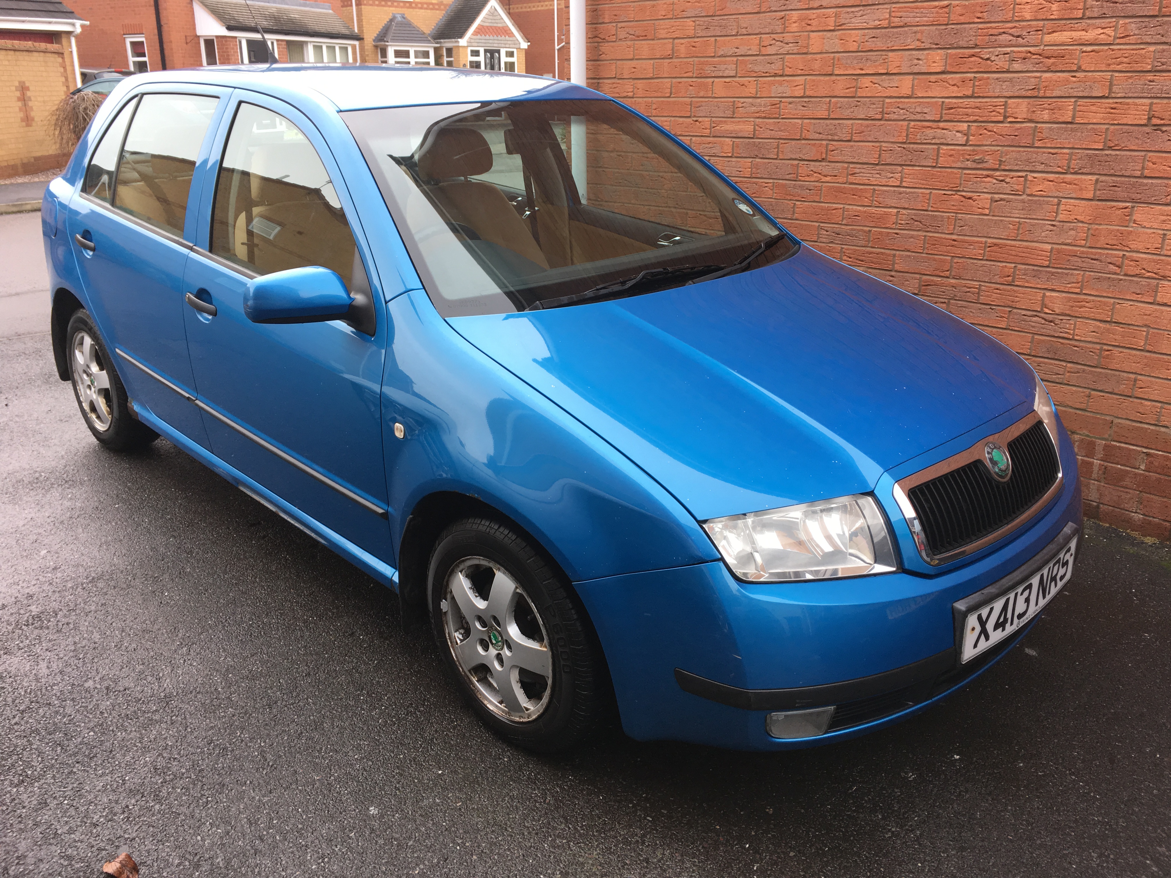

Picked this one up recently just as a runaround while I do some big jobs on my Mk4 R32 Golf!...and actually starting to like the little Skoda!

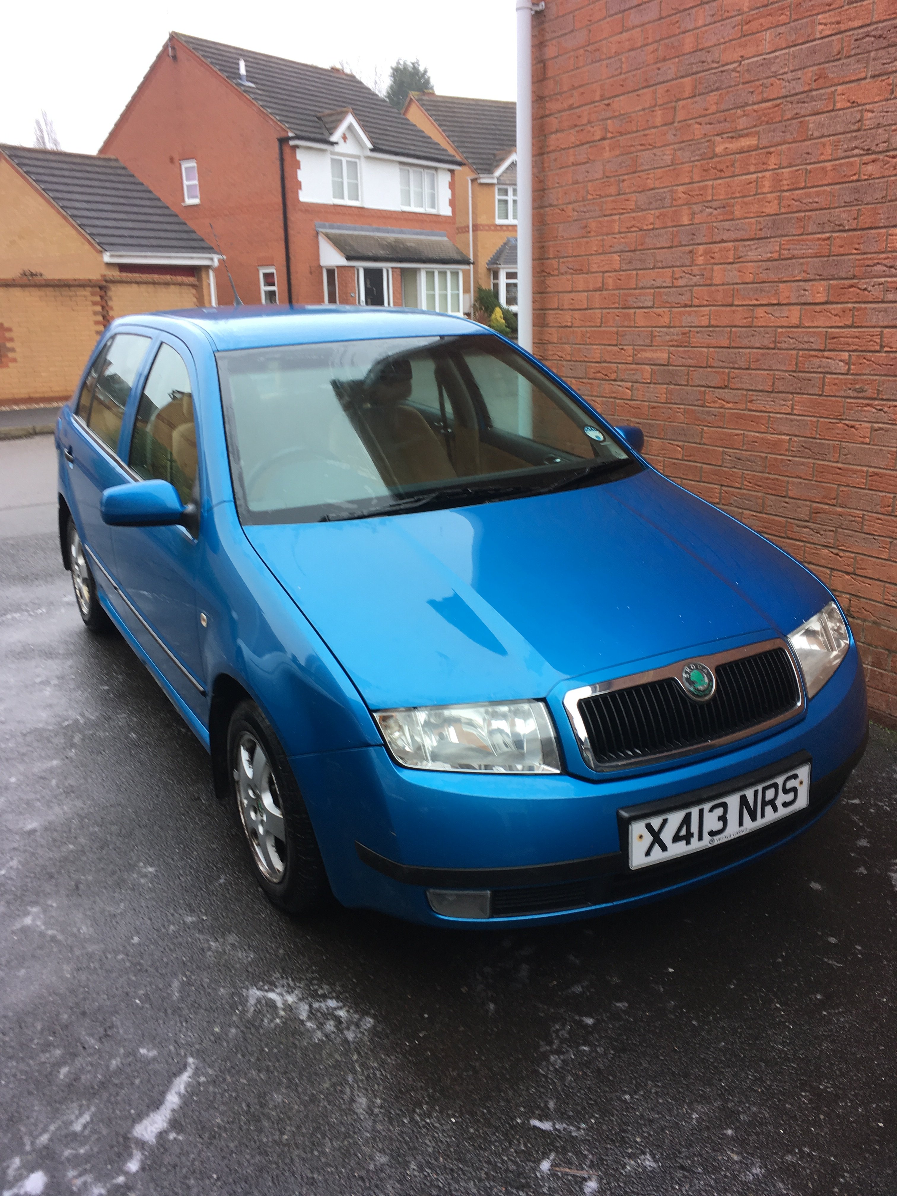

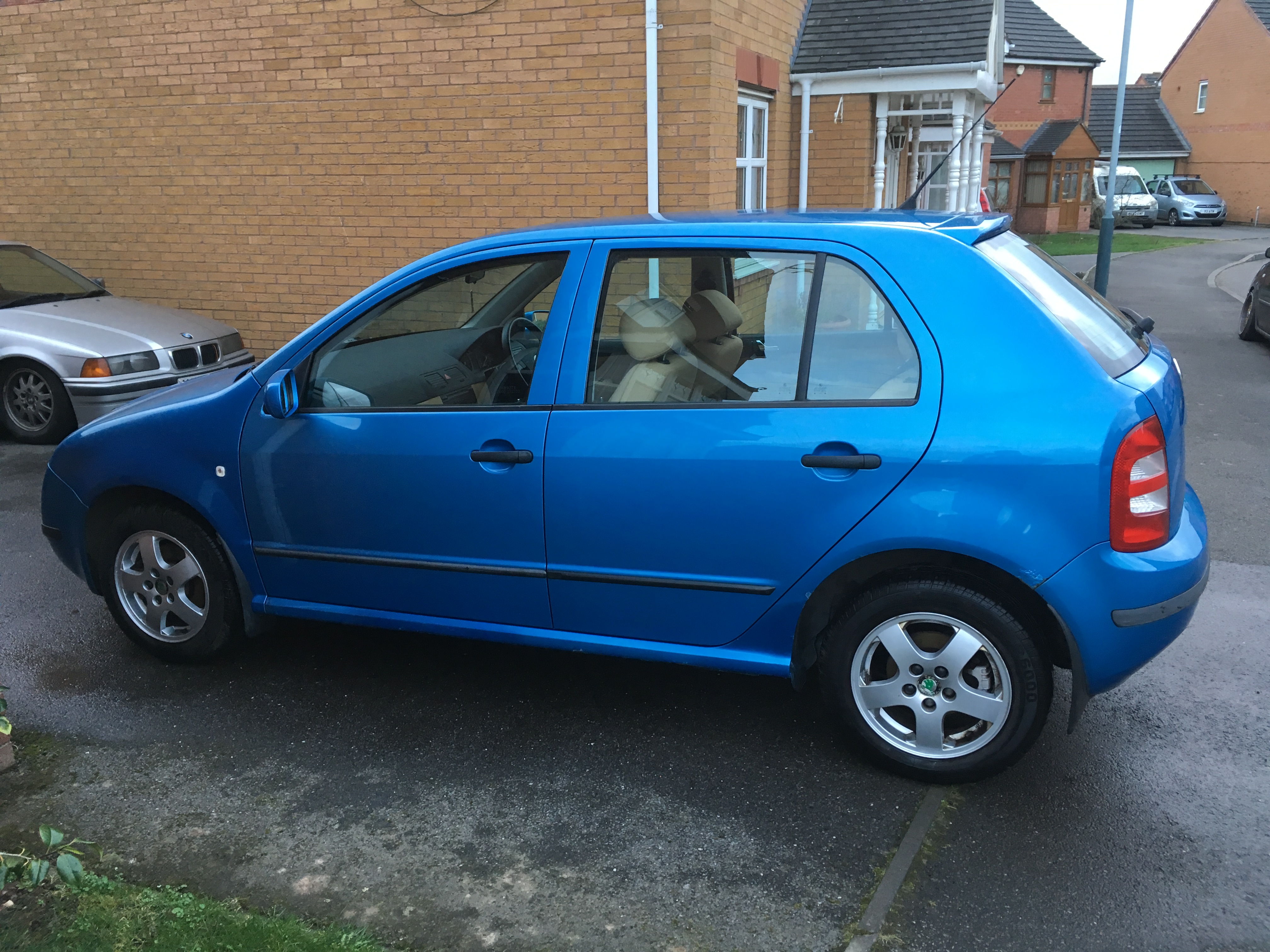

£300 bought me...

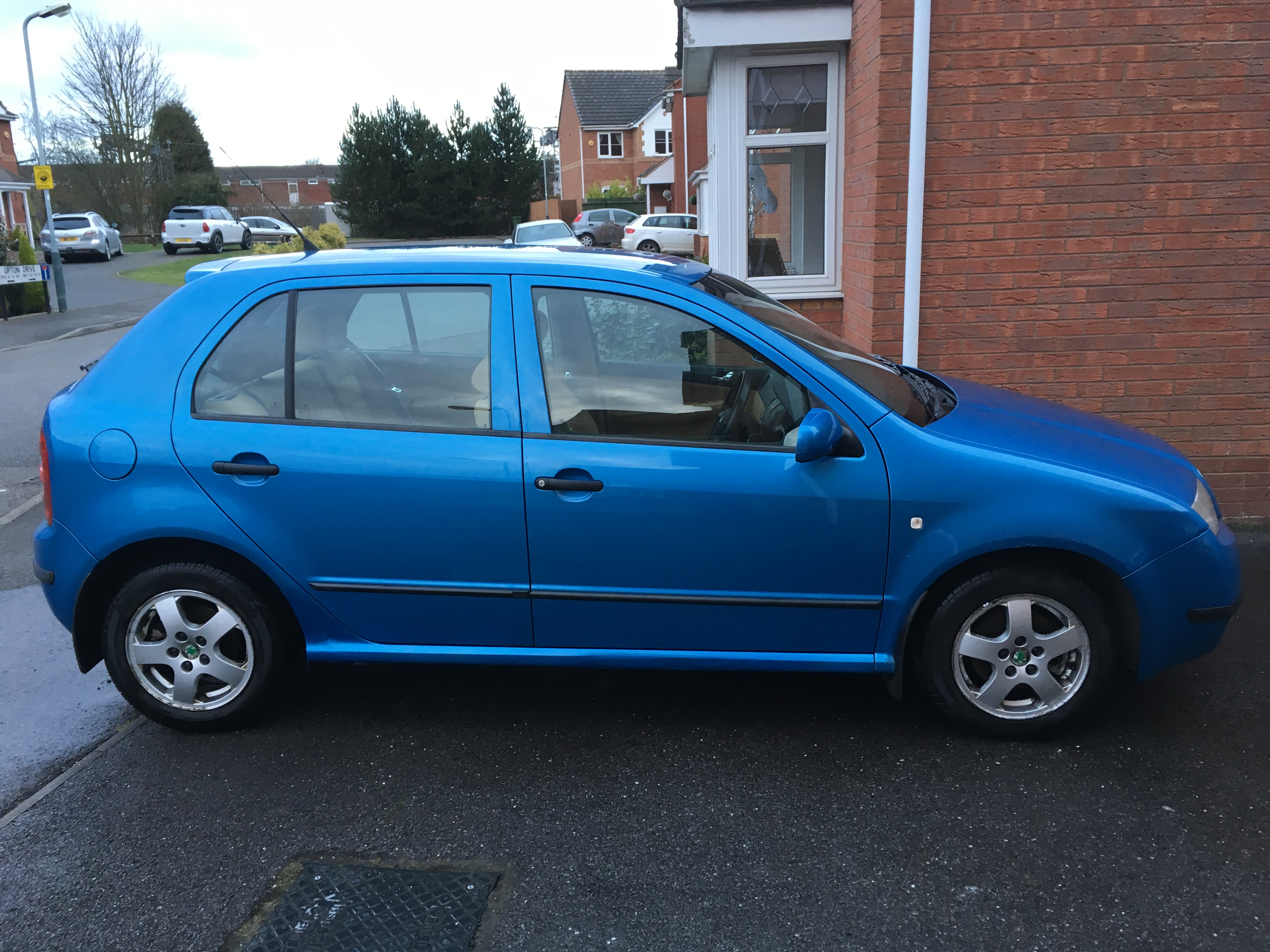

 A 3 Owner, 70,000 mile, 2000 x plate Mk1 Fabia 1.4 16v Elegance, Laguna Blue, heated seats and all the extras...with some service history,MOt till October 2017... all original... and included a full tank of petrol!...Runs and drives great..and everything works!

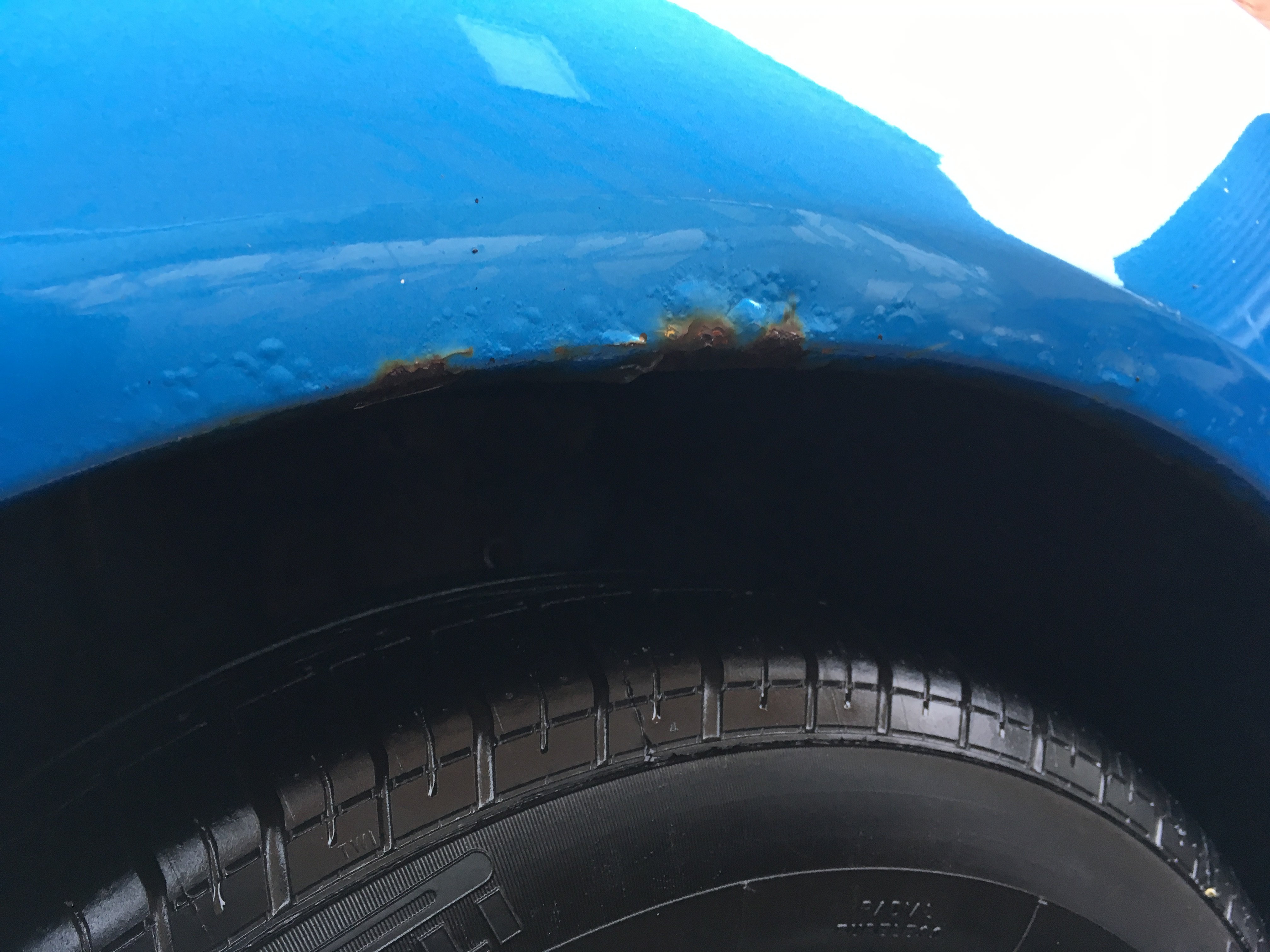

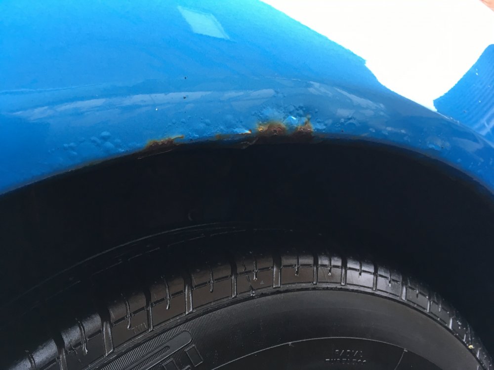

Not bad but has damaged/missing badges, and quite a bit of rust...it appears to have lived on the north coast of Scotland near Aberdeen for some of its life, so affected by the wet climate it seems!

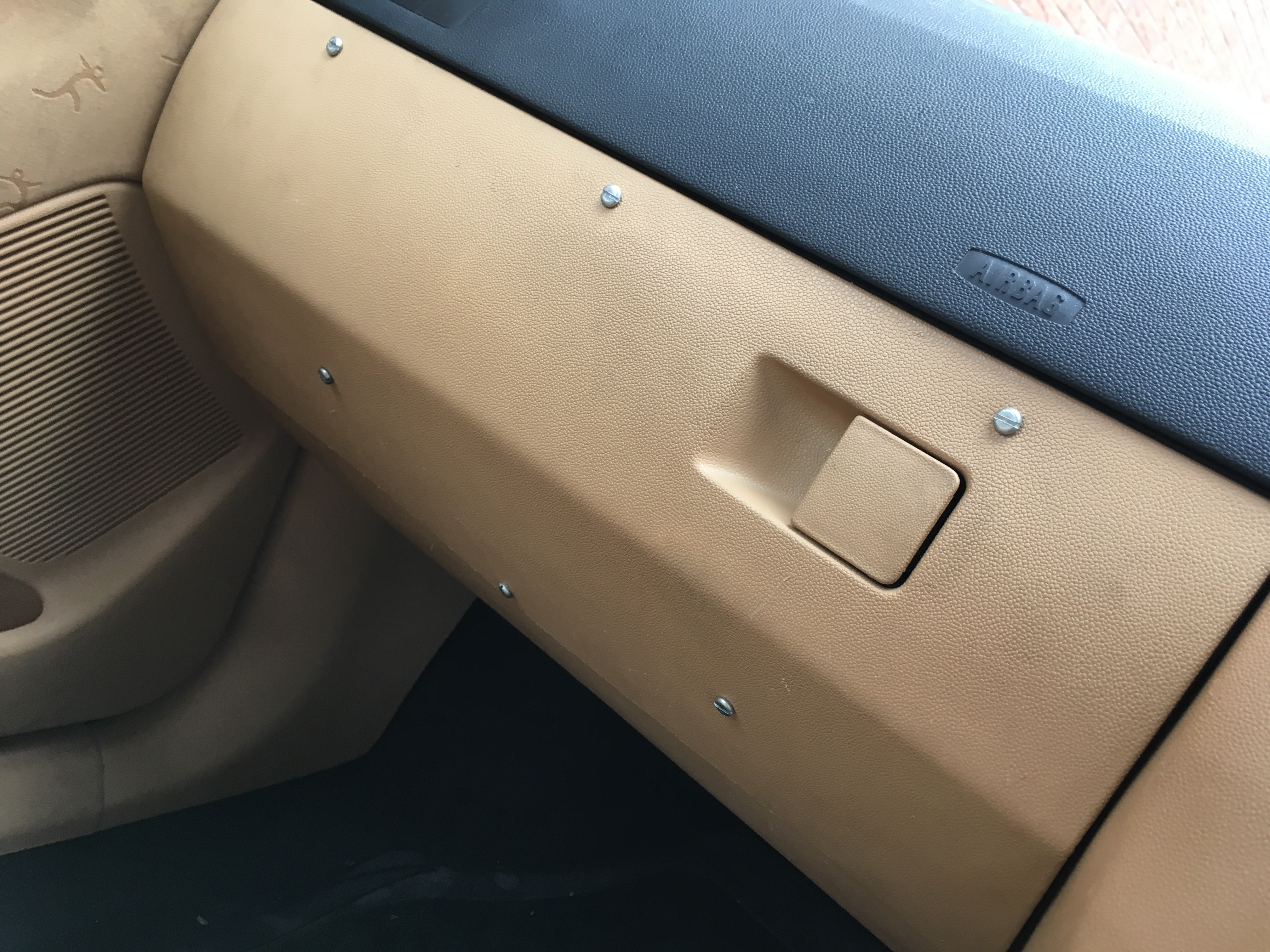

..not to mention the screwed on glovebox front by the previous owner!!
Question is how far do I go?...run as is and scrap when mot runs out??...or spend out doing paint repairs, buying badges and trim etc...as this worth nowhere near as much as a VRS, even though it is a top of the range model..a throwaway car??

That's a real early example, such a shame there are bodywork issues but it's nothing that can't be sorted, obviously at a cost though.
The glovebox is a work of a craftsman lol!
...anybody got a spare beige glovebox door?

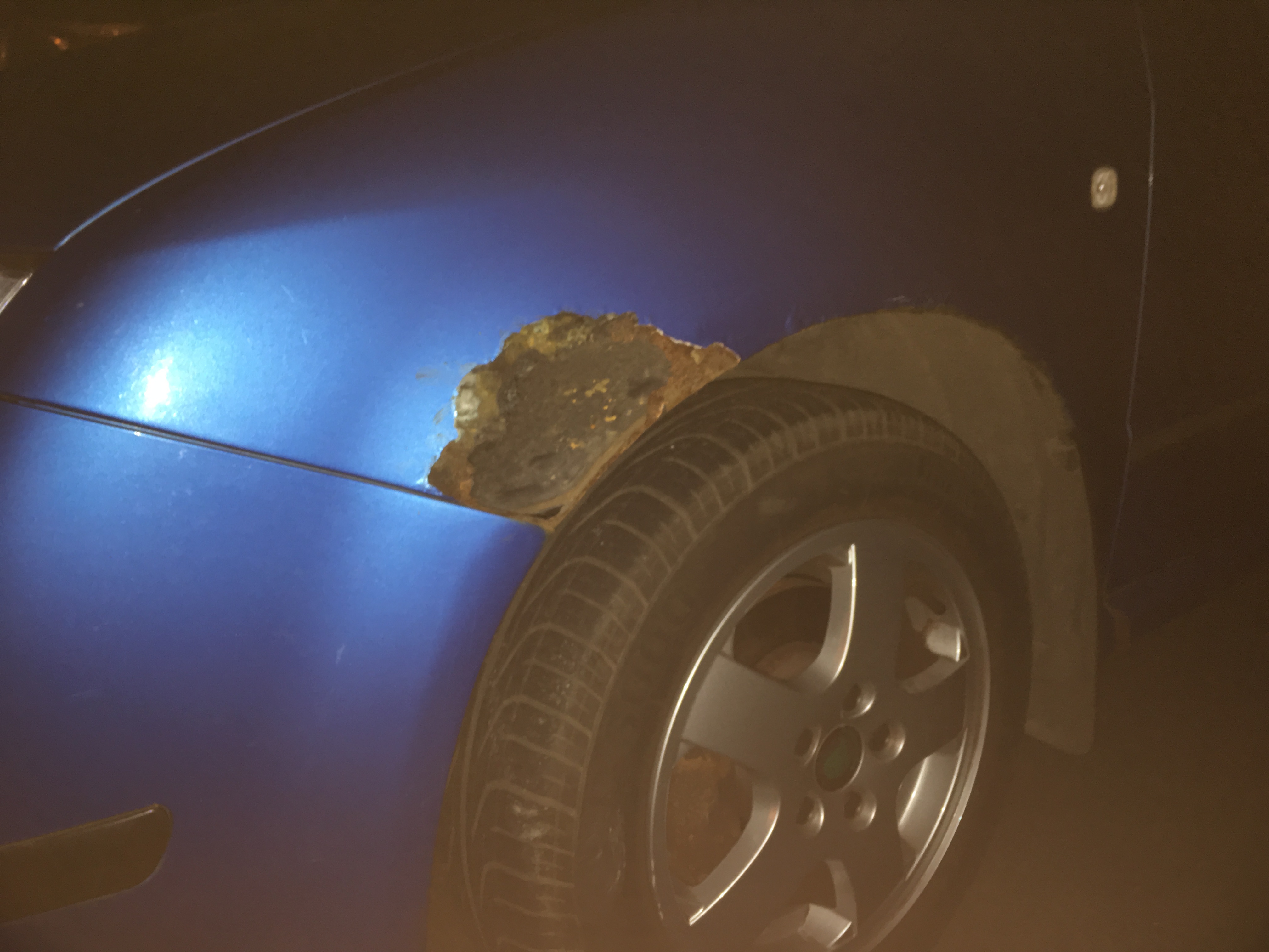

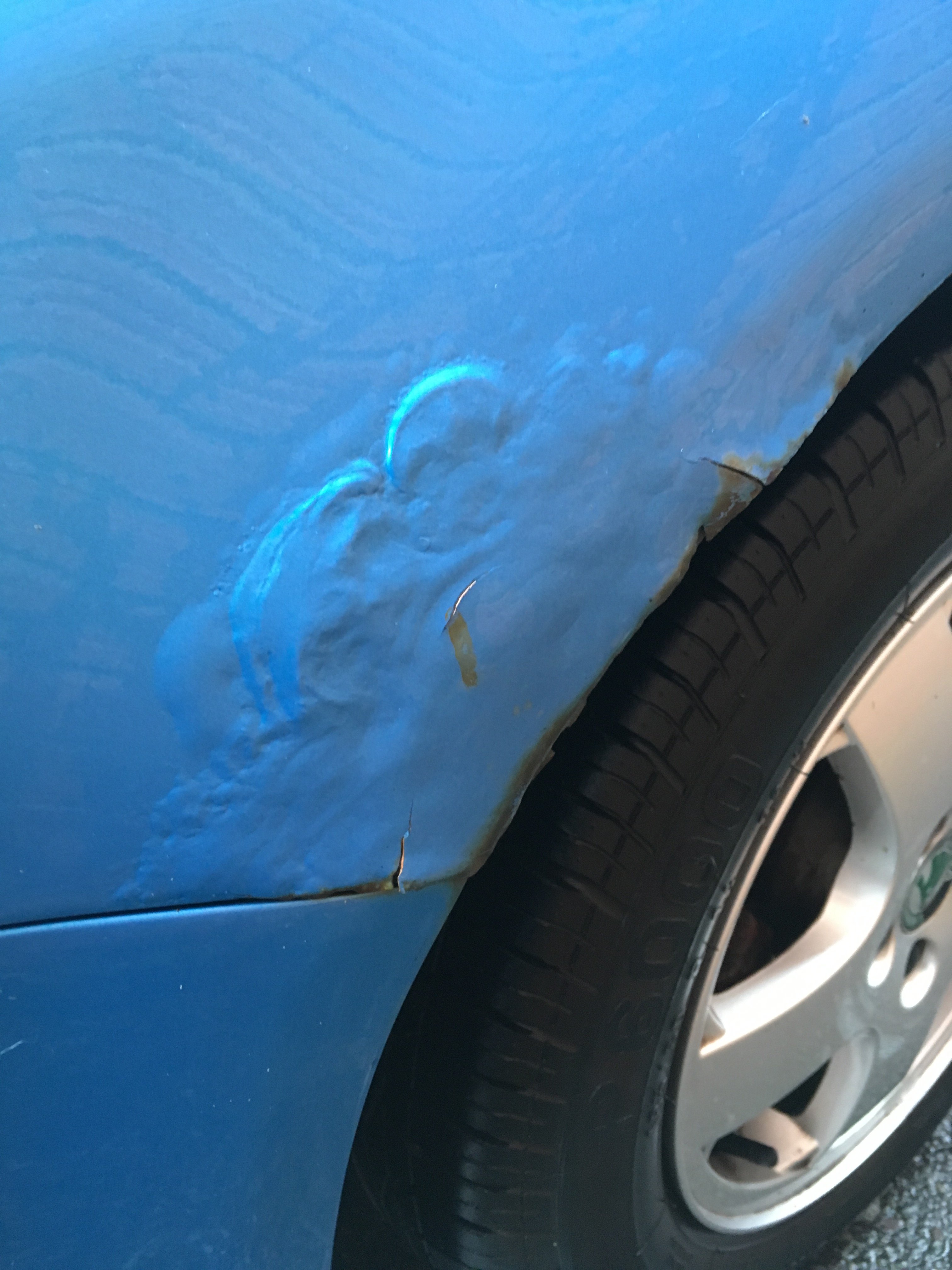

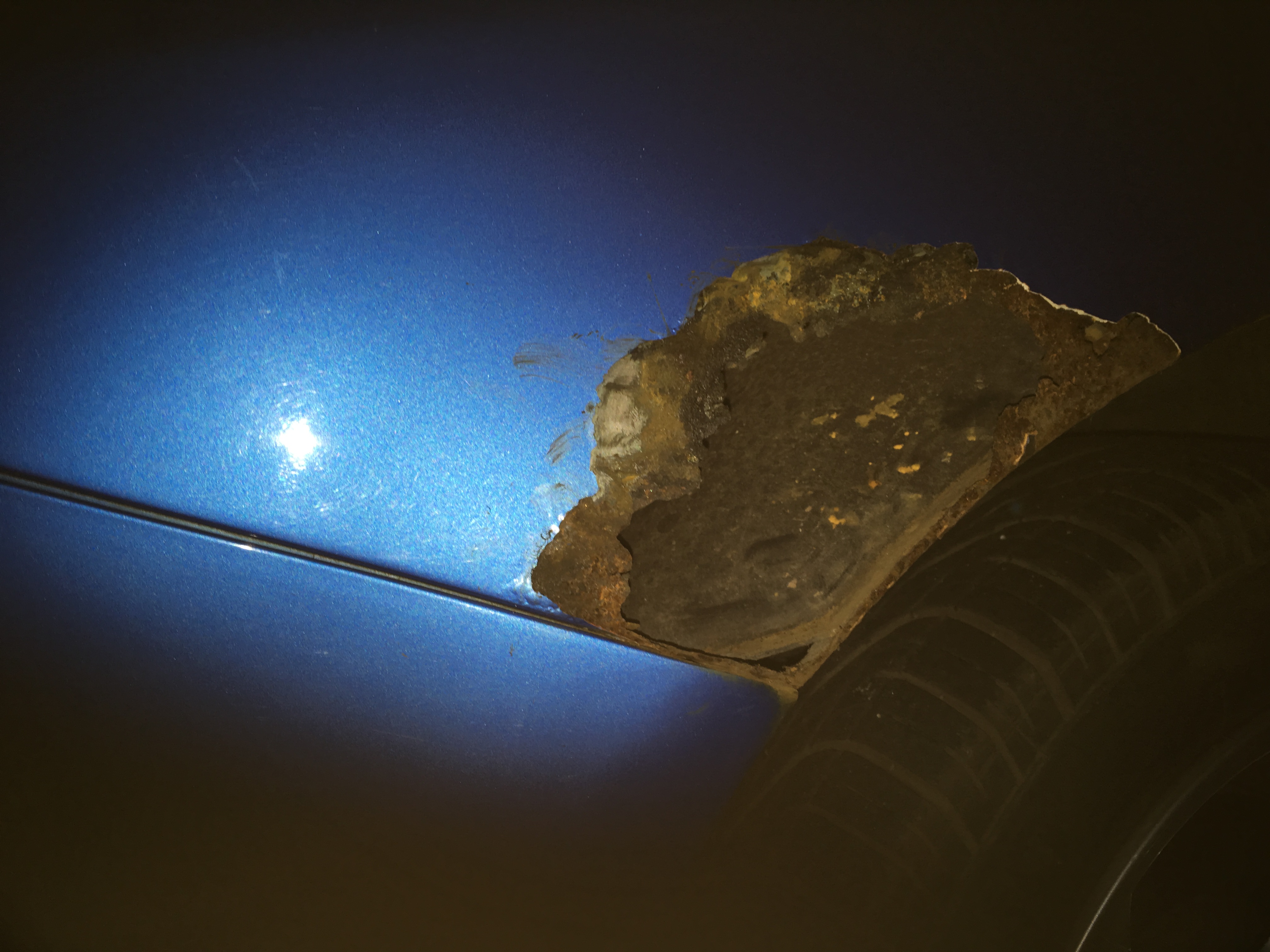

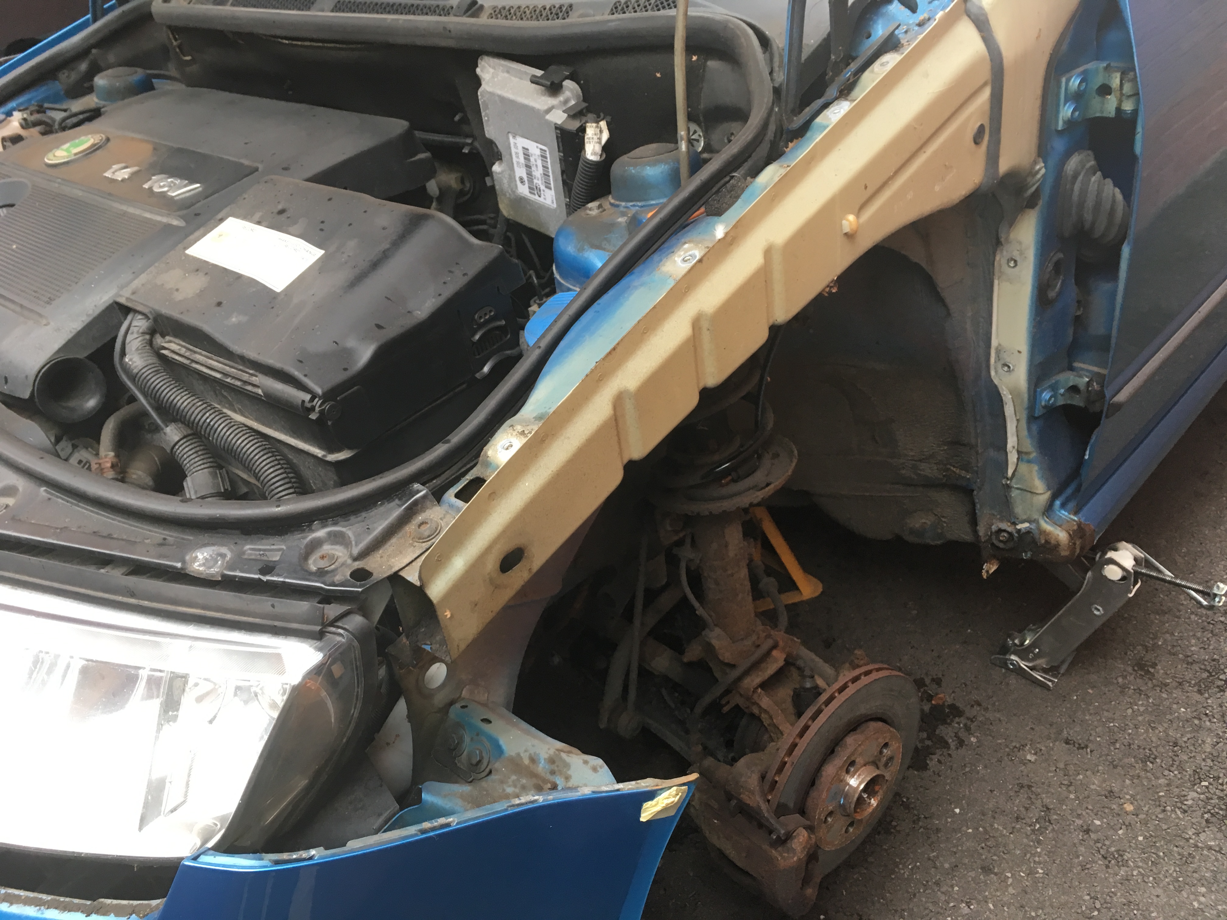

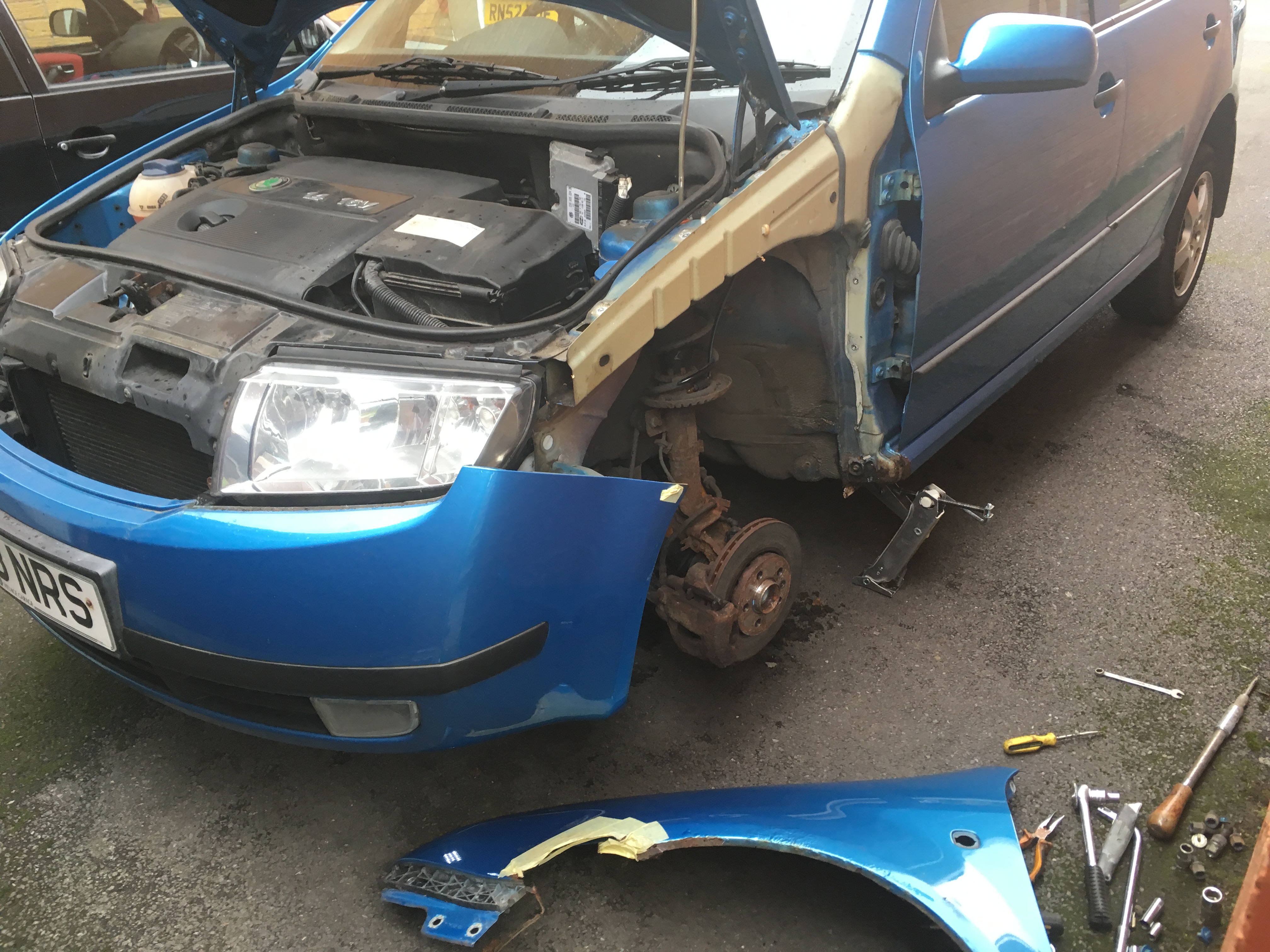

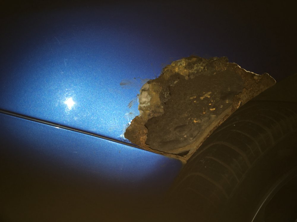

...decided to have a play with the paint issues , worst bit first...big bubble on front wing.....unfortunately I now have a very big hole!!...now need a wing...seems I had been filled in the past!

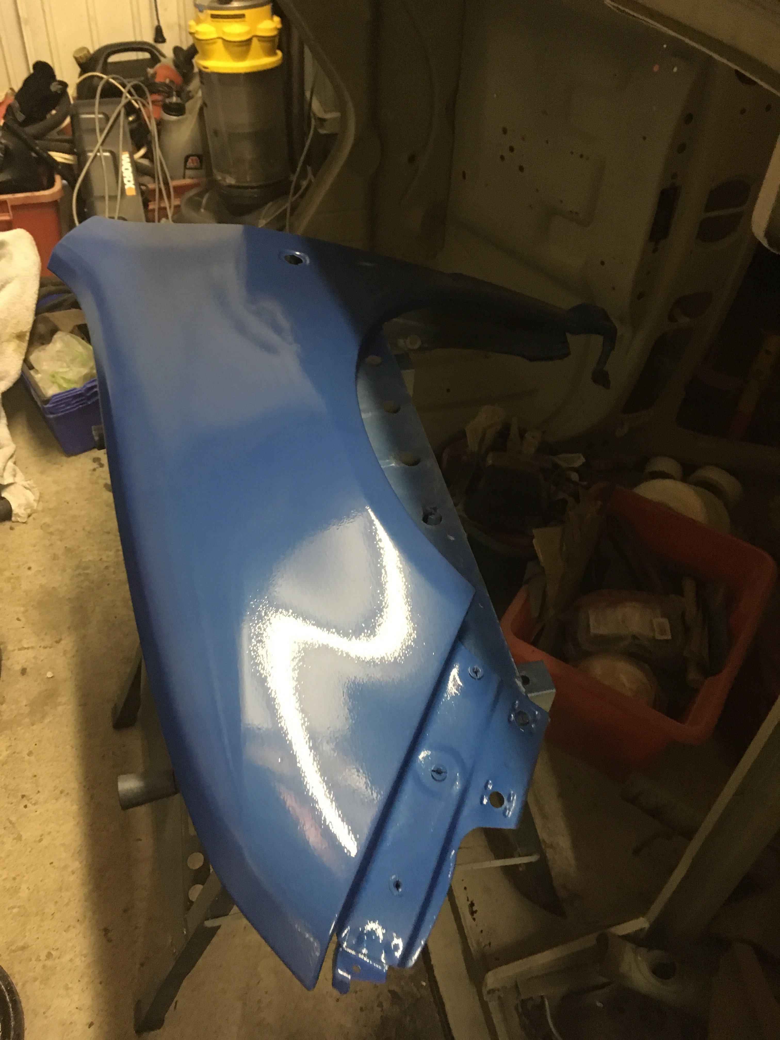

replacement wing, ready to go on!...

...unfortunately as its dried I've had the dreaded crinkling paint reaction!!...the wing had been repainted previously, and that paint doesn't like mine!...well the wing will have to go on for the moment, can be repainted on the car at a later date...if I have the car that long!

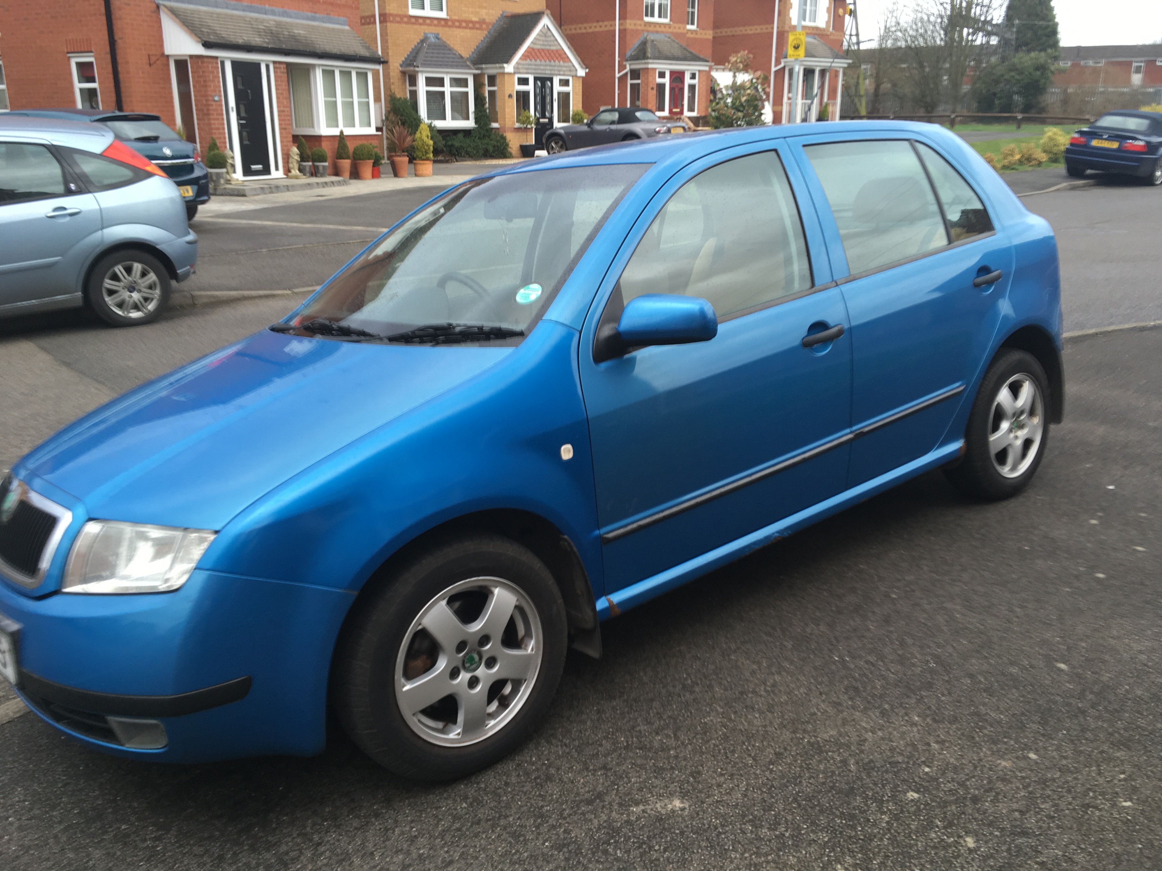

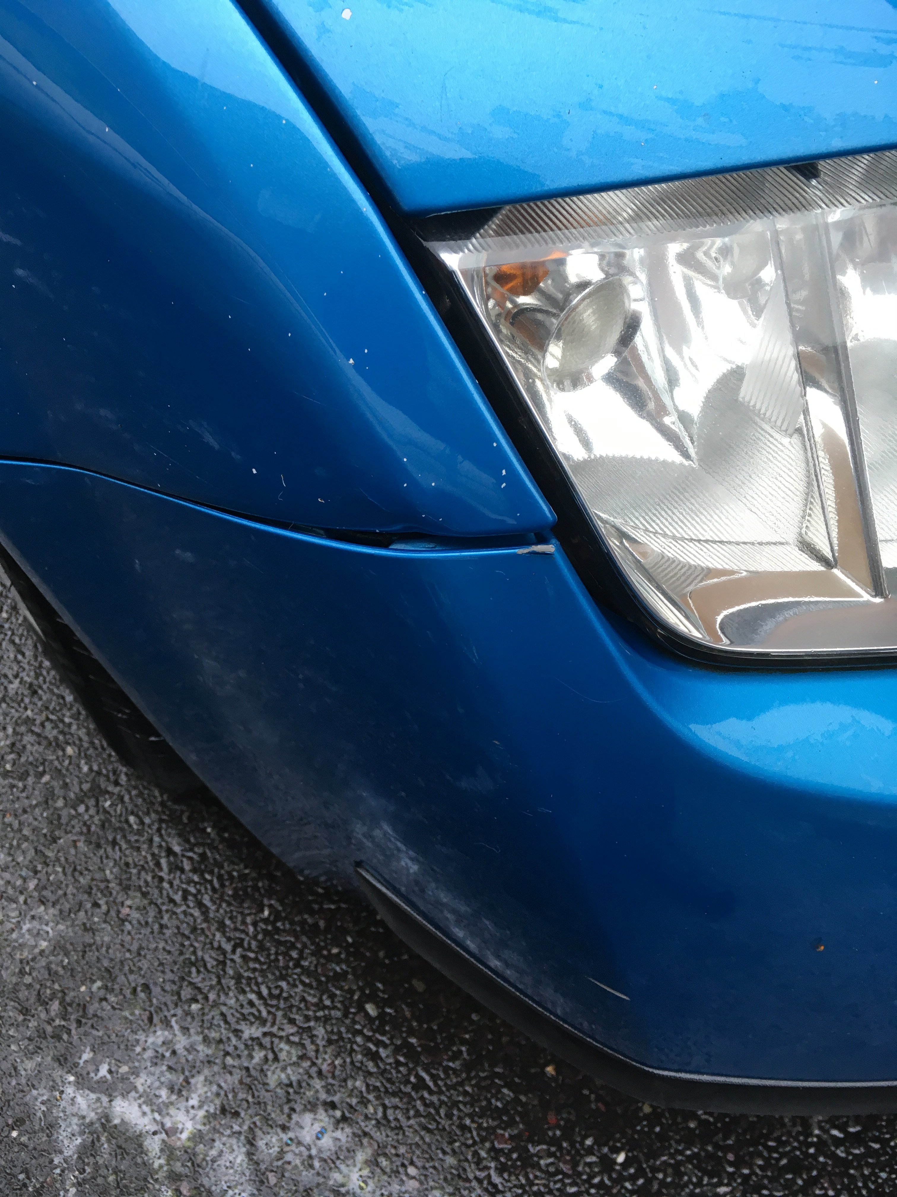

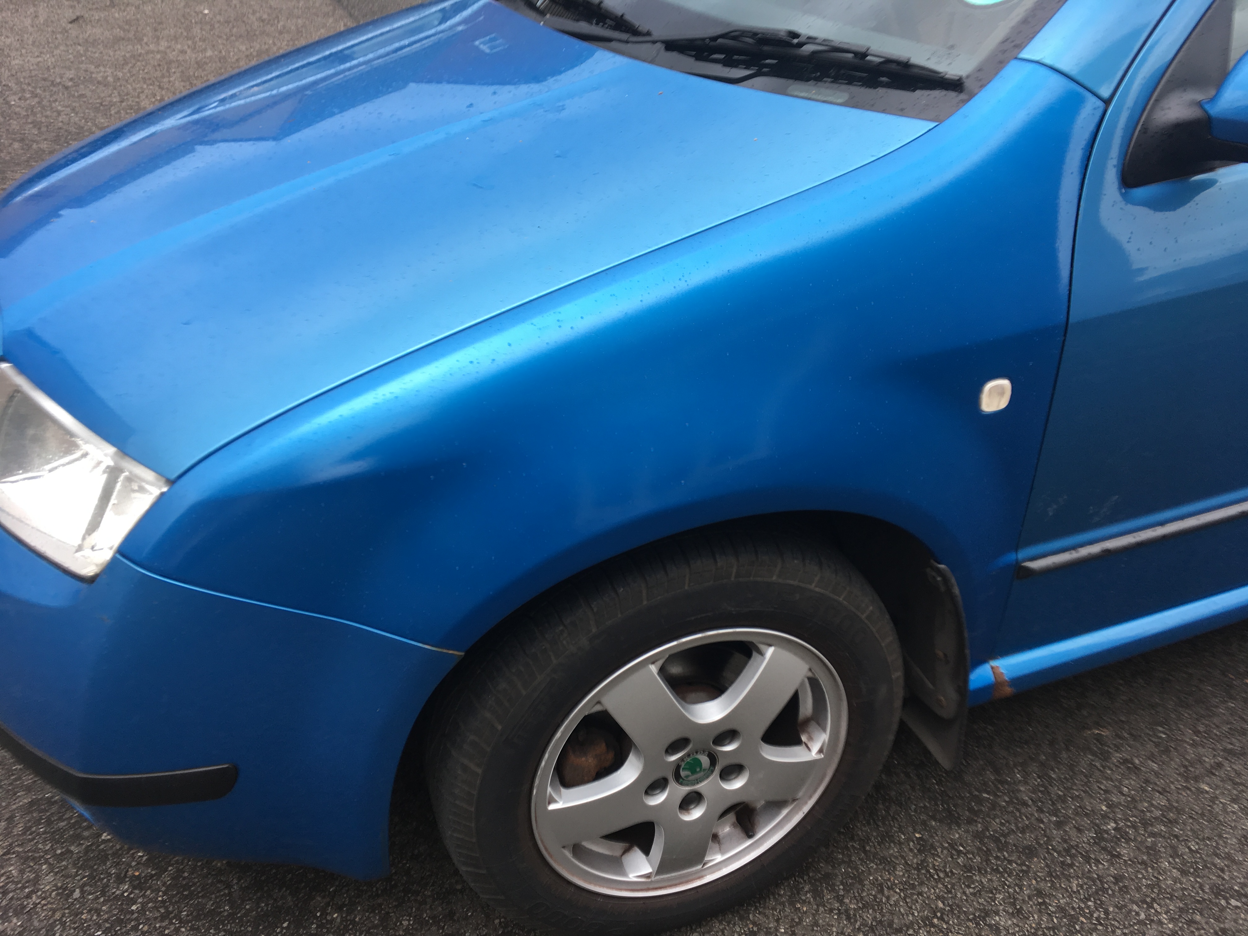

After a repaint and frantic 3 hours to remove old and refit new, wing is on unfortunately paint shade from local bodyshop is off by quite a bit :-(

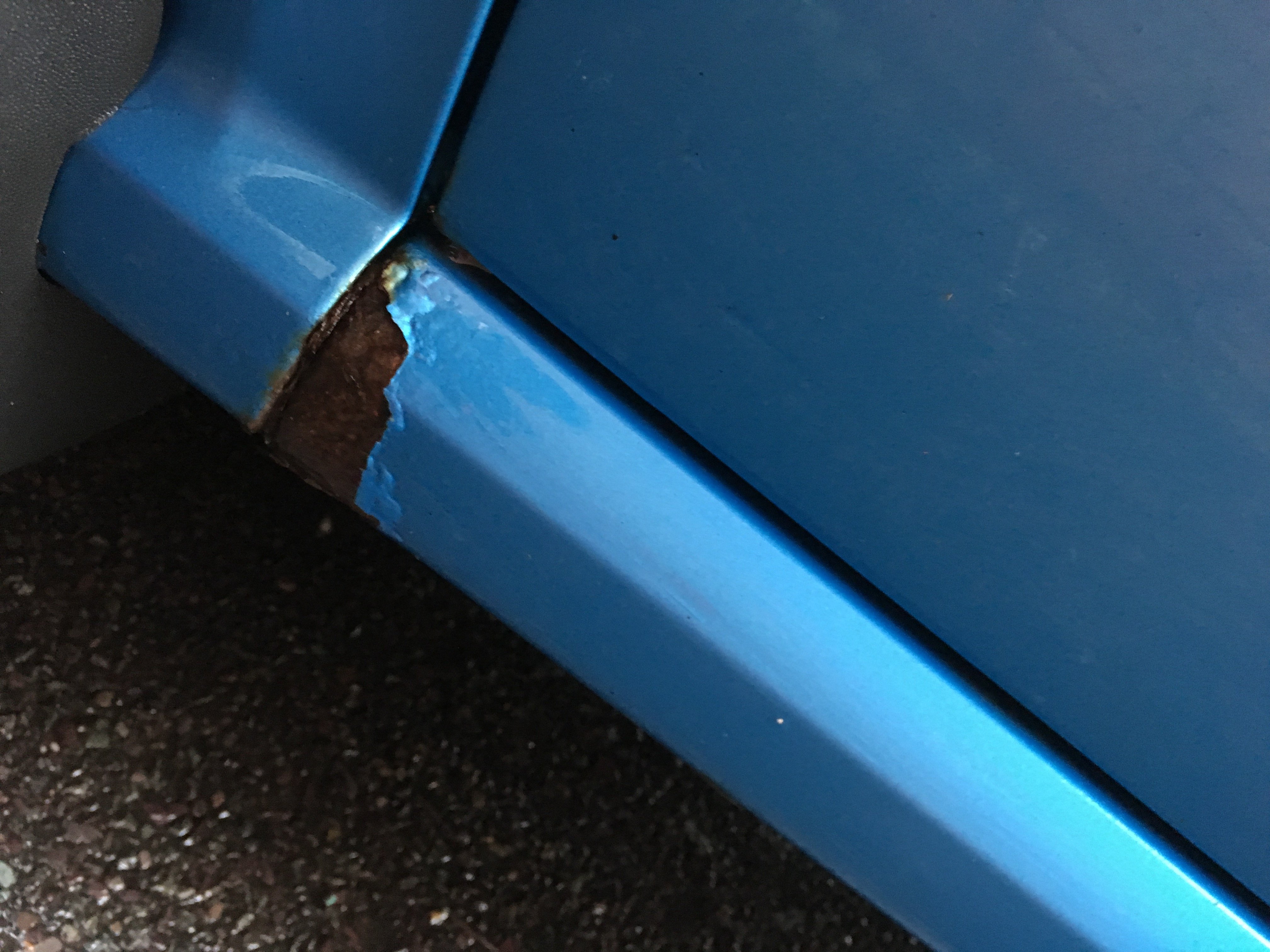

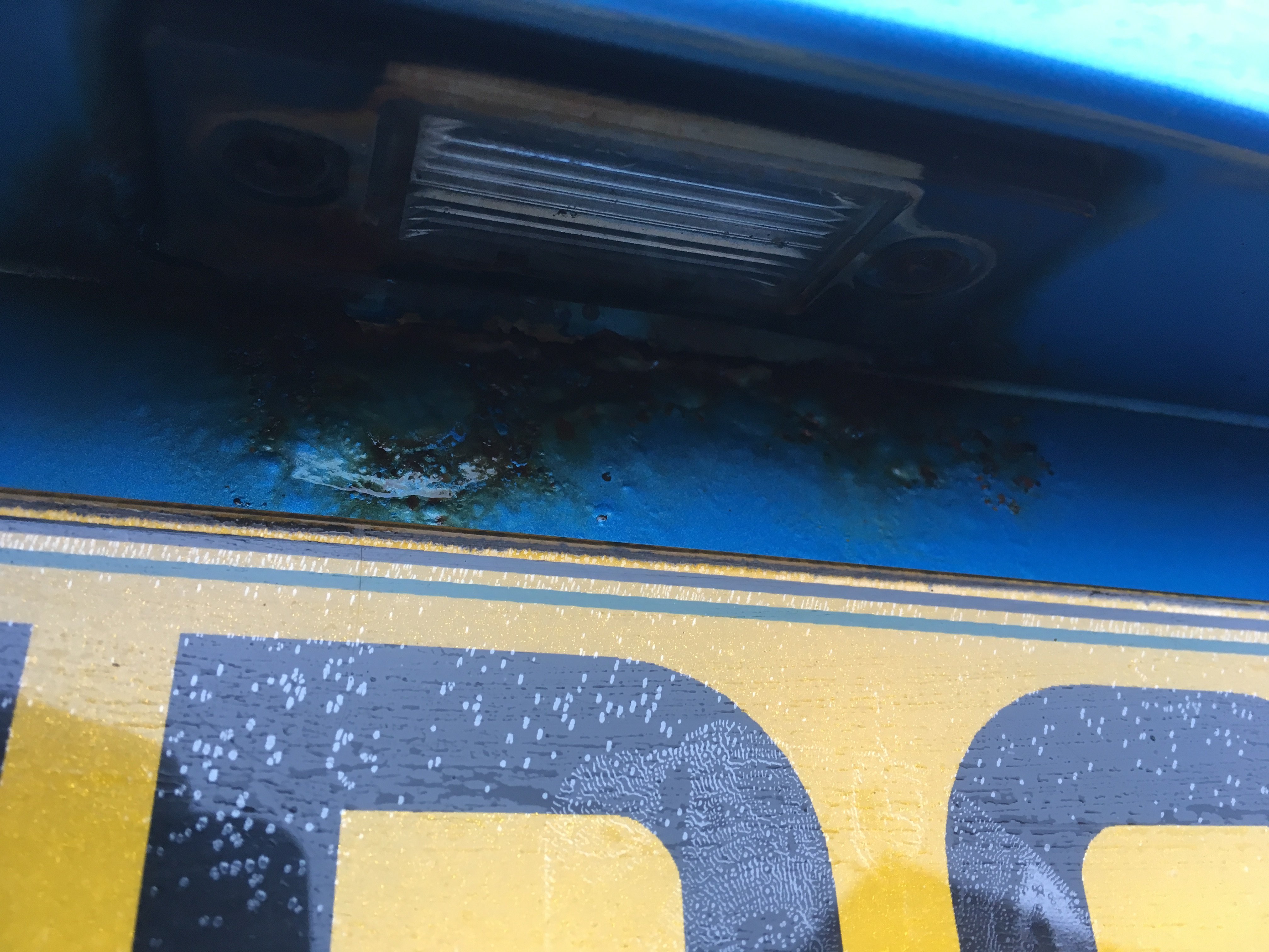

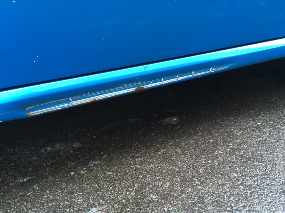

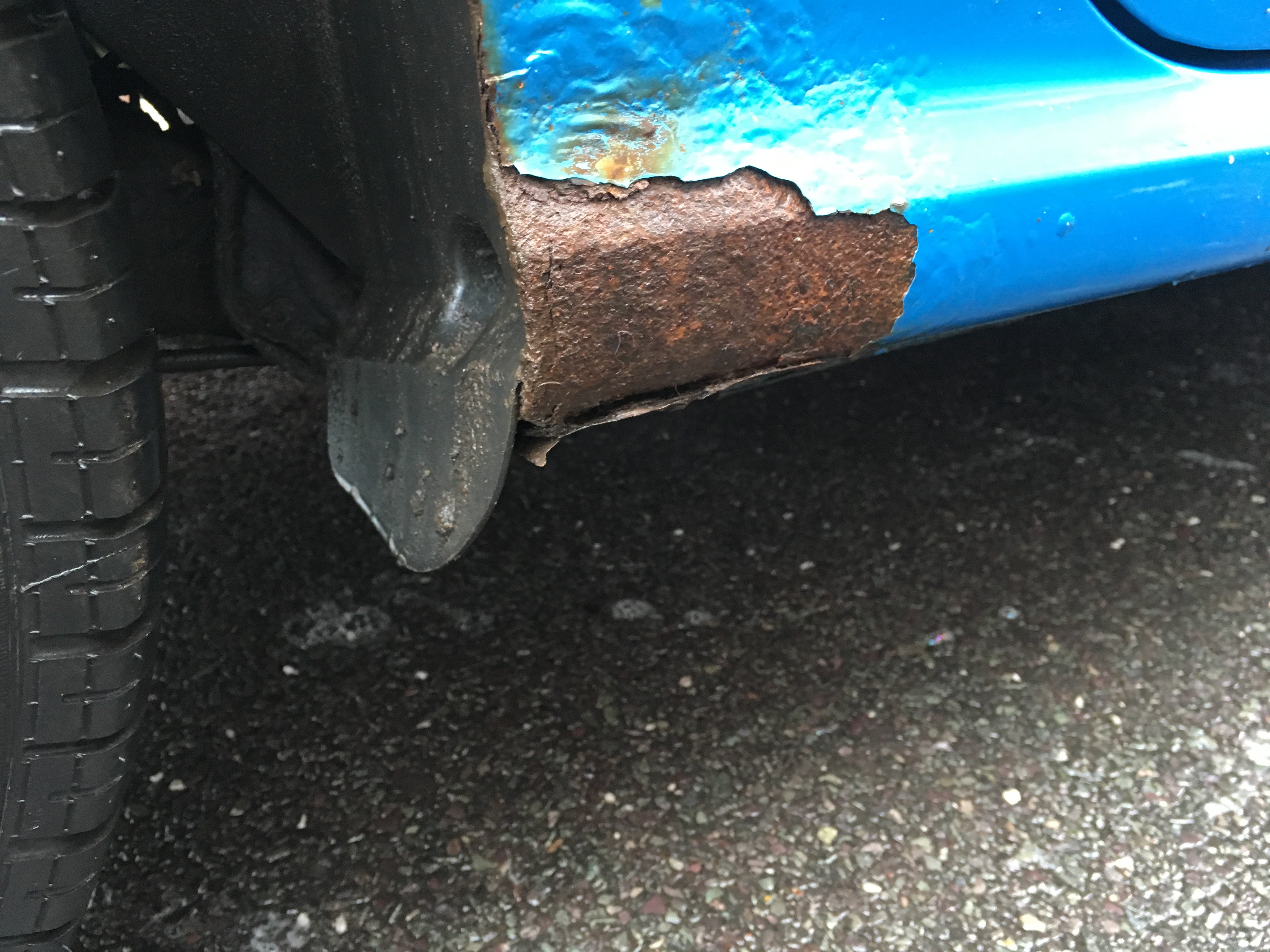

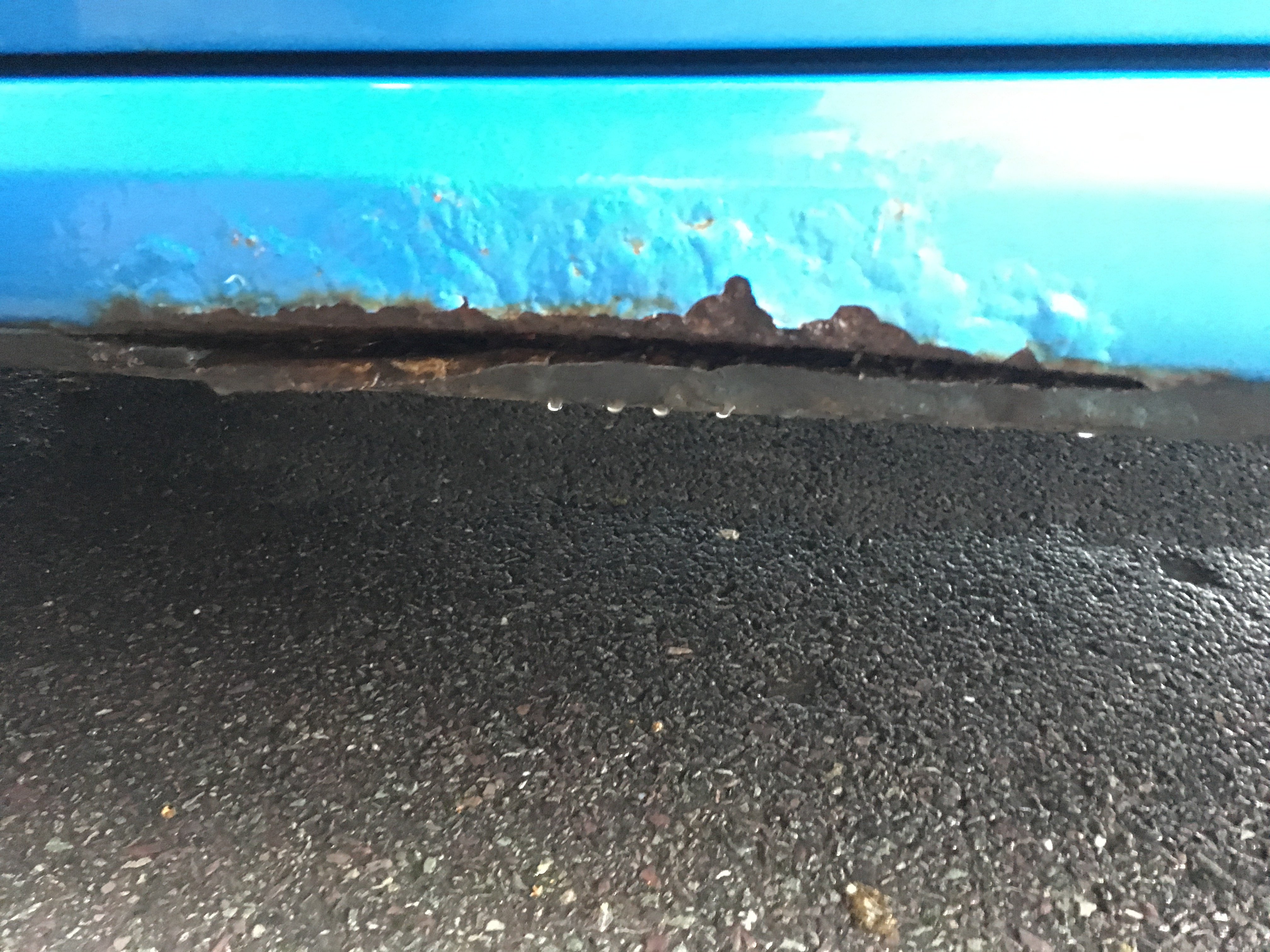

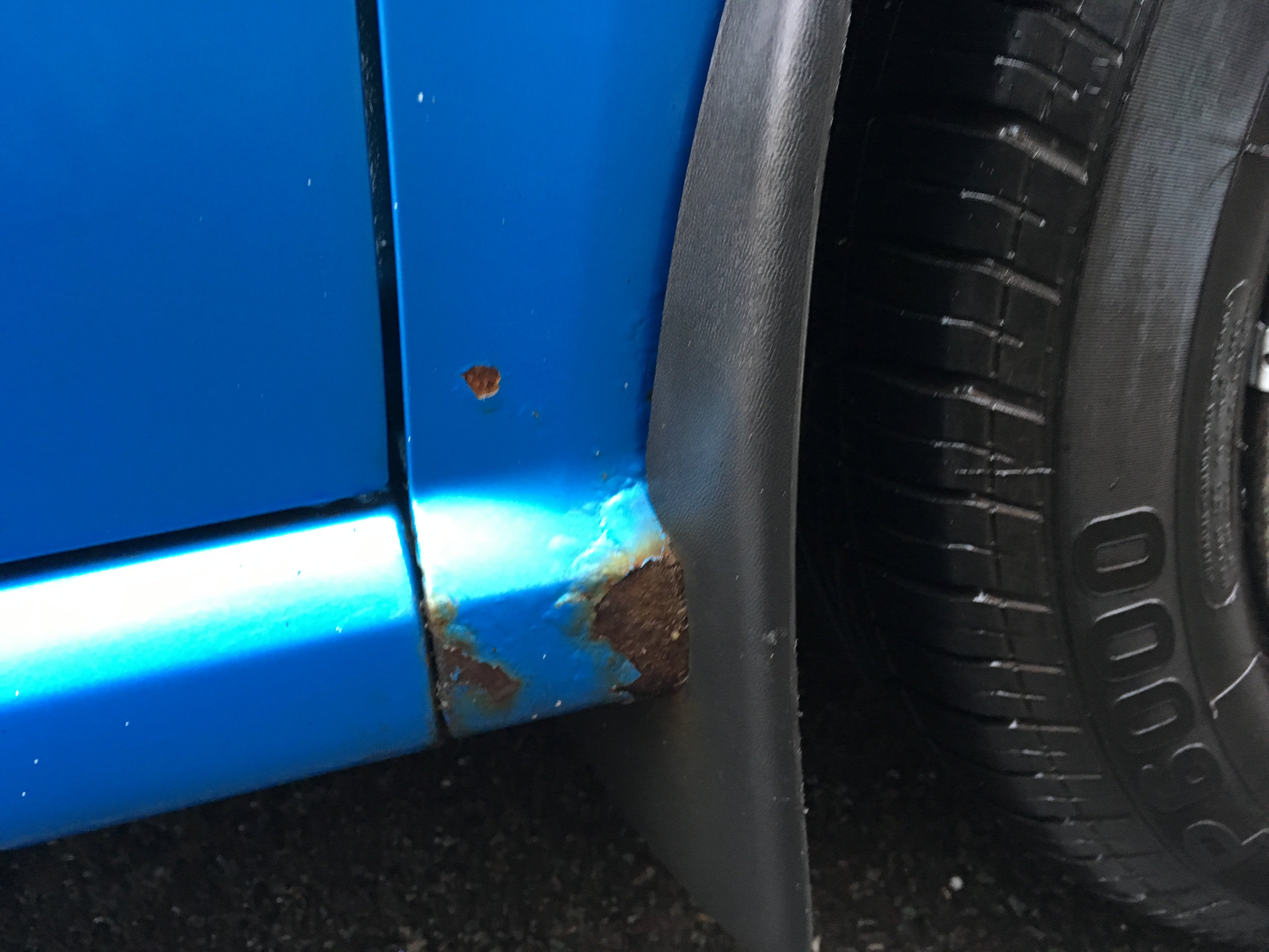

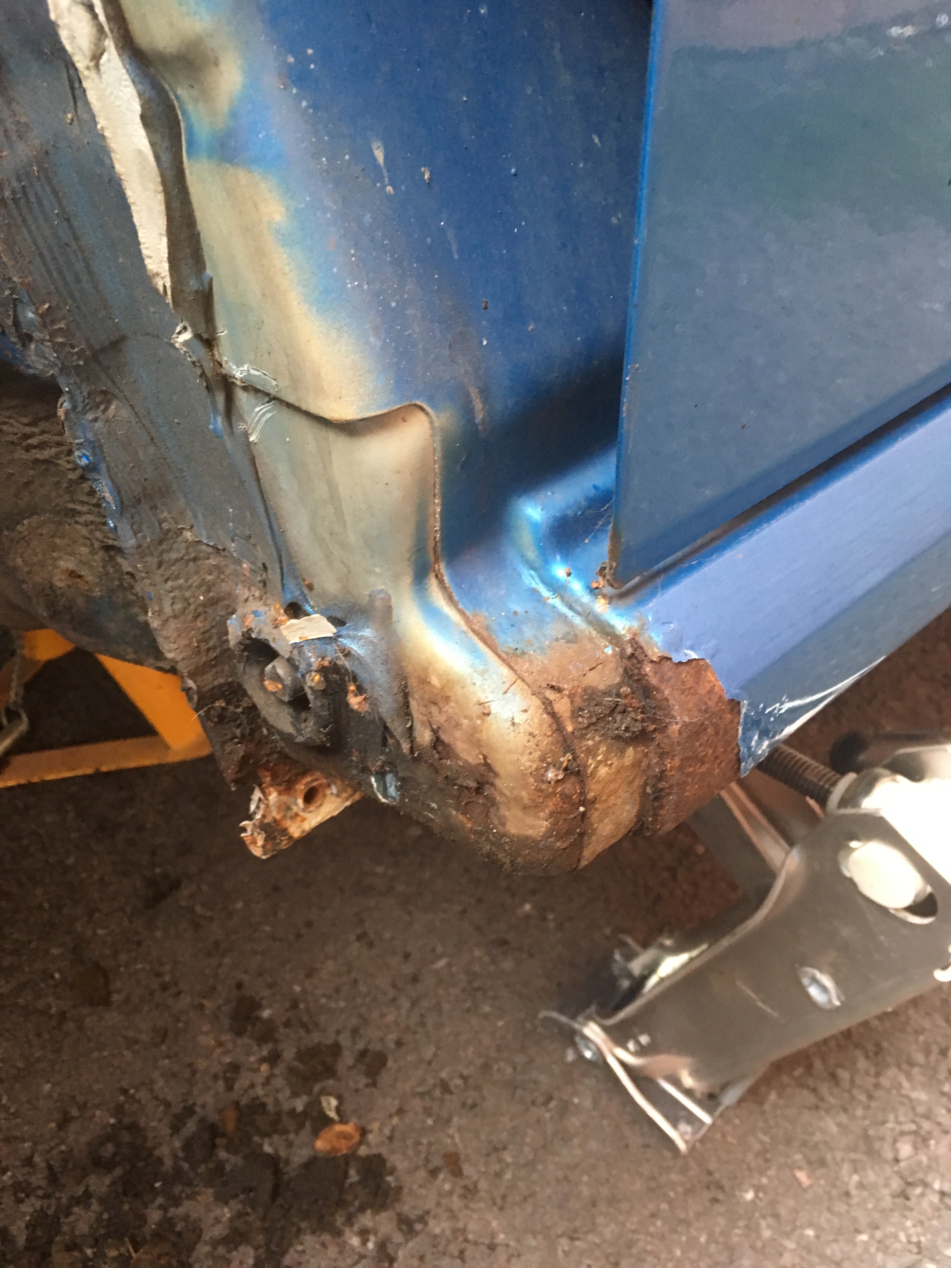

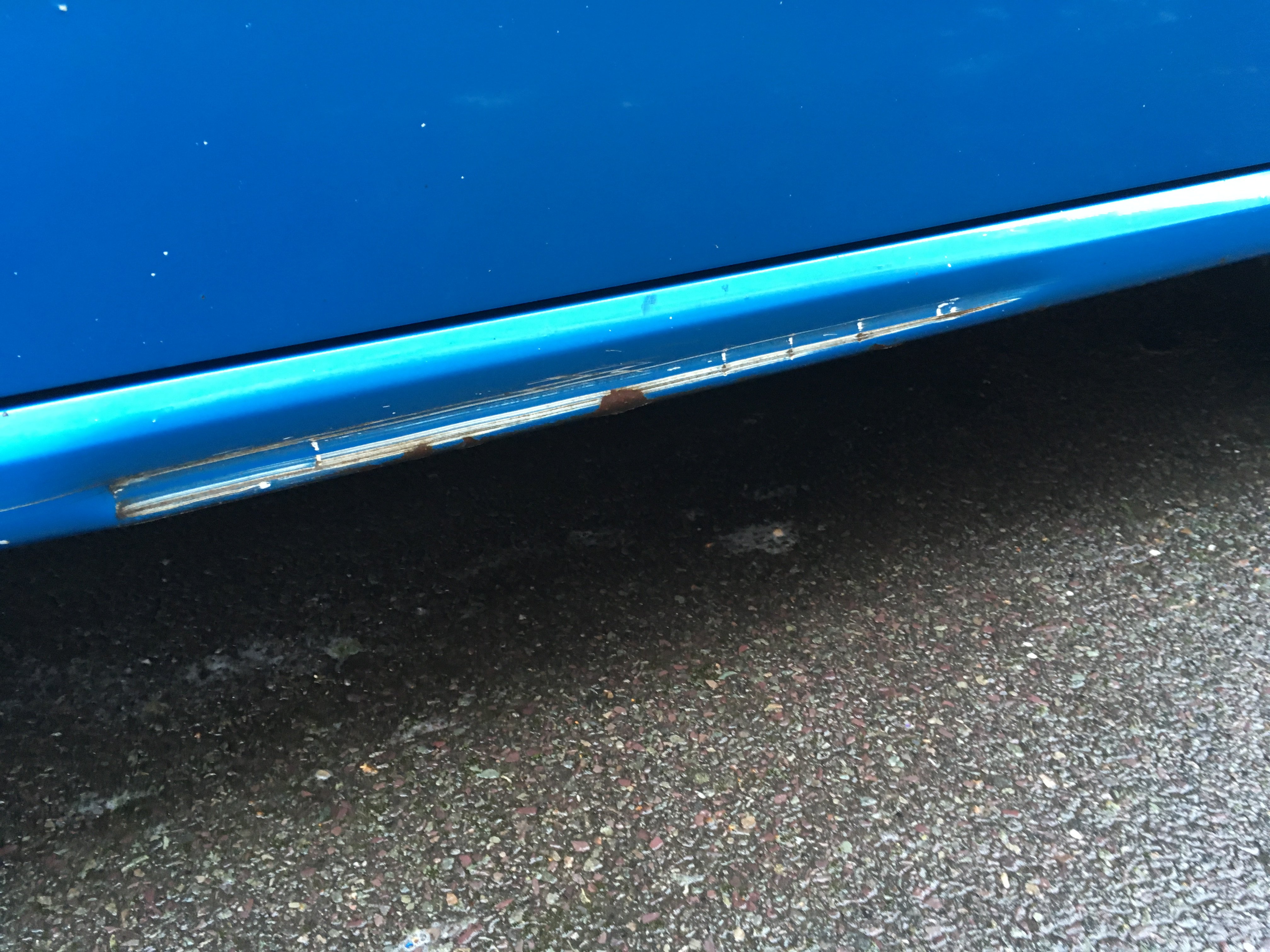

..although it is a bit flat and will need a polish out the shade is too far out..shame...and to top it all I thought i'd have a look at the cill rust...and that has the beginning of a hole too :-((

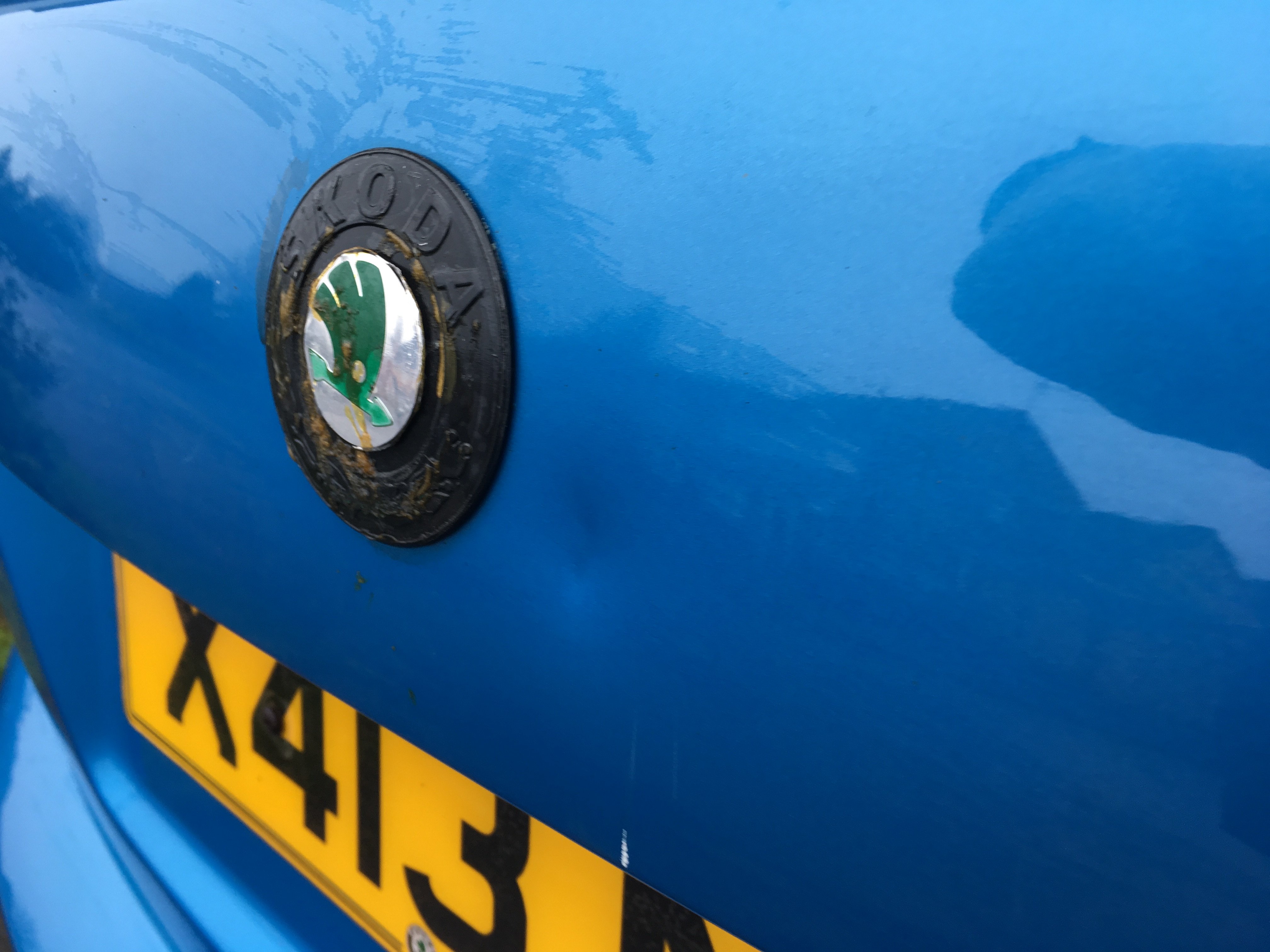

..Couldn't help it...had to finish tidying the other rusty bits and blowing in with paint to make the old girl a bit smarter!, and badges to boot!

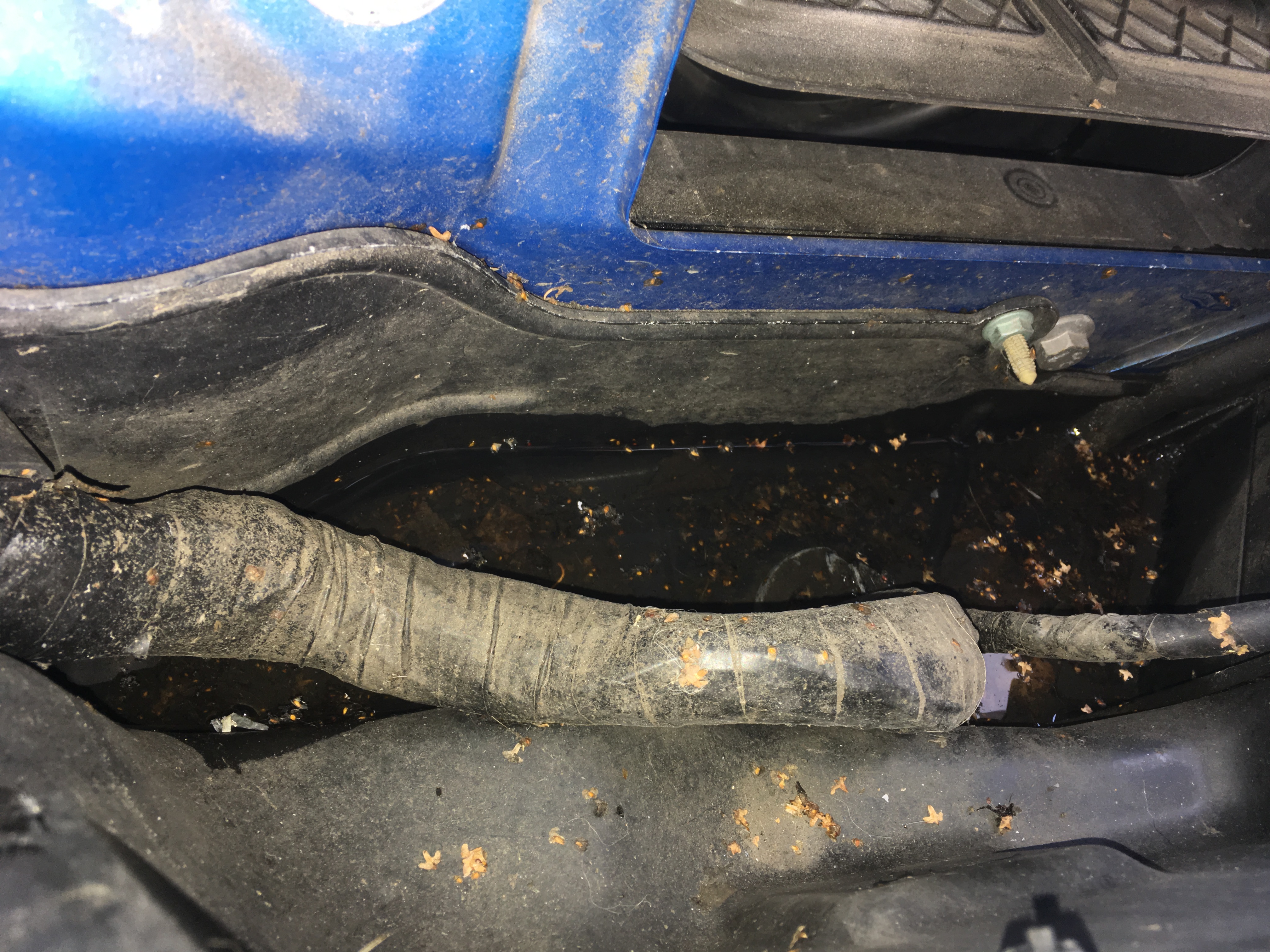

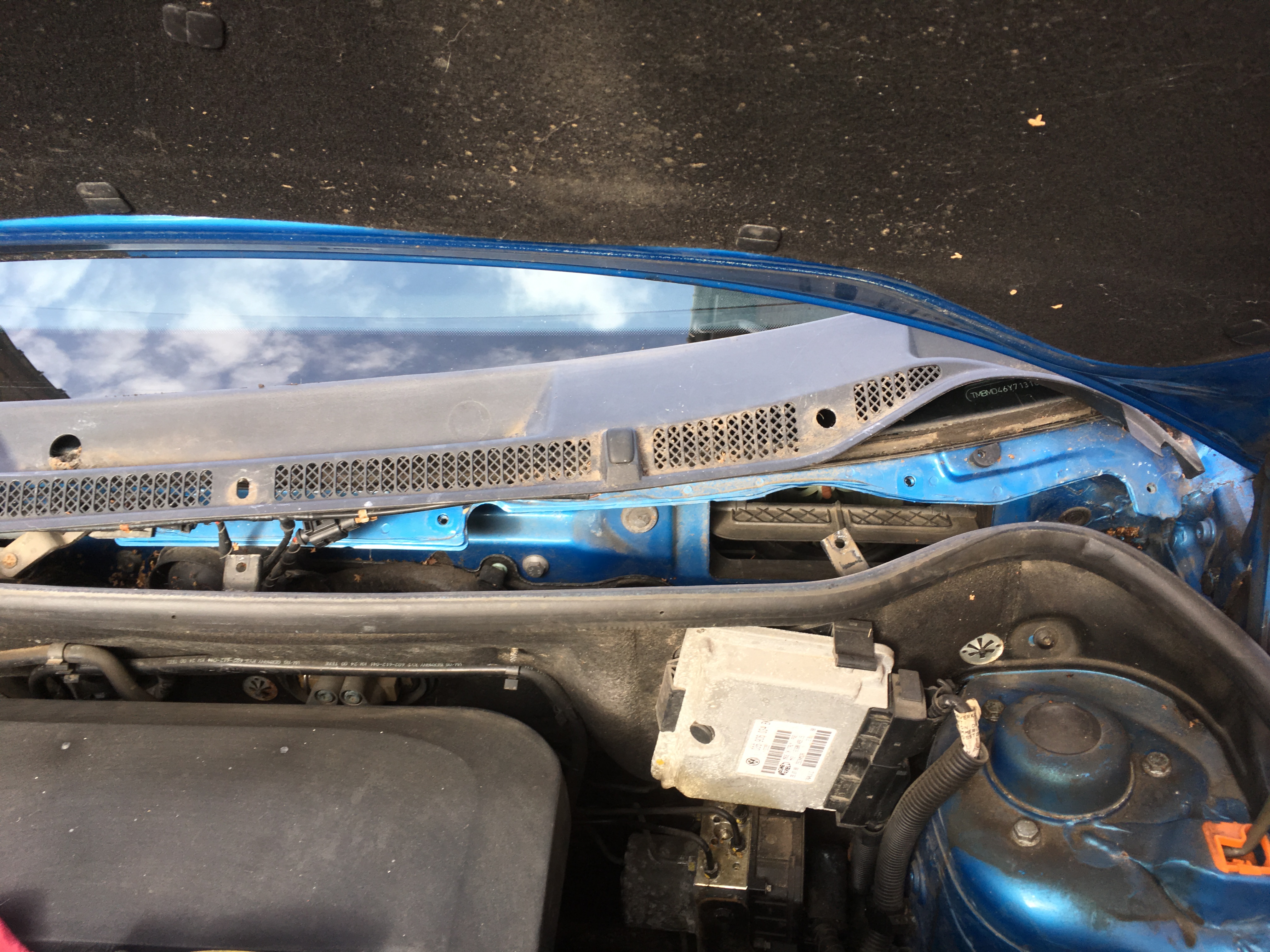

found the source of the water in my passenger footwell!...blocked drain pipe under windscreen scuttle panel!...was overflowing down the main loom entry!...now I know where the stagnant smell was coming from..soaked carpet!

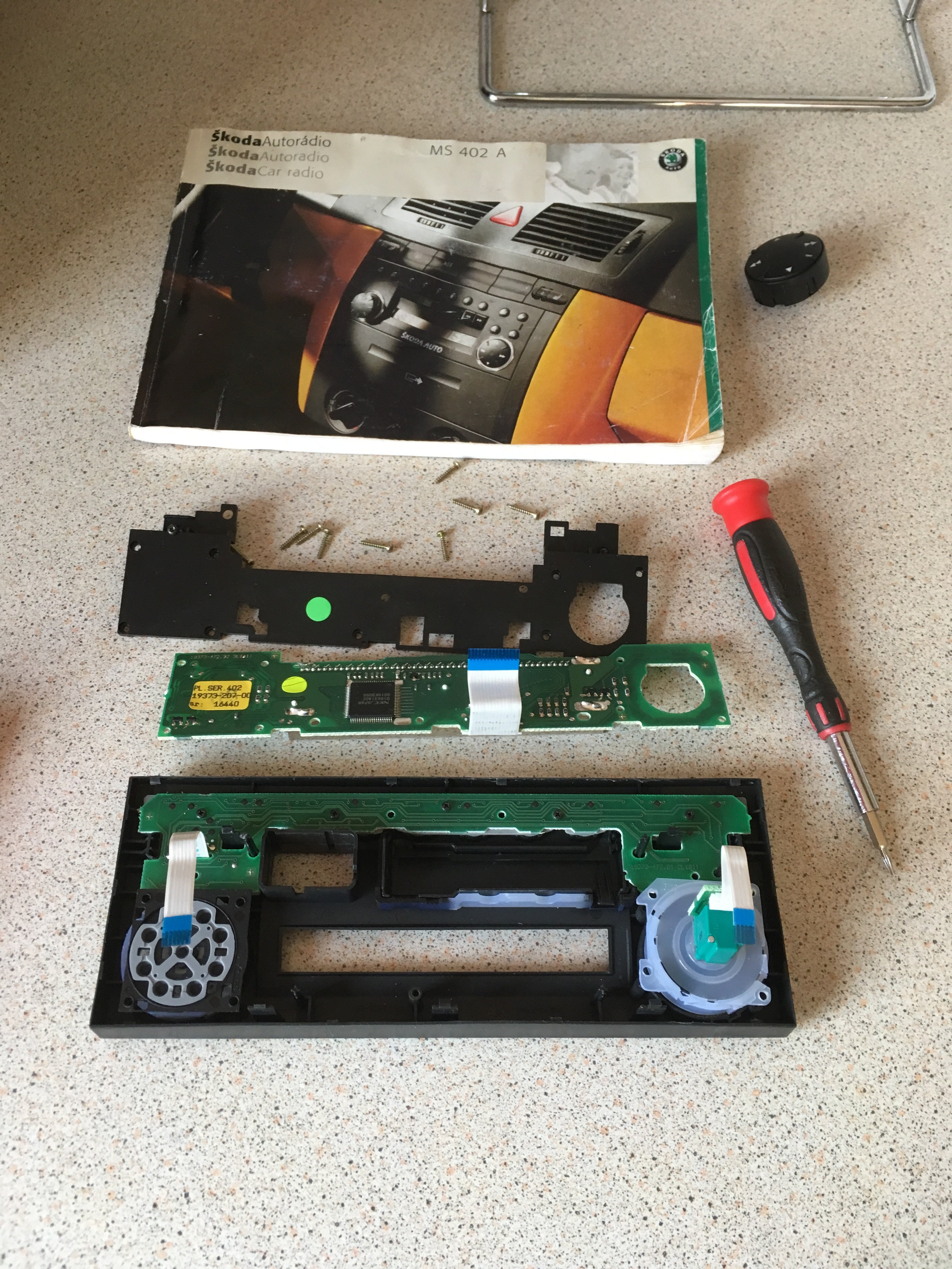

Stripped radio as buttons were not working...cleaned inner rubber and contacts and now working fine!....did I say this was not going to be a restoration/project?!!..can't help myself!
At least someone lined up the screw slots.
