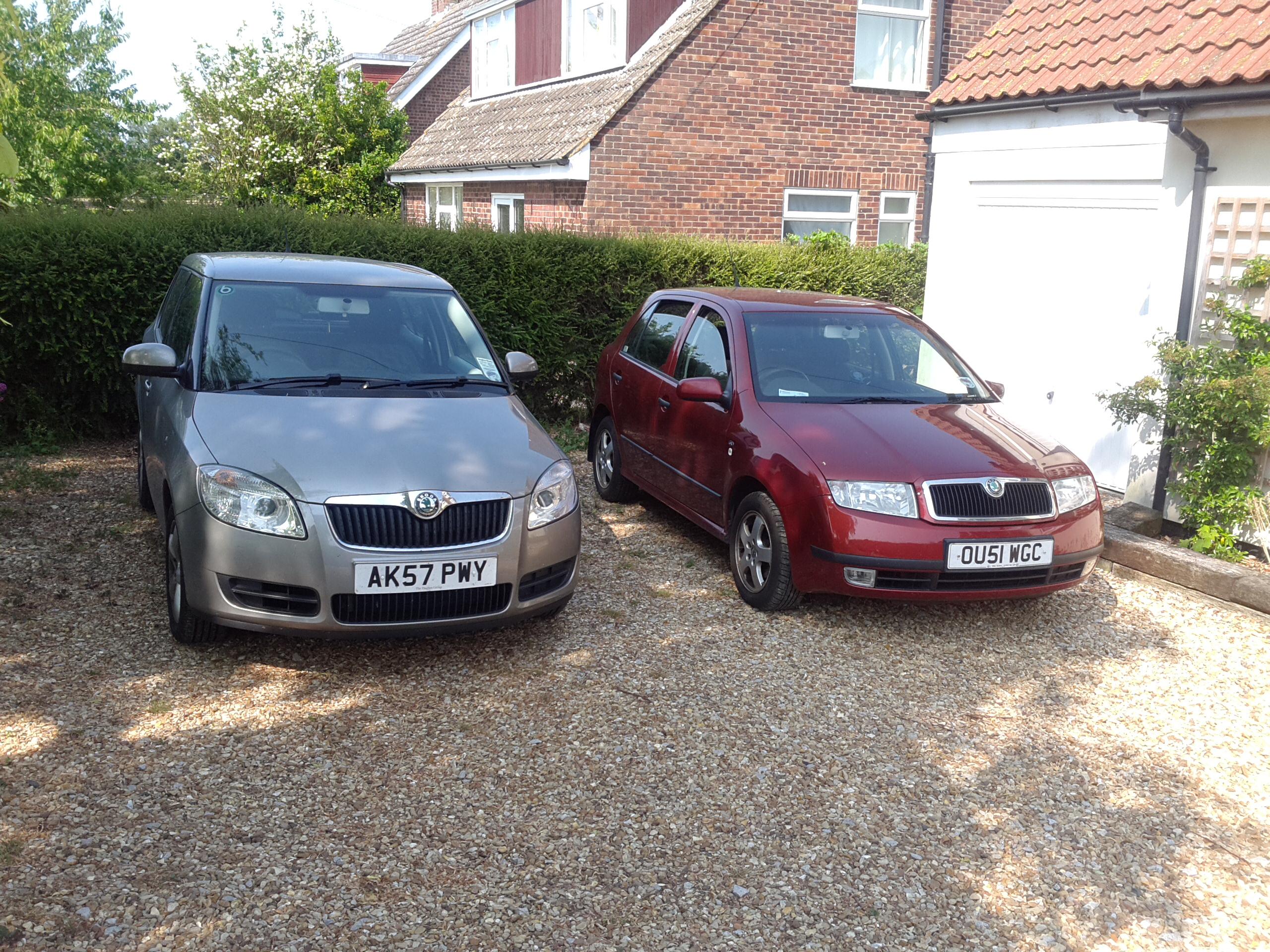

We had five Fabias in our family, so we loved them too - see my avatar, they're all there.
