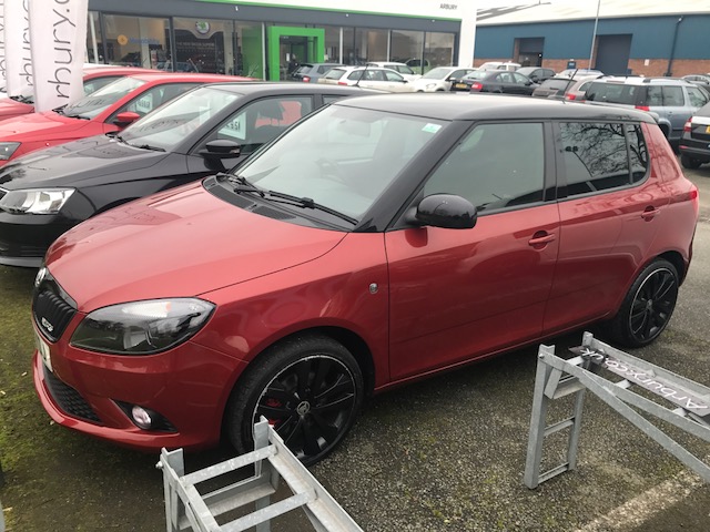

Hi all,
the 2014  fabia vRS I'm picking up next week has done 30k miles and has has just 2 services. One at 17k (inspection service) and one at 28k (oil change)
Am I right in that this car was on a variable service plan. What should the service intervals be? And what should be changed when?
I already have a copy of the service record with the vin number and above info but it doesn't tell me what has been changed.
the dealer (Skoda) where I'm buying are doing an MOT (1st one) on the car before I pick up too.
is there anything I should look out for?
Appart from the wheels and tyres which are being sorted I did have a good look around the engine bay - all looked clean and well without any signs of oil leaking anywhere. Bodywork looked fine.
thanks.
