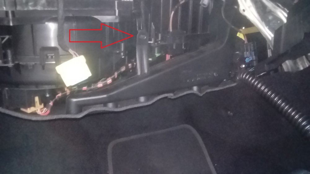

Once you've done all that, it'll look like this:
Undo the screw marked in the picture with the arrow and slide out the big, plastic footwell heating pipe you've just undone.

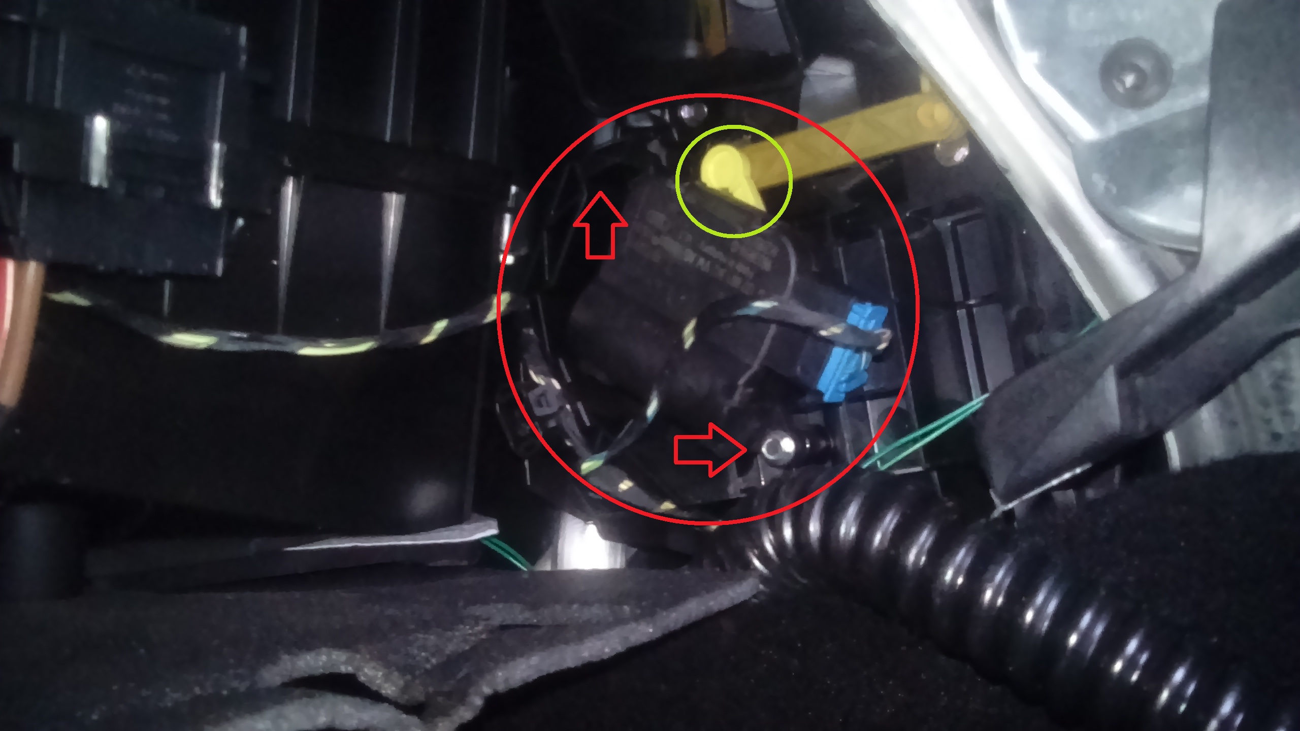

The motor you need to get out is here:

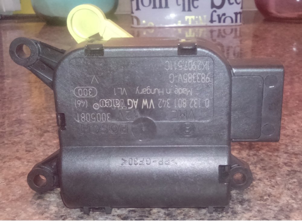

It's only held in with the one screw at the lower marked red arrow. Once this is off, carefully lever it up and... it's a bit difficult to describe this bit... wiggle the top bit around so that it unhooks. The motor actually looks like the below picture so you can see the bit you're trying to unhoop is the loop on the top left which is simply placed over a little nubbin to keep it in place once the first screw is securing the entire unit. (Don't worry about that third hole, it just pivots around in midair and isn't actually used)
The once you've got it off, sort of rotate the motor clockwise and eventually the yellow circular rotor arm bit will slide/pop off. There's a little plastic block built on to the rotor arm which has to line up roughly with the corresponding gap on the long darker yellow arm of the cabin flap it's attached to. When they're lined up, it'll simply come away. Bit backwards to say it, but once you see them apart it'll become obvious what you're trying to achieve when refitting. Undo the connector and remove.
