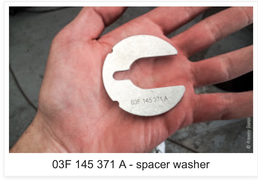

Also is the Shim not something to do with limp mode and goes between the wastegate and wer it mounts along with a reprogram of the ecu.
Edited by kmackmontecarlo
Well if it's that it doesn't fix the rattle, it fixed an issue with the light coming on and limp mode, the rattle I have is the same as the 2.0tsi and wer the rod is attaches to the wastegate rod the linkage rattles, the slightest amount of pressure on it stops it, the clip sits around the c clip and applies pressure without restricting movement. As I say I've been around the block with friends who work at skoda and with Vw within the group.

This was about a TPI on cars with a 1.2 tsi up to 2012.   Your car is a 2014.
Problem solved after 2012 wasn't rattle, but wastegate problem itself. It was solved by adding 2mm spacer under wastegate. I don't have any fault codes, just annoying rattle
