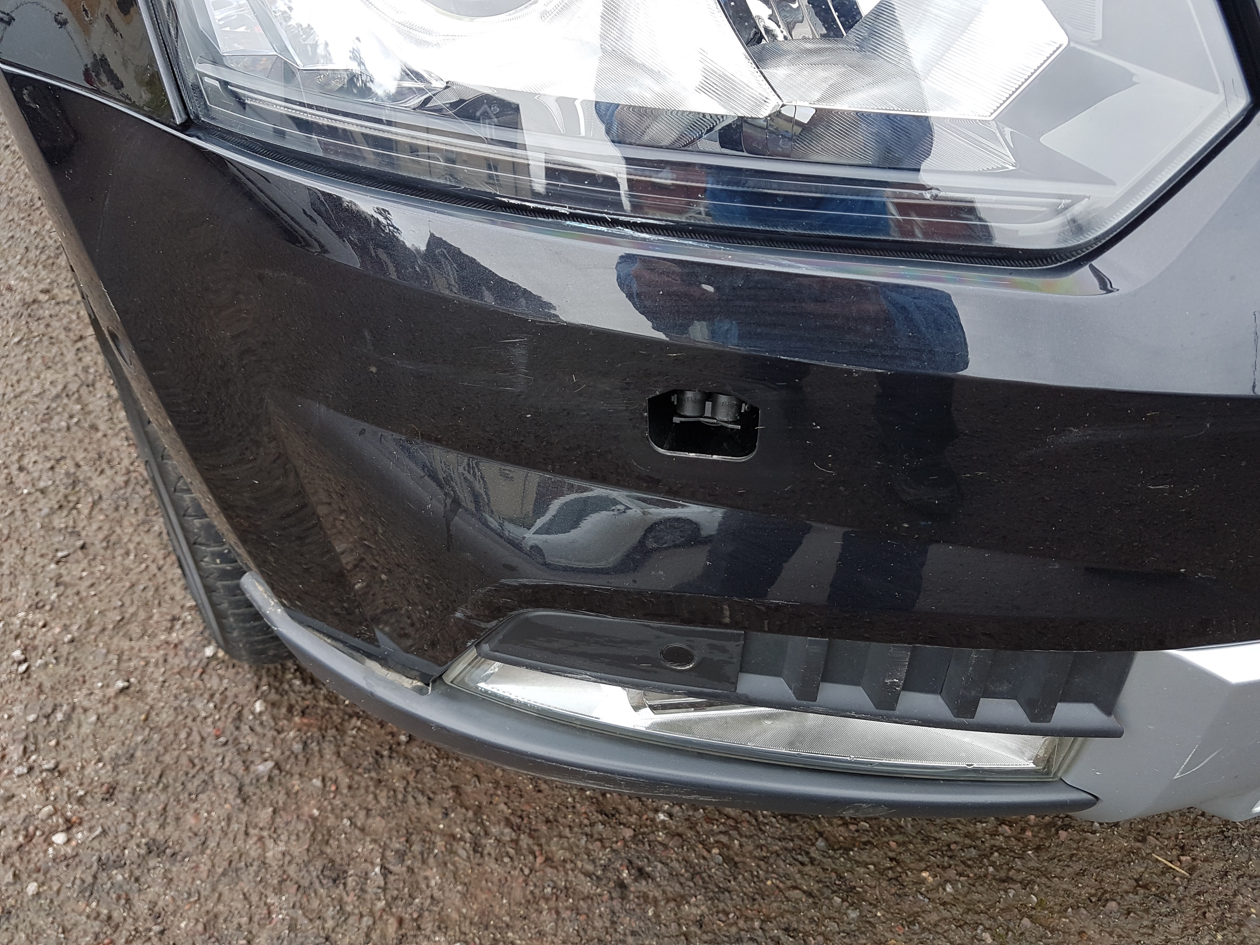

Someone bumped my parked L&K yeti last night and didn't tell me...not much damage to mine though, mostly blue paint to wipe off from the offending car.
However one item that is missing is this front blanking pate, does anyone know the part number or perhaps a link where I can order a new one?
Thanks

Sorry for stating the obvious ... but your local Skoda dealer is likely to be the best/quickest bet!
well yes...I would like to avoid taking a day out to drive to a dealer & show it in person...I was hoping for a part code and then I can order it via phone or buy it on eBay etc.....perhaps I'll just email the photo to a dealer if nobody on here can help.
If there's one on the other side,take that off and the part number may be on the reverse?
Is the cover part of the headlight washer unit?

Try 5L0955109

Is it one of the item 19s here?
Change date near the top to suit your car as necessary.
As Moley says, it looks like the headlight washer cover. If you have xenon headlights and they are turned on, for every few squirts of the windscreen washers, those 'covers' should pop out and water jets should squirt on the headlights. Do your headlight washers still work?
yep, I think the last three posts are spot on....I'll check if the washers still work tomorrow.  it's cold dark and raining out there now.
thanks.......this could be more expensive then I first thought!
£10.99 on ebay although that's with primer only so needs painting

23 minutes ago, MarieK said:
Try 5L0955109
Won't it end 110 (plus any suffix) as it's the right hand one?
Aye could be, I was just happy to find one...didnt pay attention to which side ;-)

3 minutes ago, michael99 said:
And there it is....thanks a bunch.....you lot are skoda wizards!
http://www.ebay.co.uk/itm/381737970606

64 plate 170bhp 4x4..Ebay says it fits..but I'll check with the sellers first.

The site I linked before suggests that the suffix-less part number is only right up to 2013, from 2014 it gets a C or a D depending on whether it's an 'outdoor' or 'city' model.
