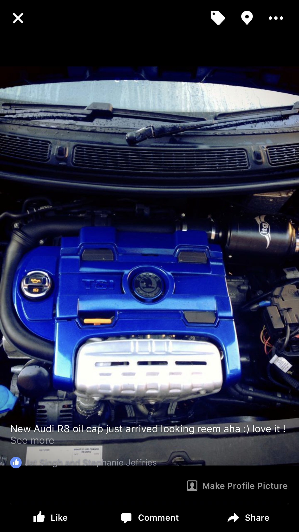

I've had my mk2 fabia for a while now and it's currently got itg induction and a map putting out 225bhp
I want more now! but will I get more by uprated intercooler and custom decat / exhaust system and custom map , as most of what I've seen have already done this and put out 215 ?
Mine me went on the roller
@189 out the factory
mapped with induction kit @225
Please advise ??
