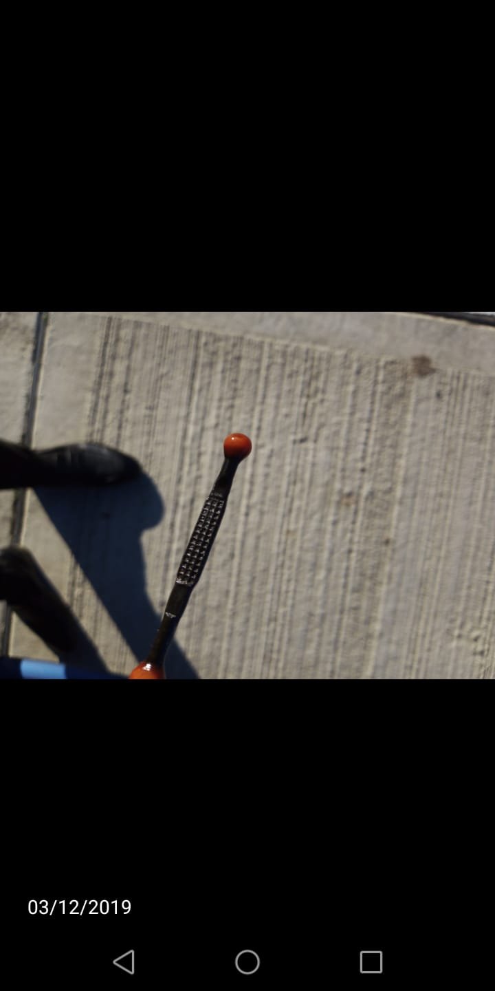

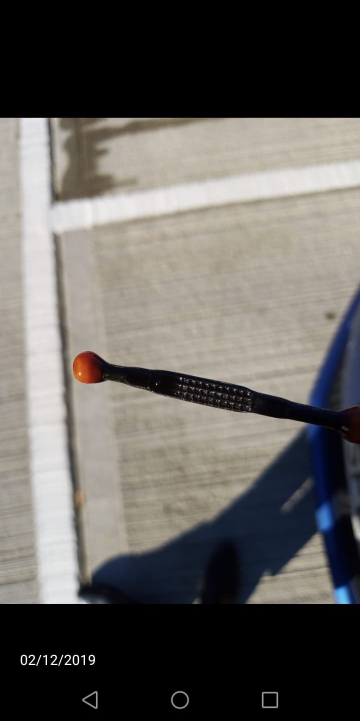

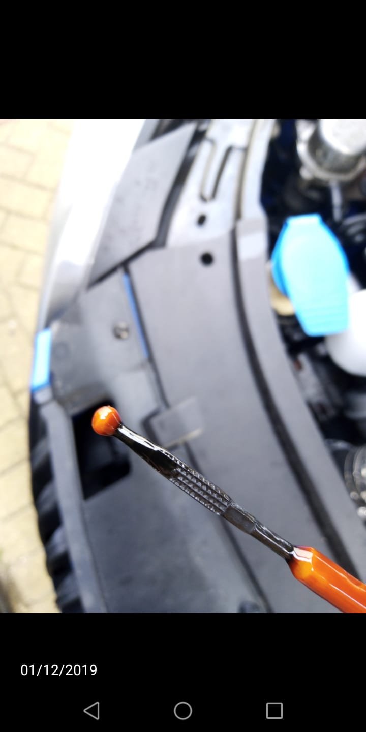

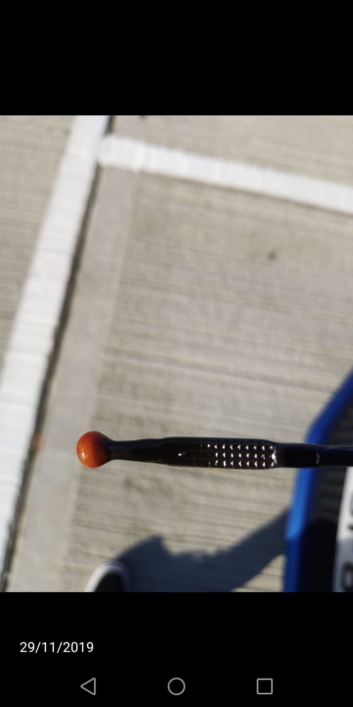

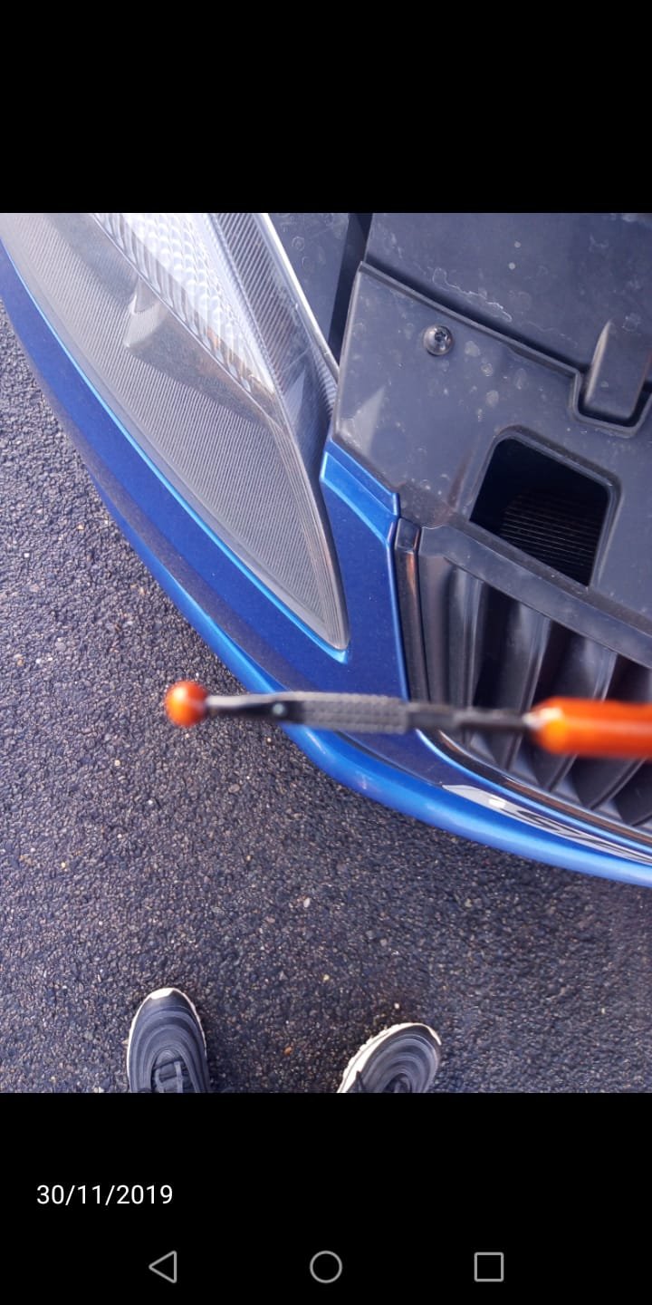

This prompted a panic driven daily oil check at lunchtime giving the engine enough time to cool down. I took pictures daily of the oil level (Pictures have time stamps) that shows the oil being consumed at this rate.

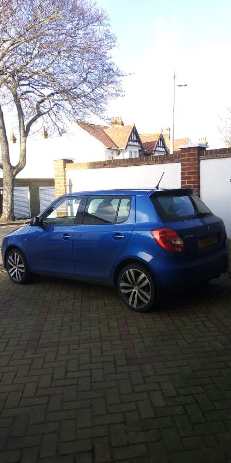

It was a lucky escape and Skoda are apparently going to try and either sell the car or send it to auction, so avoid of a Race Blue Skoda Fabia VRS with diamond cut alloys, 63 plate with around 64,000 miles!

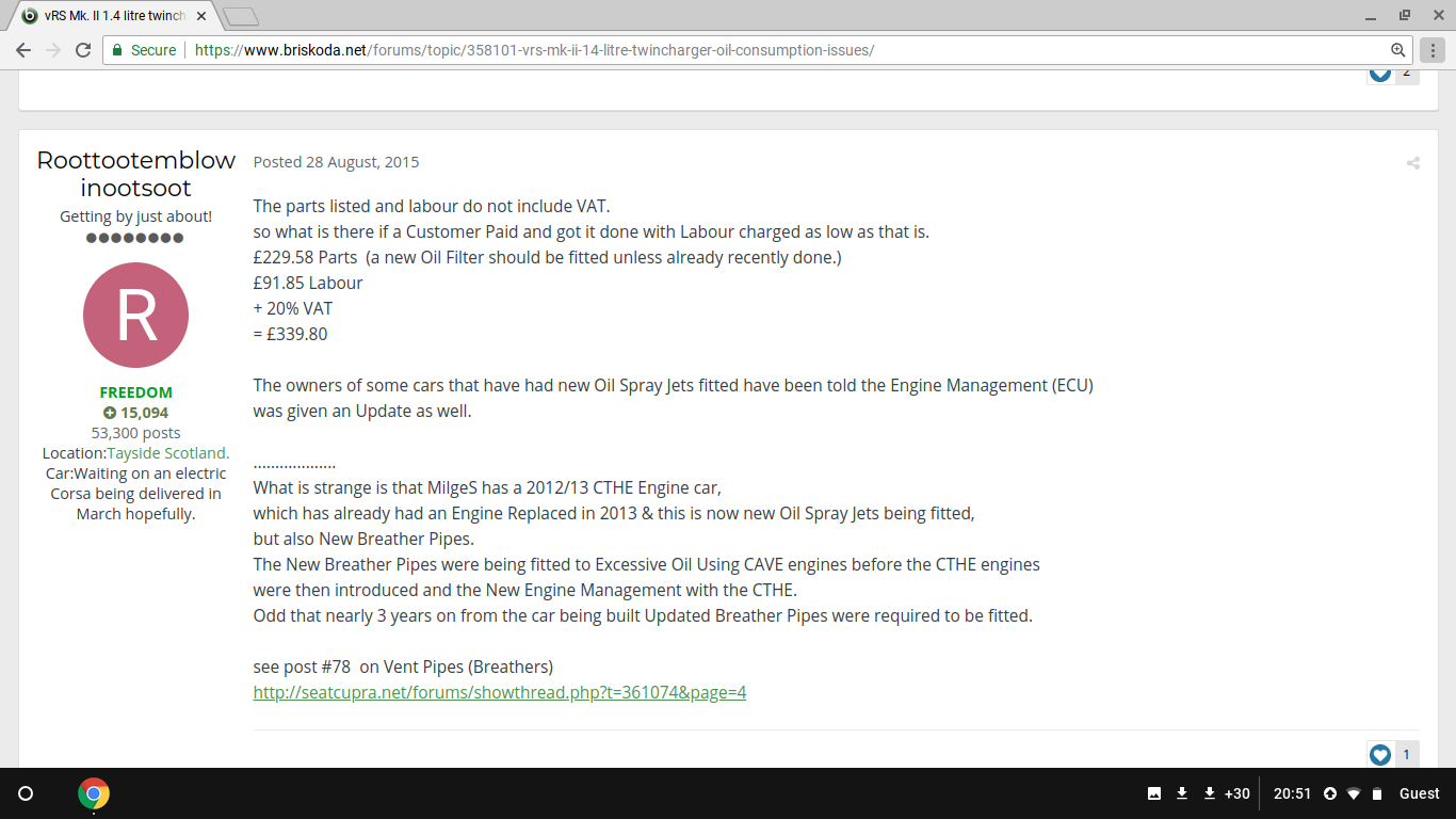

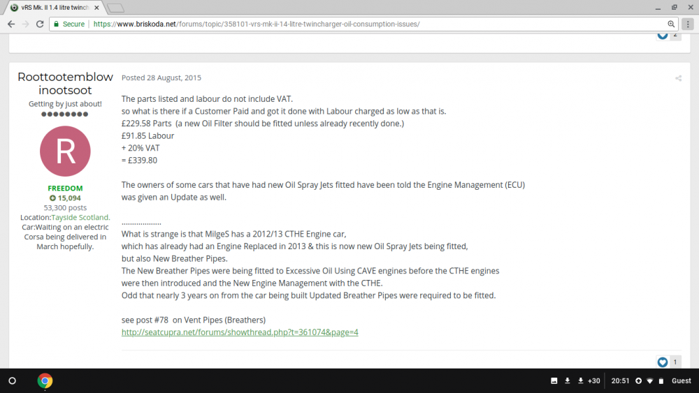

Well the first job was New Oil Spray Jets,
and the replacement engine was never going to be £10,000 fitted, or £6,500 not even £5,000.

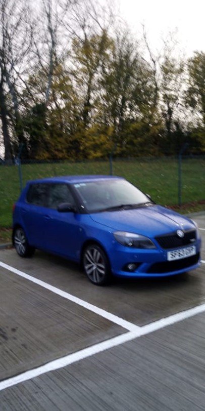

Could you please post what the Car Registration number is so that people do not have to try making it out?

The number plate was: SF63 GVP

I would normally say the first fix they would have tried would have been to fit the new uprated oil squirter's, The squirters alone come in at £700 before labour so the quote sounds off already however yours is the CTHE and should have the newer squirters, To me you've done the right thing as that cars about 2 melt valve or 2.
The other symptoms might not even be oil related its probably just a classic example of someone not looking after the car, The jolting under acceleration was probably the wrong plugs the garage stuck in the car as plugs for these are pretty specific.
In 3 months you lost £2700 of value on a car that was most likely sold to you ****ed, Personally I wouldn't have stood for it mate and demanded the money back or a car of the same value.

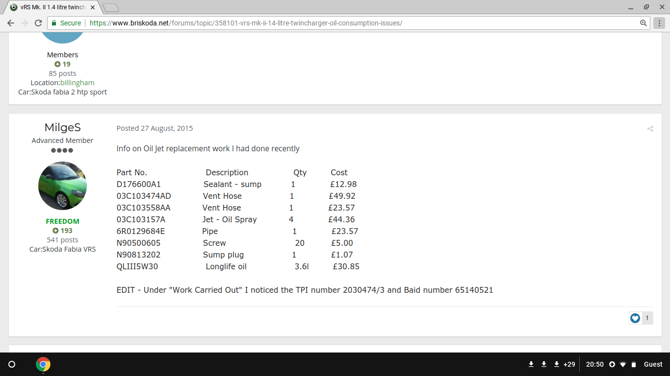

@MilgeS  had a CAVE engine car that was an oil user,
he replaced it with one of the first CTHE's out and it was an oil user & got a new engine and it used oil, it then got under warranty the Breather Mods, the Oil Spray Jets & the Software update carried out.
Just to correct the above, I started with one of the first CTHE engines and that was replaced with another CTHE engine that still burned oil, never had a CAVE engine.

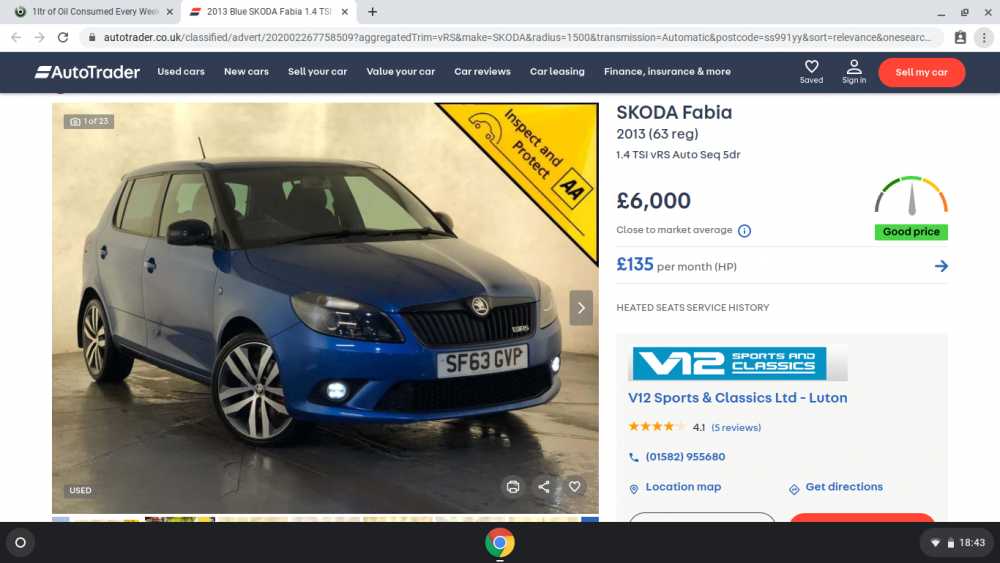

Did the car come with some sort of Warranty ?.  They must have know about it drinking oil,
AA Inspected and protected.  That will be chocolate.
It shows how little these protections can be.  Lets see if a next buyer gets an issues resolved.
