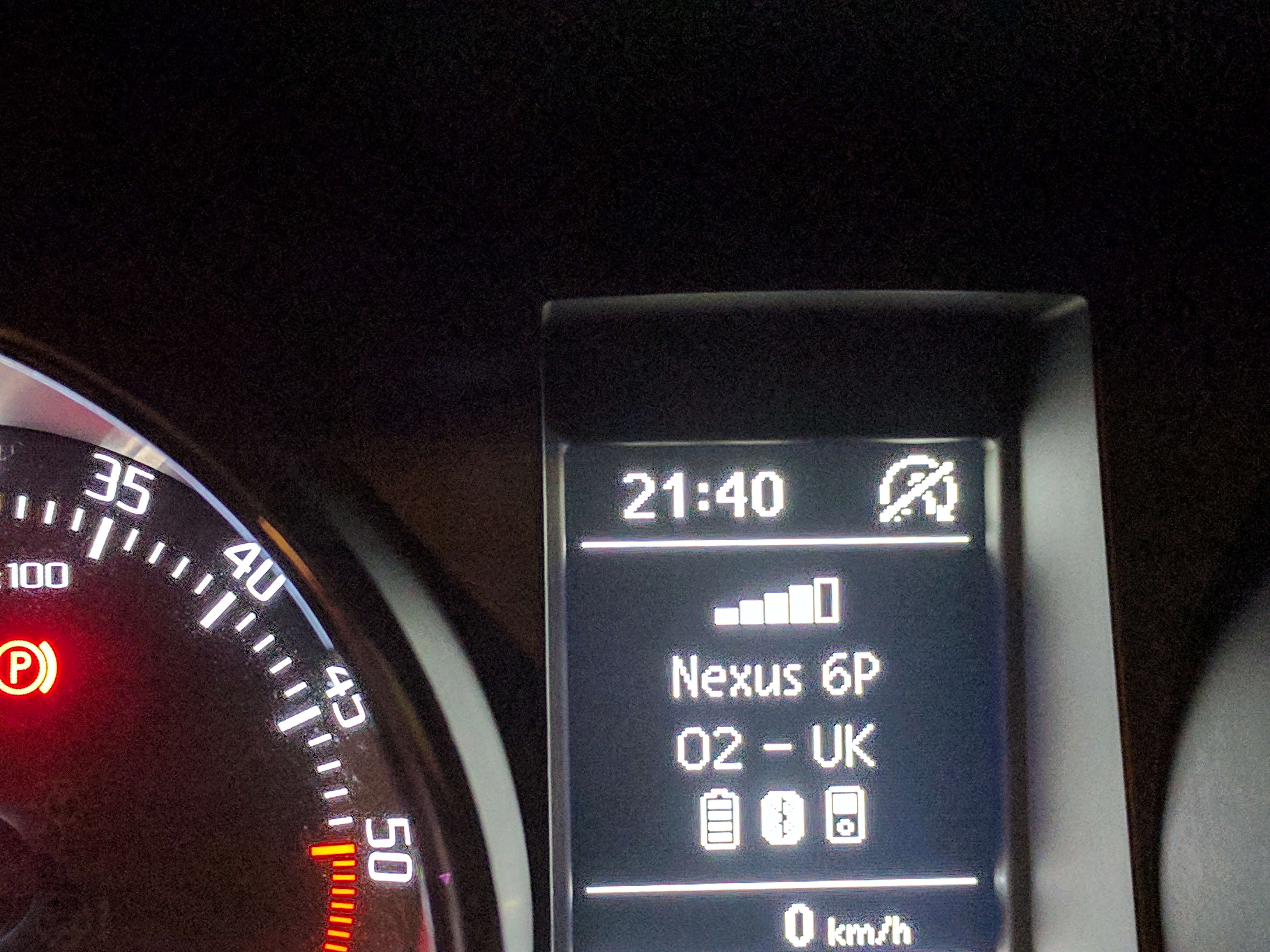

This is on the display?
That means start stop is not working. Mine does it if not warmed up or too much drawing power. It's for information... Not an error.
This is where the  button is on mine to switch it off. Bottom left.
Thanks I just went out switched it off then turned off the ignition. All back to no error message.
Thanks Mate
The symbol in your picture is just telling you that start/stop is not activated. Either because you have pressed the off button (which needs to be done each time you start the car) or there are too many things being used for it to activate.
Basically just get in and drive and the start/stop will manage itself. If you want to deactivate it at anytime, it can get annoying in certain traffic situations especially with a dsg, then press the off button. When you next switch the car on other will be  back in auto mode.
