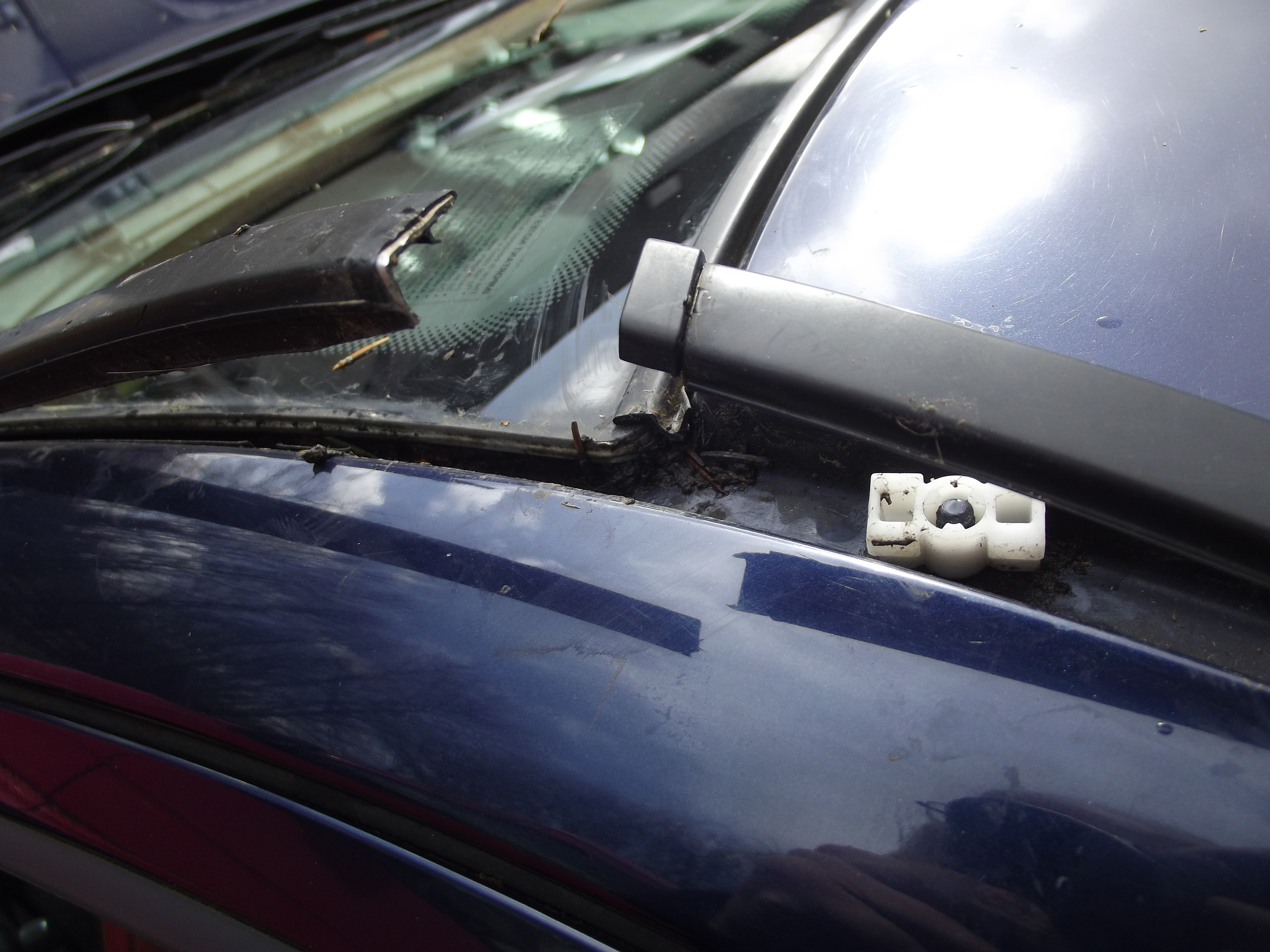

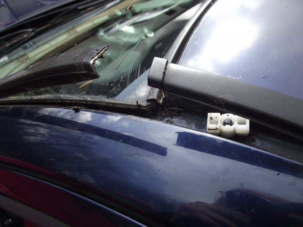

Just tooh a screwdriver to the car, dropped the front of the headliner etc, couldn't make out a thing... Popped the trim off the exterior of the side of the windscreen and the first two clip of the front to back roof trim. Cleaned all the gunge out from around the top cornet of the screen, as I was doing it I could see the screen flex a bit at the corner, so failed bond at the top corner, plain and simple. Will stick some bond in as soon as it's dry. If I've got it right there shoul;d be a photo showing exterior trims pryed up...

I've had a similar problem. It seemed to be where the factory went around the frame before sticking the screen in - and did't get the join quite complete. Looks like the original windscreen.

I put silicone around windshied corner and two holes for roof mounts - still got a leak when raining. It's very localized unlike my previous octavia where moisture would spread up to my head. I was lucky to have a neighbour fix his roof liner and took a deeper look at the exact spot where I have a leak and cannot deduct anything smart except that I think the water is going through the rubber seal and then concentrating on the spot where I have the leak. I also believe this leak develops only when car is stationary on rain, during driving it doesn't leak (I have a garage so most of the time it doesn't see the elements).
See pictures below, if someone can point me where to seal it again before I take down the roof liner...
