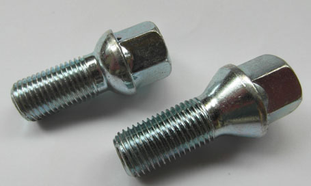

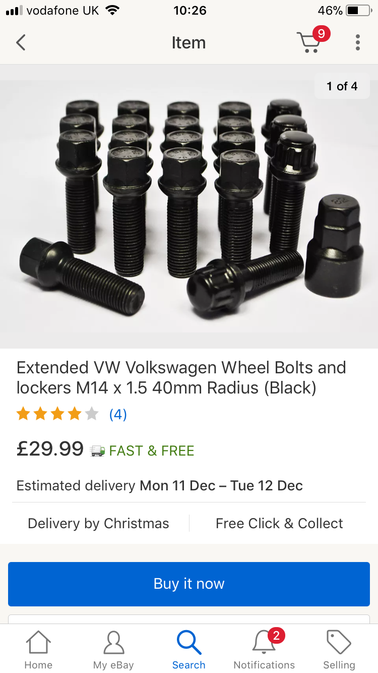

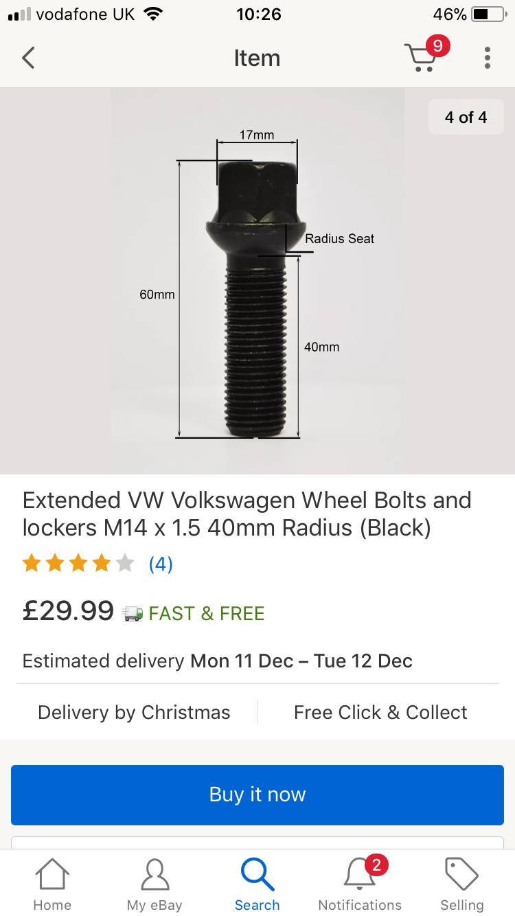

you got a pic of what you mean so I know what I’m getting is correct
These?

Ah that’s it !!! radius seat, couldn’t think of the exact name.
too on on the attached pic. H&R do the extended bolts and lockers and they are top quality tbh
Radius or tapered for the bolts? As it’s asking when I go to order

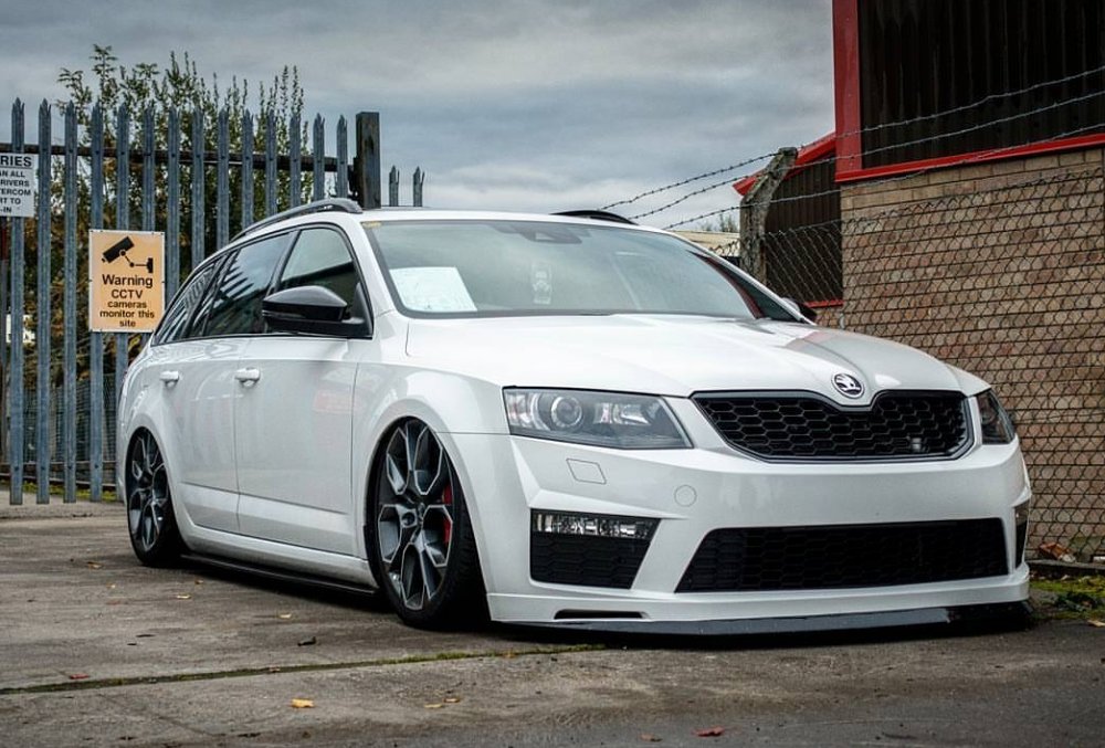

I've lowered mine :D

haha show off B), love the stance! how low can it be driven on the flat?

Sorry not sorry on the m1/flat I run it with the top of the alloy about 10mm away from the arch so you can't see the tyre
Radius if you have the standard 18” or 19” rims on. Gemini’s, pictoris or xtremes
Like it, see you have smoothed your front reg bit also nice touch.
Got it a boy going to do me front spacer 10mm , rear spacers 15mm with all 40mm bolts and locking nuts for £180 delivered. Pretty good price I thought . That’s all H&R stuff
Hey Ant Vrs I see you changed grille to honeycomb one. I did same on my vrs, after a hit and run damage my OEM. Did you fill in the areaso that horns are not seen like OEM grille?
Yeah I've moved them to behind the crash bar so they can't be seen now. It makes it look a lot cleaner
