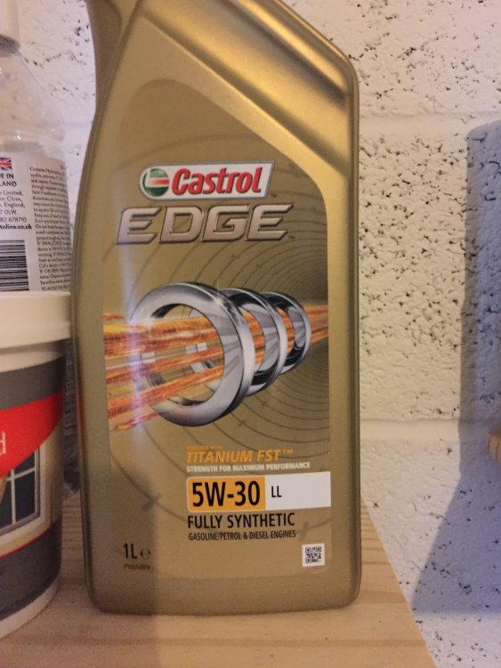

Hi I carried the oil below in my Passat 2.0tdi 140bhp would it be ok in my black edition which I guess is the same engine?
Simple answer, yes.
Skoda specify oil to VW spec 504 00 / 507 00 5W-30 for this engine and that will be mentioned on the reverse of the bottle.

Much appreciated thanks
That oil is 504 00/507 00 approved, so it's spot on.
Strictly speaking you can get 504 00/507 00 in 0W-30 too, but it isn't common.
