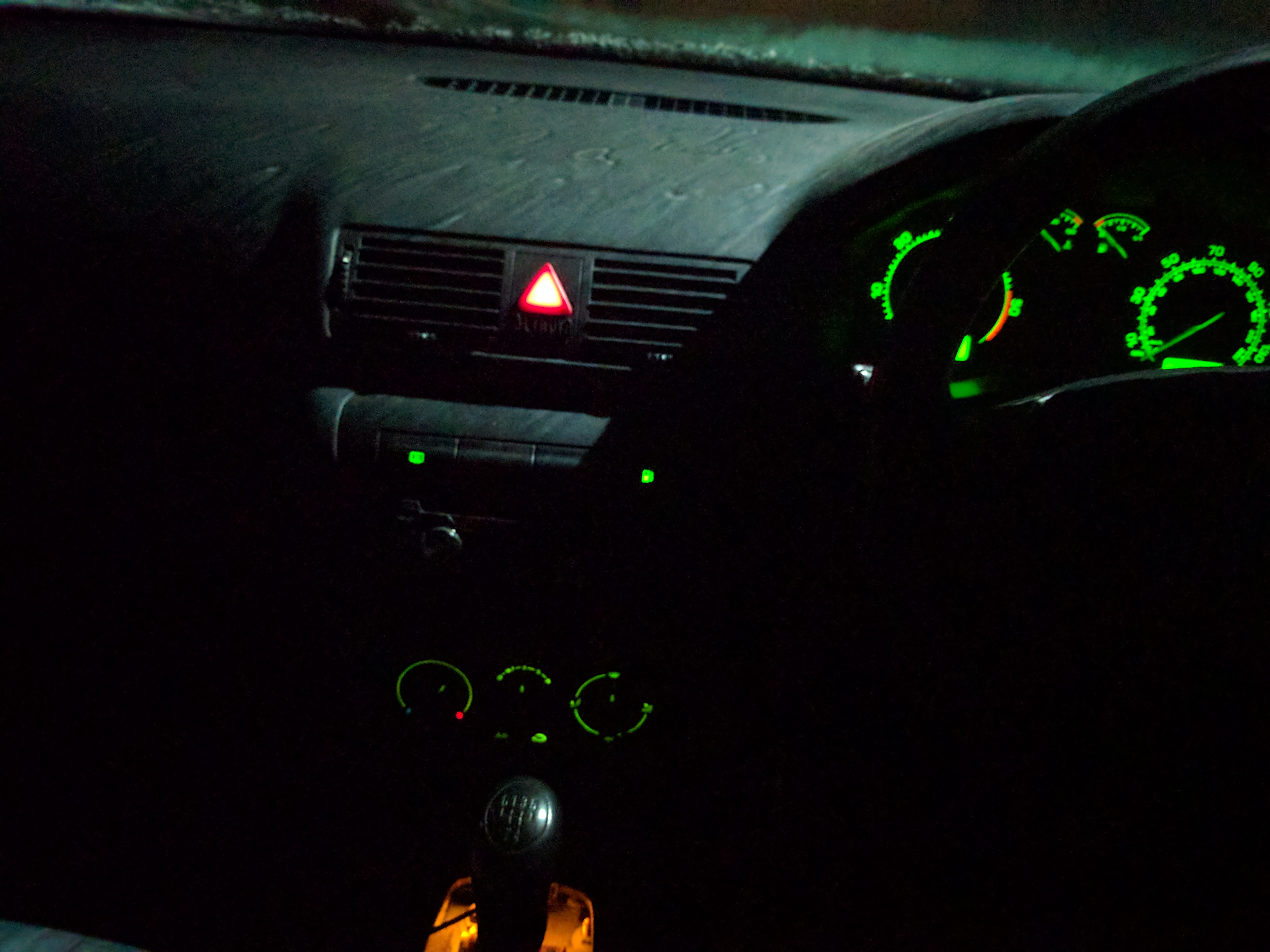

Might be a quick and simple one here. The panel containing the three heater control knobs, including the A/C button and recirculate button does not light up when I put my sidelights on. All the other interior things (mirror switch, window buttons etc) work but not this one, which is annoying. My car does have some weird electrical niggles, such as boot lights not coming on, only a couple of doors triggering the interior light etc. The little light which illuminates the ashtray works, too, so there is just a gap of one 'panel'.
There's a photo of what I mean here to illustrate - http://imgur.com/a/vfD53
Any advice on how to get to the bulb, if possible, would be great!

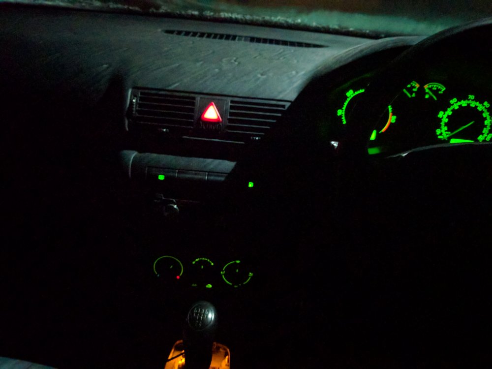

I managed, thanks! I've attached a photo (or attempted to)
Quite faint but good enough to see what you're doing :)
