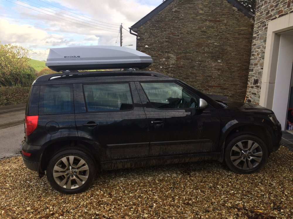

A photo of our Exodus 470 roof box on our Yeti. It's a full width box but fits the car well if you replace the long aerial with a stubby!
And another!
That's very helpful, thanks.
I think the 1.9m box is as big as I'll go for.

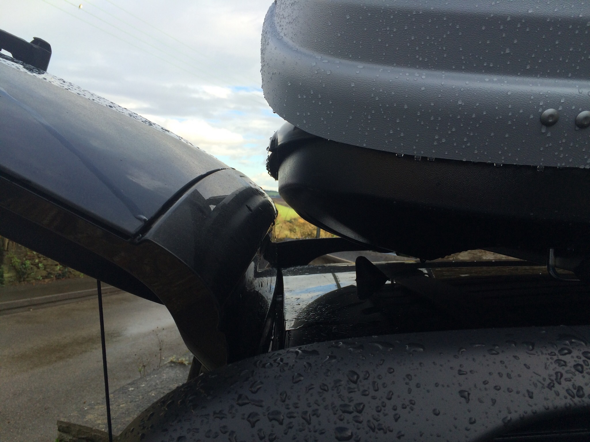

I have this roof box - it's a lovely bit of kit, but it does press on the aerial and I also have to be careful not to let the boot fully open:
Slightly unrelated but hopefully useful info especially if you've got long loads/boxes. I have whispbars on my Yeti which IMHO look great compared to the standard Skoda jacked up bars, HOWEVER be aware, as has been pointed out here, with similar aftermarket bars, you can't open the hatch with a long load on the roof. According to a colleague of mine who runs the Skoda bars, as they're raised they allow the hatch to open as norrmal to clear long loads! I never realised that when I bought mine -good job I rarely need them! Even with Skoda bars, if your roofbox has recesses for the bars to sit in, it'll lower the box enough to interfere with the hatch operation. Something to bear in mind though.
